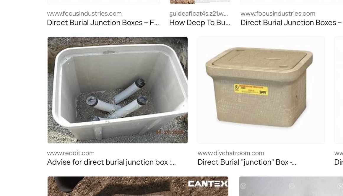

Well, ive done underground splices for over 30 years….never had a call back. Even the utility companies here do them, no issues.
My feeder in Washington has been spliced several times by PSE
As for in ground concrete boxes with splices all one needs to do is go to any of the older shopping centers here and each pole in the parking lot has one.
The biggest problem is copper thieves accessing and steeling the wire... happened to me.
