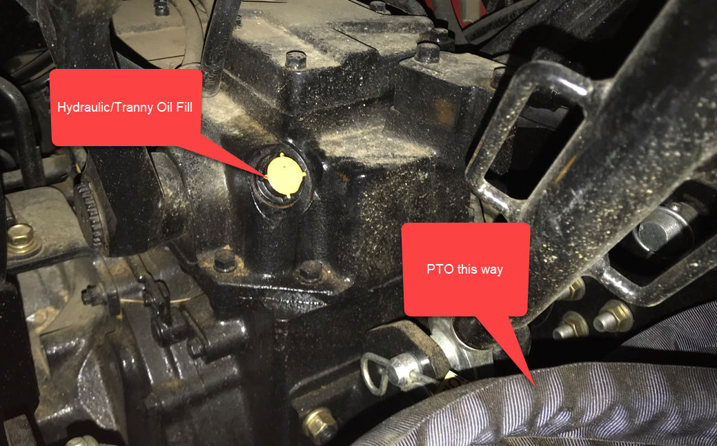

Does the PTO Fluid sight glass and filler location apply to the 3-Point Hitch ?
My 2014 Max28, I had it for 5 years, has been a great tractor, a little less power than I expected but I work around that.
I decided to use the 60" Brush Cutter, took off the Grader Land Plane, no problems, Hitch went up, down and up again.
I hooked up the Brush Cutter with the help of the Hitch, small moves, got everything pinned in place, went to lift the Brush Cutter and nothing... would not lift, I couldn't get the Cutter off the blocks I store it on.
I was low on trans fluid, added that, no change.
I didn't know about the rear sight glass will check that out.
Any suggestions, please post, any ideas what happened ?
