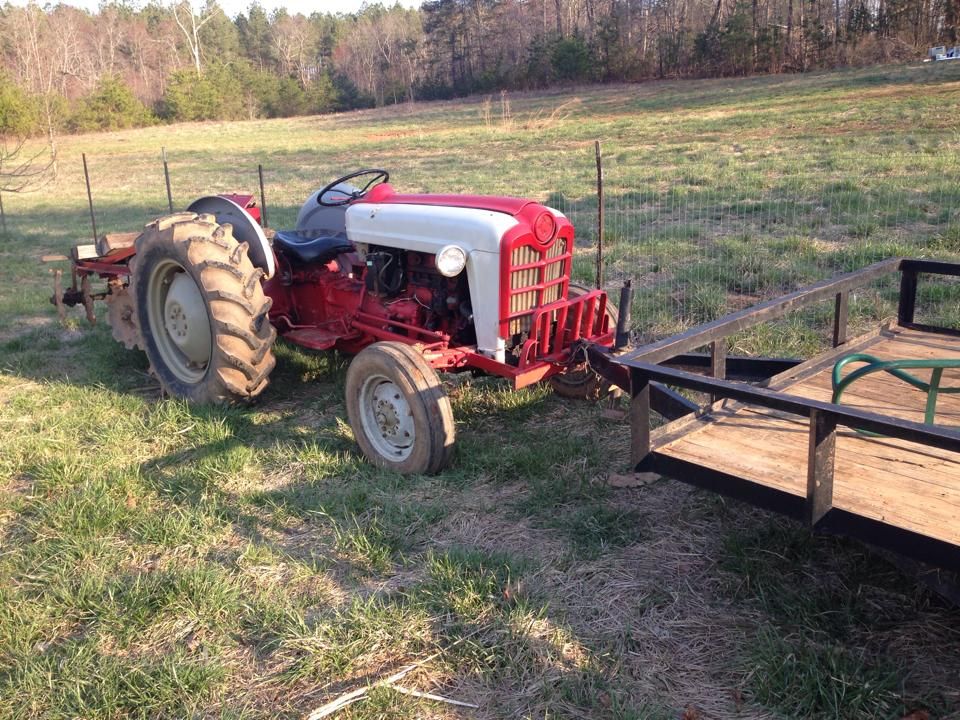

851 powermaster.jpgBought an 851 Ford powermaster over the weekend, my first tractor. All seems well at present, needs new lift arms851 powermaster.jpg soon, need to buy a tarp until I build a shed, and Oil is black, so gonna change the oil this weekend when done with work. I would like to find a cheap maintenance manual, even if a PDF download. Does anyone have experience with this tractor. I am a newby and I want to keep the baby gently working for as long as possible.
I cleared my 11 acres, and was weighing hiring the grading and root raking out and then bush-hogging later vs. getting my own. Got this tractor, a new bush hog and a scrape blade for less than 3 grand. It seems sound, don't want to run it long with the black oil. Any mentors would be appreciated.

Look on e-bay, search "ford 851 Manual" I found a bunch. It's a close cousin to a NAA and other ford tractors of that age. For your arms look to places like Steiner tractor. Don't abuse or overload it, Keep the fluids changed, Keep your gas clean and treat it when the tractor will be sitting and tune it up occasionally (points and plugs) and it will last a very long time. Good choice for a first tractor. Oh yeah, wash and wax it occasionally.:) One more thing. If you plan to pull anything with a regular hitch (like that trailer) consider buying a proper drawbar (one that bolts the back of the tractor). The bar you can get that goes on the three point can be very dangerous.

Oil drain will be bottom of the engine oil pan. It should be fairly obvious. I don't know exactly on that tractor.

Yeah OTF, I went out to my property at lunch time, a **** blind man could find that drain plug! Thanks!

You should change the trans fluid,diff fluid and hyraulic fluid too. Three plugs under the tractor (smaller than the oil plug). Front one is transmission, middle one is hydraulics and rear one is differential. The seals between the sections often leak, so it's frequently best to just buy UTF and use it for all sections.
The hydraulic fluid in the middle section goes through steel pipes in the transmission. Water in the fluid rusts those pipes and the trans overflows. It's probably smart (but a messy job) to take off the manifold from the hydraulic pump to the transmission and clean the tubes with a gun brush and swabs to get the crud out. And they ALL have crud in them that wears out the hydraulic pump.
Also, the shift "plungers" wear. They are replaced externally and are pretty cheap. (40-50 bucks total) Replacement takes about 10-15 min.

Capacities (by the book) are as follows:
Cooling System - 15 qts
Engine Oil (with filter change) - 5 qts (remember the air cleaner as SouNdguy said).
Tranny - 4 speed - 6 1/2 qts
Hydraulic Reservoir - 9 qts
Diffy - 11 1/2 qts
You undoubtedly have 50 hours or more :). I'm on a 500 hour / 3 year schedule for those fluids and 100 hours for engine oil. Typically, water infiltration is the biggest issue. Since you store the machine outdoors, you may want to find a way to cover up the exhaust pipe, shift lever, etc. I use a coffee can on the exh stack over the top of the flapper. On the 5 speed, there isn't a boot on the shift lever like a 4 speed, but you may still want to get a tarp on it.

i'd dump in some atf and diesel and alcohol into the diffy, trans and hyds sump and then use that as the flush..
diffy drain is the pipe plug in the rear.. next drain up is the hyds, next one up nearest oil pan is trans.
figure on about 7g utf to do the entire thing.
also check to make sure there is no thrust play in the pto shaft.. and check lube and play in the steering box.
what's wrong witht he rear lift arms that they need to be replaced?
also do the rad fluid. green coolant is fine... if it still has a genny it needs a drop of oil under the oiler cap.. same with dizzy.
plugs are al 437 gap at .025 points gap at .025

Gennie is short for generator. Old version of alternator.
Dizzy is a term some use for the distributor.
On the lower three point arms (not draw bar, that's in the middle under the differential), a welding shop can swap out ball ends for new for far less $ than a new arm! Balls are a wear item.
On the flush, yes operate your 3 pt up and down. If any fluid is milky (water contamination) add a few containers of gas drier and after your drive around, let it drip for a few hours.

yep.. repair ends can be bought at farm stores and simply welded on. those are called draftlinks, or lower lift arms.
oil bath air filter needs cleaning too. media and cup oil changed.
a quart of atf in each sump and a half gallon diesel in each sump with the old oil. if any oil is milty, add in a pint of 90% rubbing alcohol, make a lap around the pasture and drain.
UTF is generic for universal tractro fluid. walmart, most farm stores and auto parts stores sell it.
transdraulic, universal hyd oil.. etc. tractor fluid.. etc.
134 is a spec that is indicating the old ford spec of M2C134D though the A spec for that old machine is fine if you found an older spec pail.

Do you have a farm supply store around? Tractor supply (TSC) is one. Around here we have "Farm & Fleet" and "Fleet Farm" that carry things like the ball ends and universal arms.
You do have to be sure that you are buying arms for your machine. Some of the cheaper "universal fit" arms will be too short for your older machine. No sense in getting something that won't work!
I looked on ebay and the arms from "FRP Rust Farm" for 60 bucks look decent and are for you machine. I'd probably get them.
