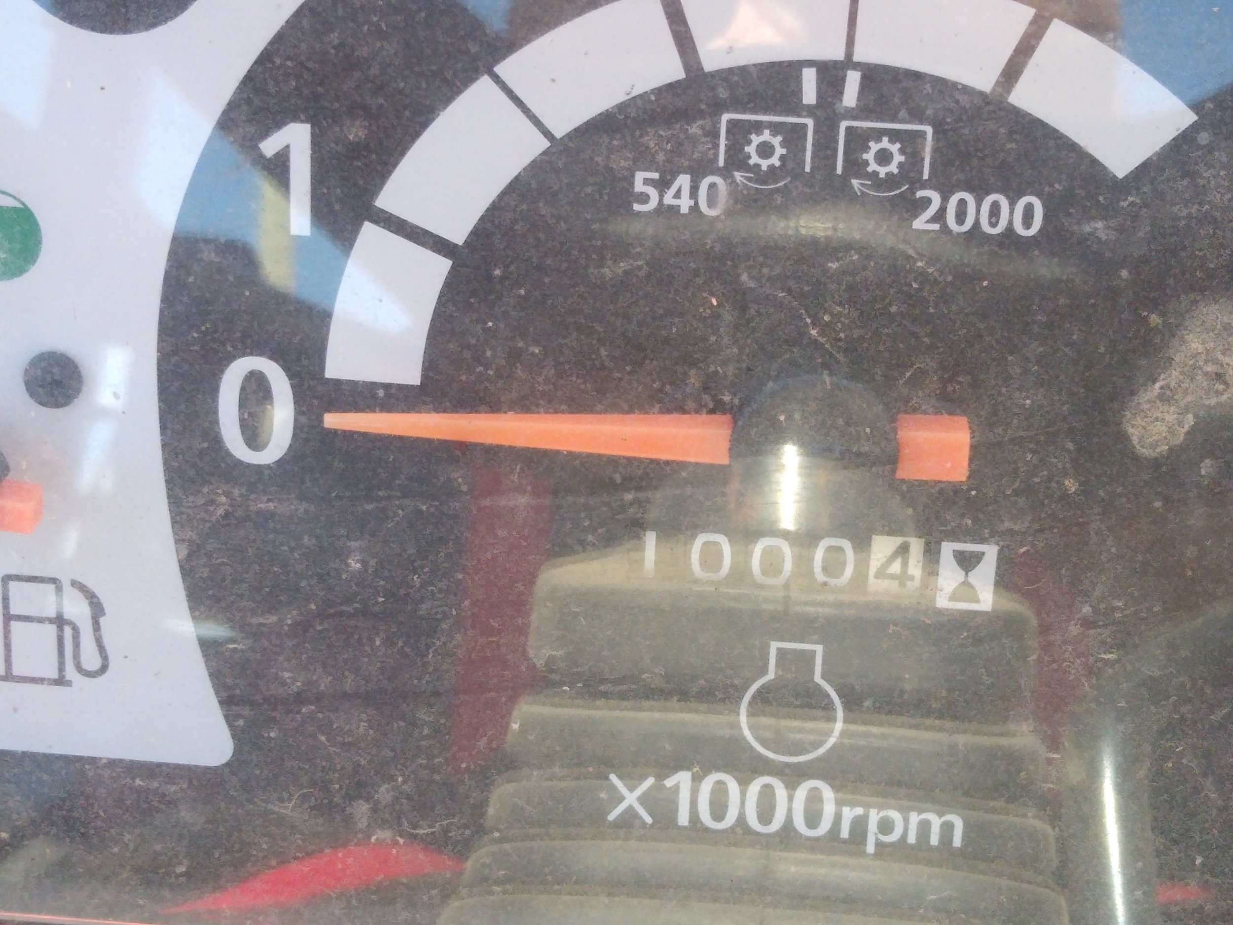

2020 1626 shuttle. Never been to the shop. It's definitely had a hard 2+ years.
Love this tractor. Would definitely buy it again.
