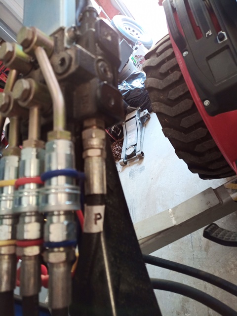

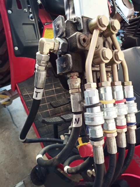

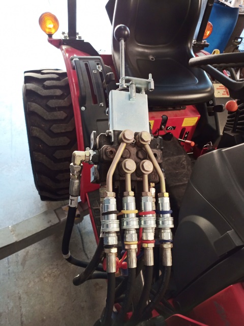

Ok, guys, here are some pics.
I cannot take a pic of the TNP manifold because it is blocked by framing.
That, also makes it a pain to connect suff.
The diagram I sent previously showing the TNP positions is what the picture would look like.
hope is is clear to see with the following. IMG_20201005_102729_3.jpgIMG_20201005_102722_8.jpgIMG_20201005_102716_5.jpg
