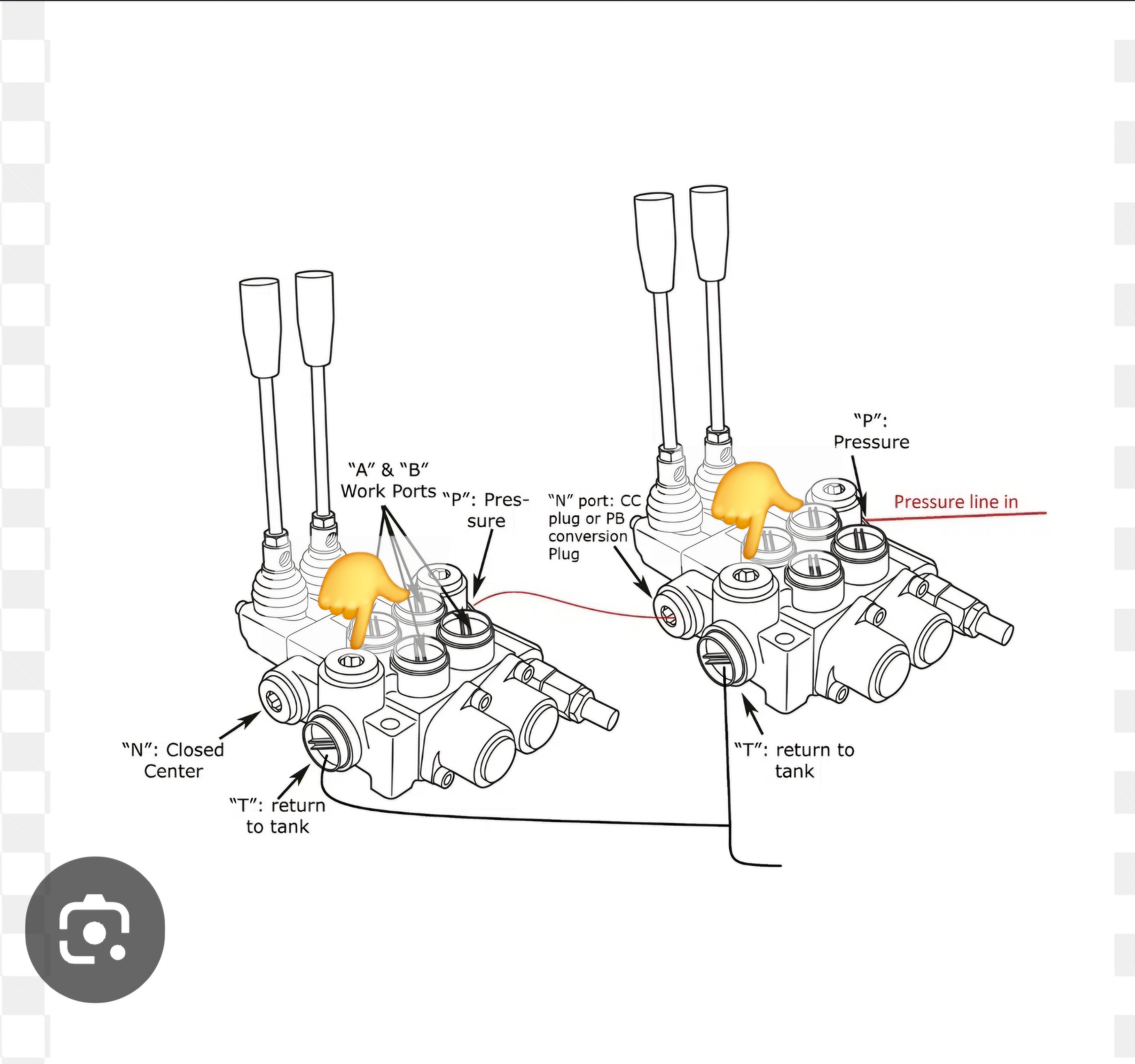

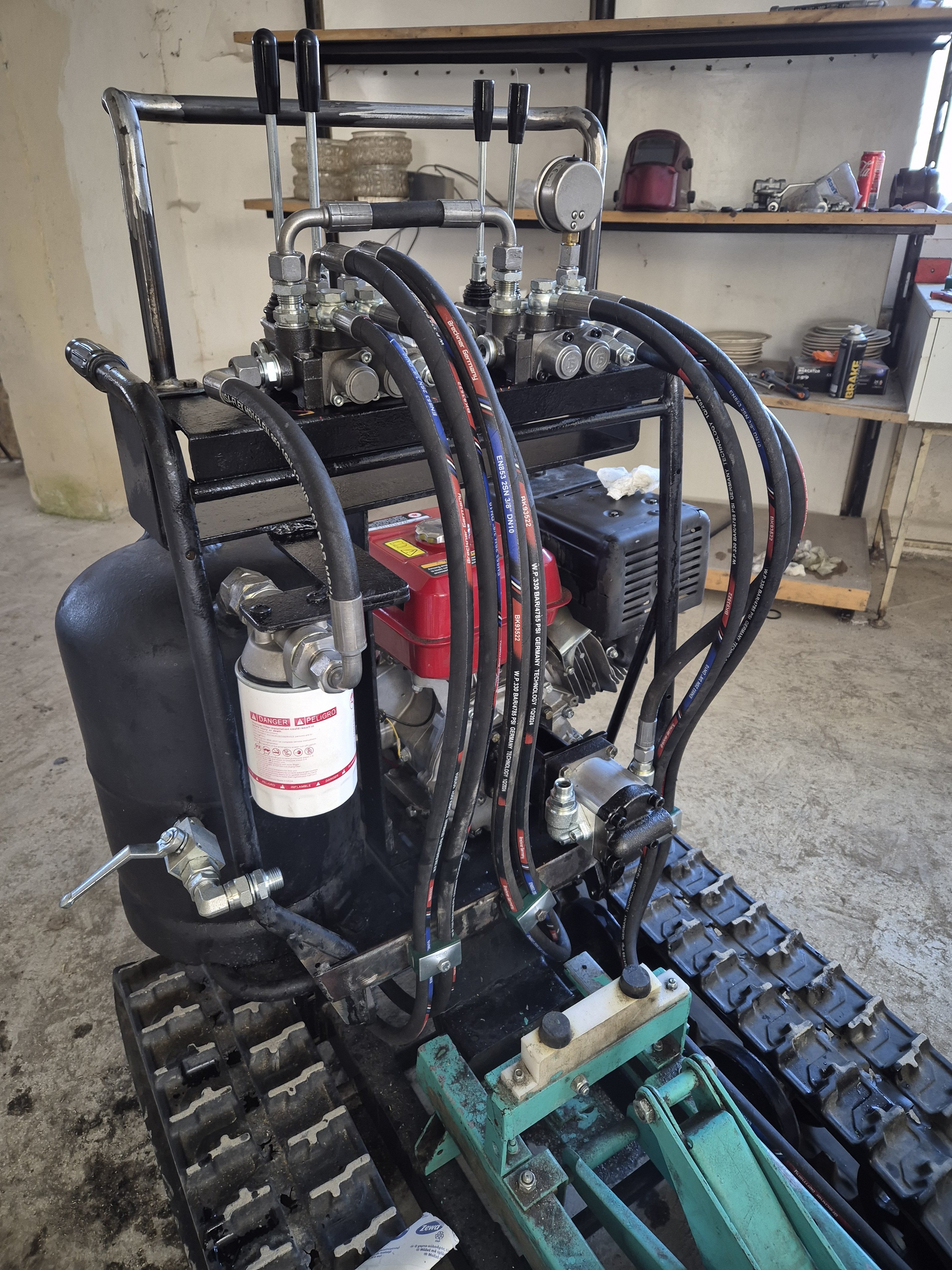

Hello,
i am working on a project, a hydraulic crawler wheelbarrow, and I have the following question.
I would like to point out that this is the first time i am working with hydraulic systems.
I have connected two P40 distributors in series through the N port and the question is if it is ok to connect the T ports as seen in the attached photos?

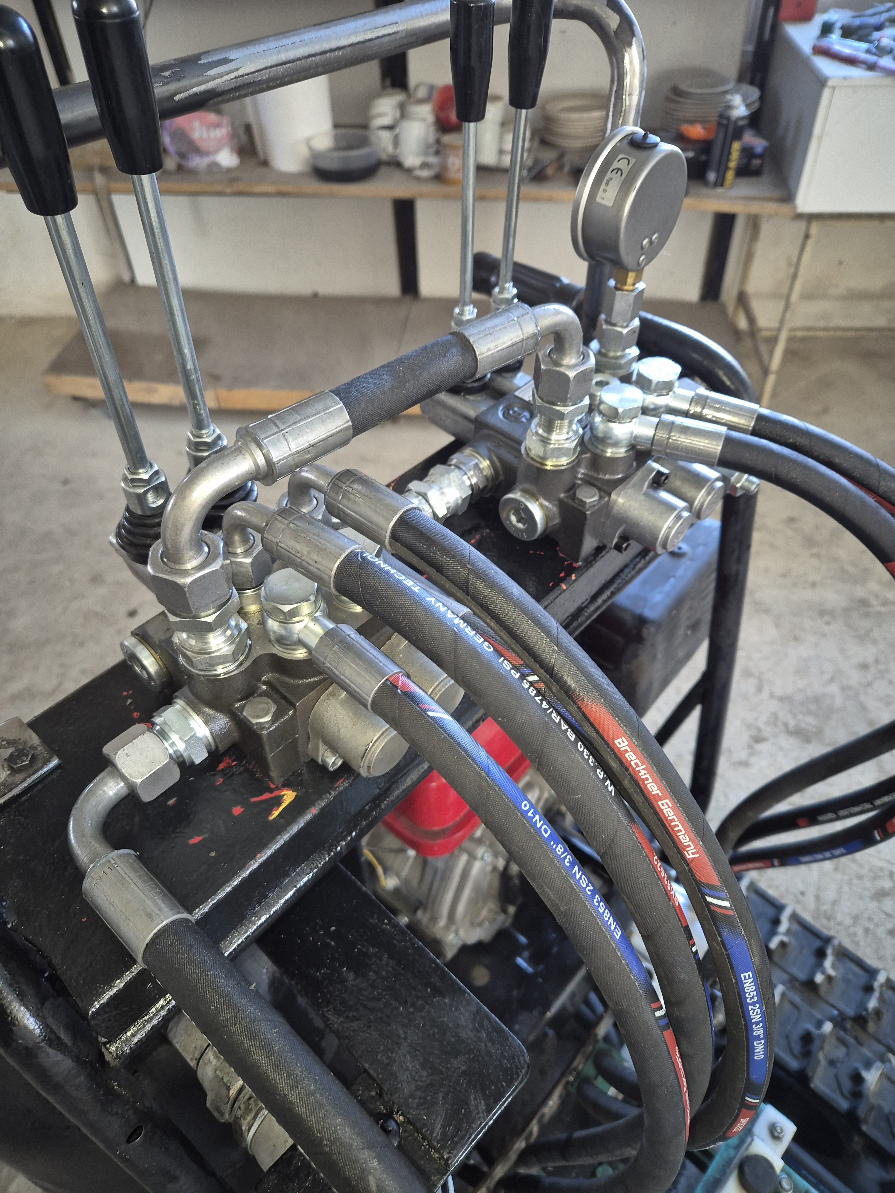

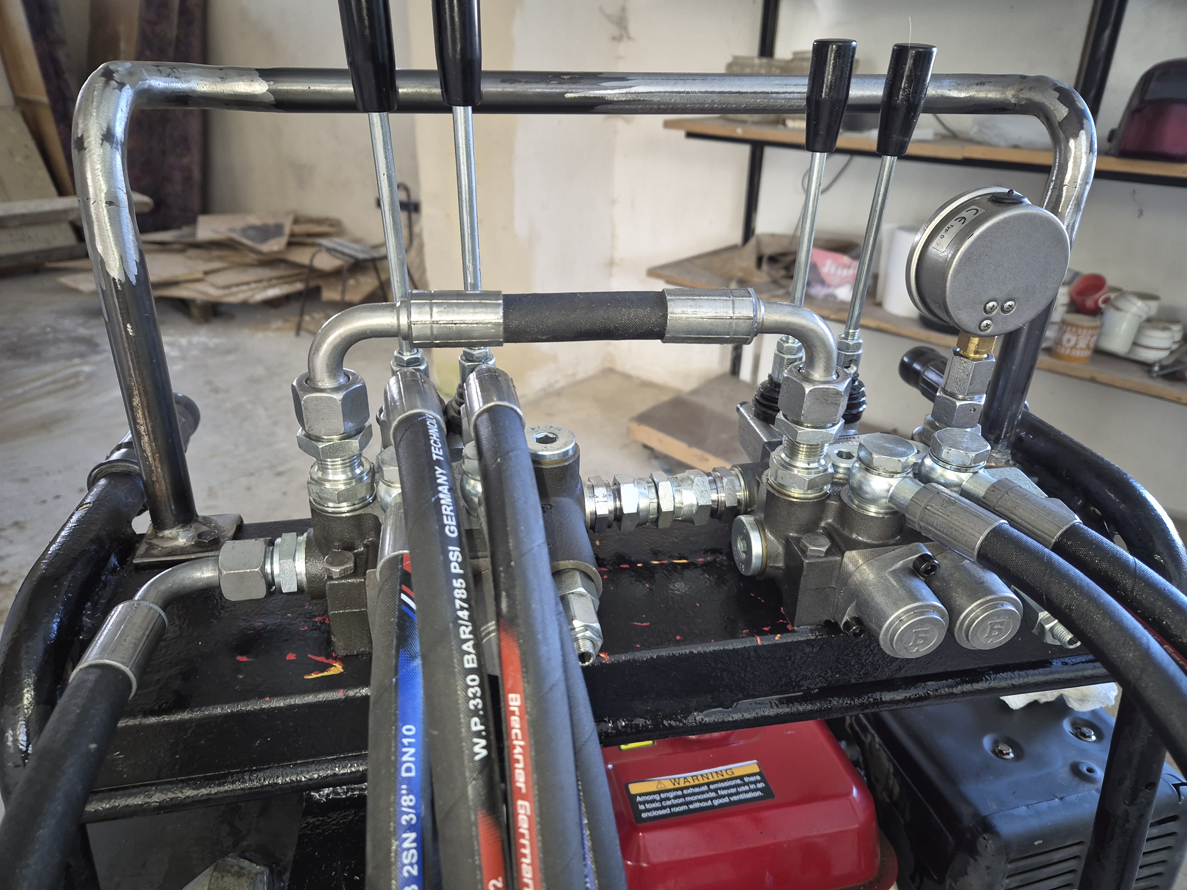

A few more pictures

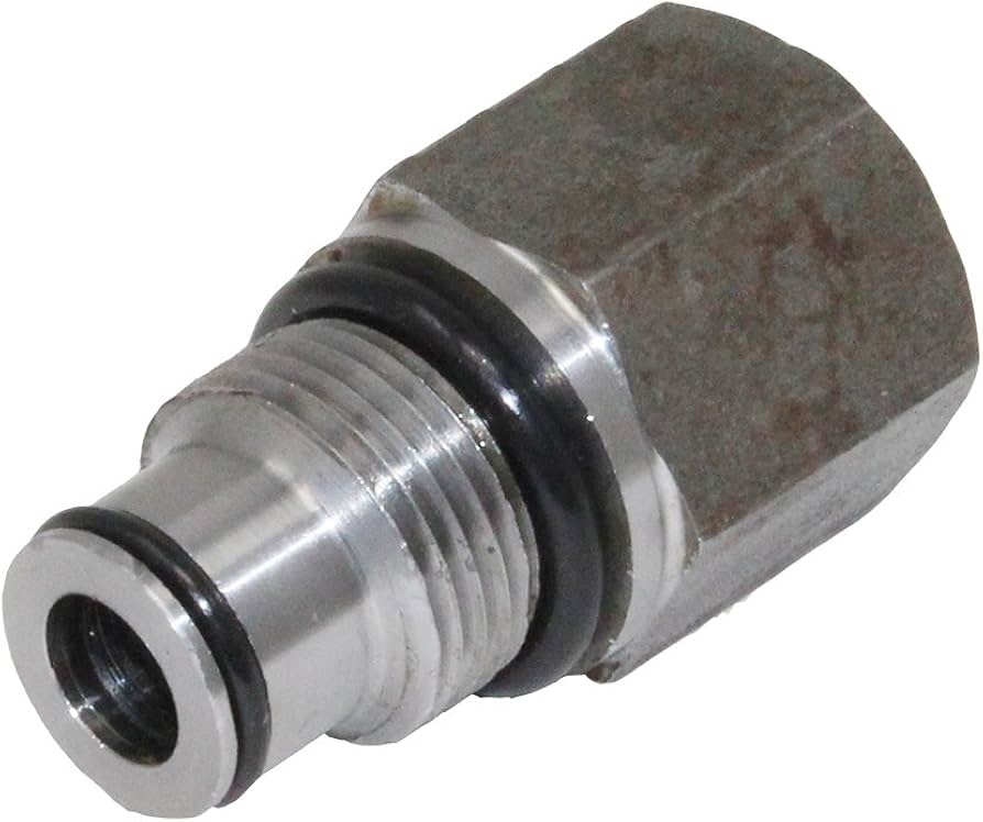

Yes, no worries on connecting the Tank ports that way. However, did you use the proper PB sleeve on the first valve? Or just a regular fitting?
/ T port valve connection
thanks for the reply.
i didn't use this PB sleeve, just a regular one (no leaks at the moment)
Can you please tell me what the difference is?
Here it is
I studied the problem and I think I understand why you need the proper PB sleeve (y)
practically separate, internally, the N port from the T port
correct?
/ T port valve connection #7
correct?
Yes thats it. Otherwise the fluid will bypass to the tank port and won't feed the second valve.
/ T port valve connection #8
I can’t tell by the pictures. Do you have one pump feeding both valves or two pumps one feeding each valve?
If a single pump you need to run pressure from pump to 1st valve. Then power beyond of 1st valve to pressure port of 2nd valve.
Then Tank of both valves to tank. They can be connected like you have them now.
