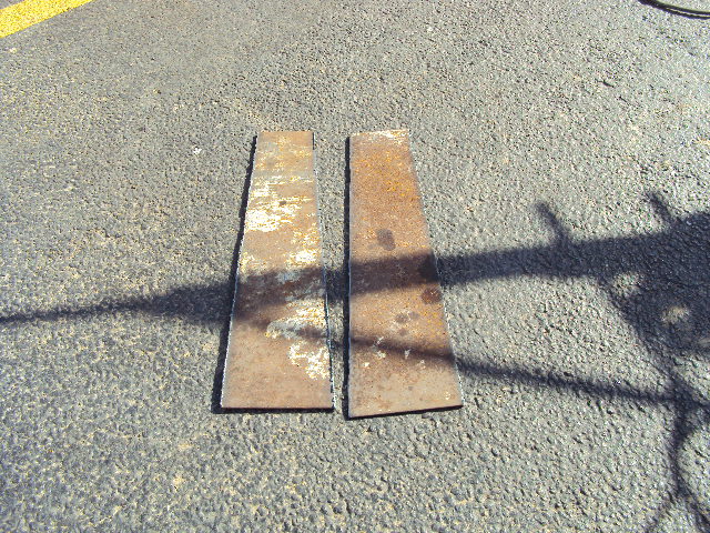

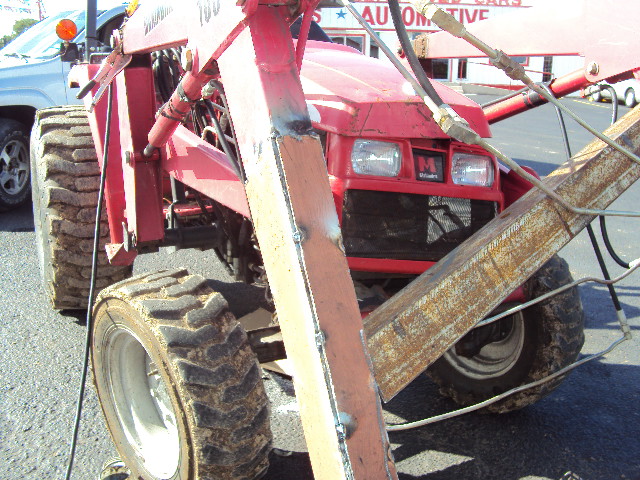

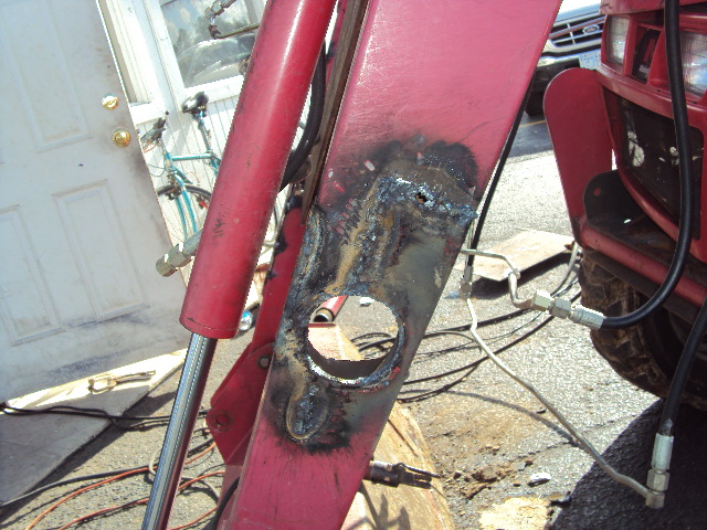

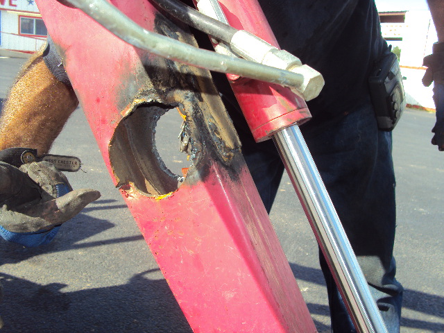

I have the same loader and the arm also broke at the same place back draging. I did away with the hollow pipe in the middle and welded plate all around the arm and replace the pipe that it welds on the inside of the arms and does not gop all the way thru. I have broken most of the front end loader parts and re frabricated every thing heavy duty. The metal is very pourous and cheap. Not like american steel.

I guess all the metal is that recycled stuff. Because when you look at the metal it is pourus. The arms on the loader were not pourus just thin. The pipe they had going from one end to the other where the lines lay on top of had some very weird looking metal. I will put photos of the finished job in a few days. I am redoing all the lines now. I welded these plates all around the arm and it holds up good now. I also ran 2 pipes going across instead of one.

I am confused. Your first quoted post does not match the pics in the second. Someone has SEVERELY abused that loader and tractor in the second post. It has been rebuilt beyond recognition. You say you have a GB built loader on a 4500 and that is clearly not the case in the pics. I have been in this business a long time and have NEVEr seen a loader destroyed like the one in your pics.
/ Mahindra loaders? #52
It looks like a 2615 with the 106 loader - not a 4500. Also, the modifications make me wonder it one would ever be able to remove the loader according to manufacturer's instructions.

I got off topic here. I was on 2 forums and posted the wrong one. Yes it is a 2615 with the 106 loader on it. Destroyed. Well when you put a torch to something it takes the paint and all off and makes it look bad. But it looks pretty good now. The grill part is working clearing trees with out a grill guard which I have also made now. With a new front on it. I do lot of driveway dig outs also and changed to a tooth bucket now. When you use the wrong equipment for something it is going to have some damaging efects. But my machine is workig great everydau and I am enjoying it after all the mods. But at the same time. My skidsteer I purchased does not get torn up for the same work I do. Mahindras have fast hydraulics. Weak buckets. Bad on cooling which I fixed now by turning the oil cooler sideways and new front end with fans.
