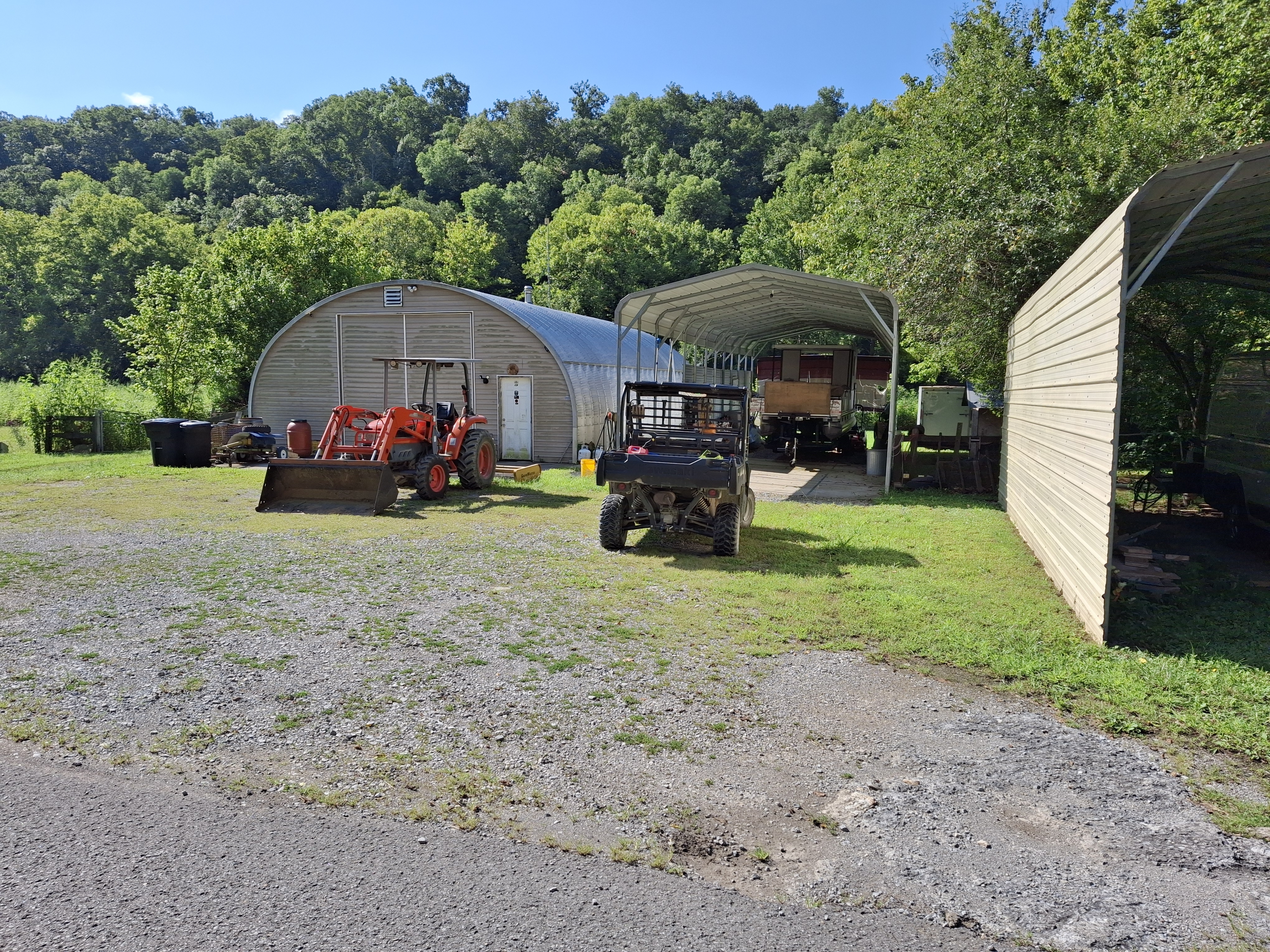

I would really consider a metal shed to park the tractor inside, My pontoon, Airstream and tractor all have dedicated sheds to live in. It's not just the wet East TN winters that ruin things, it's also the sun.
