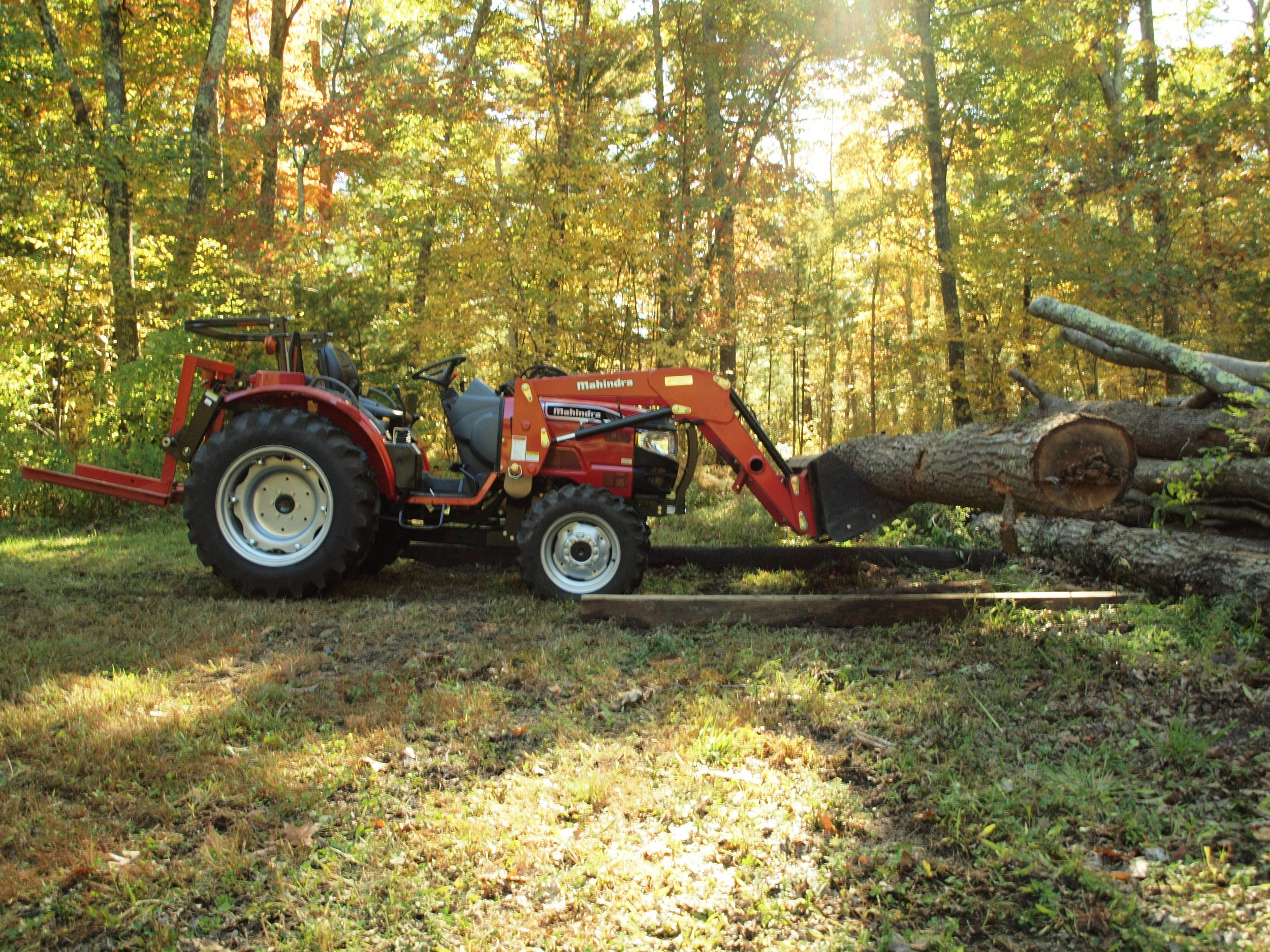

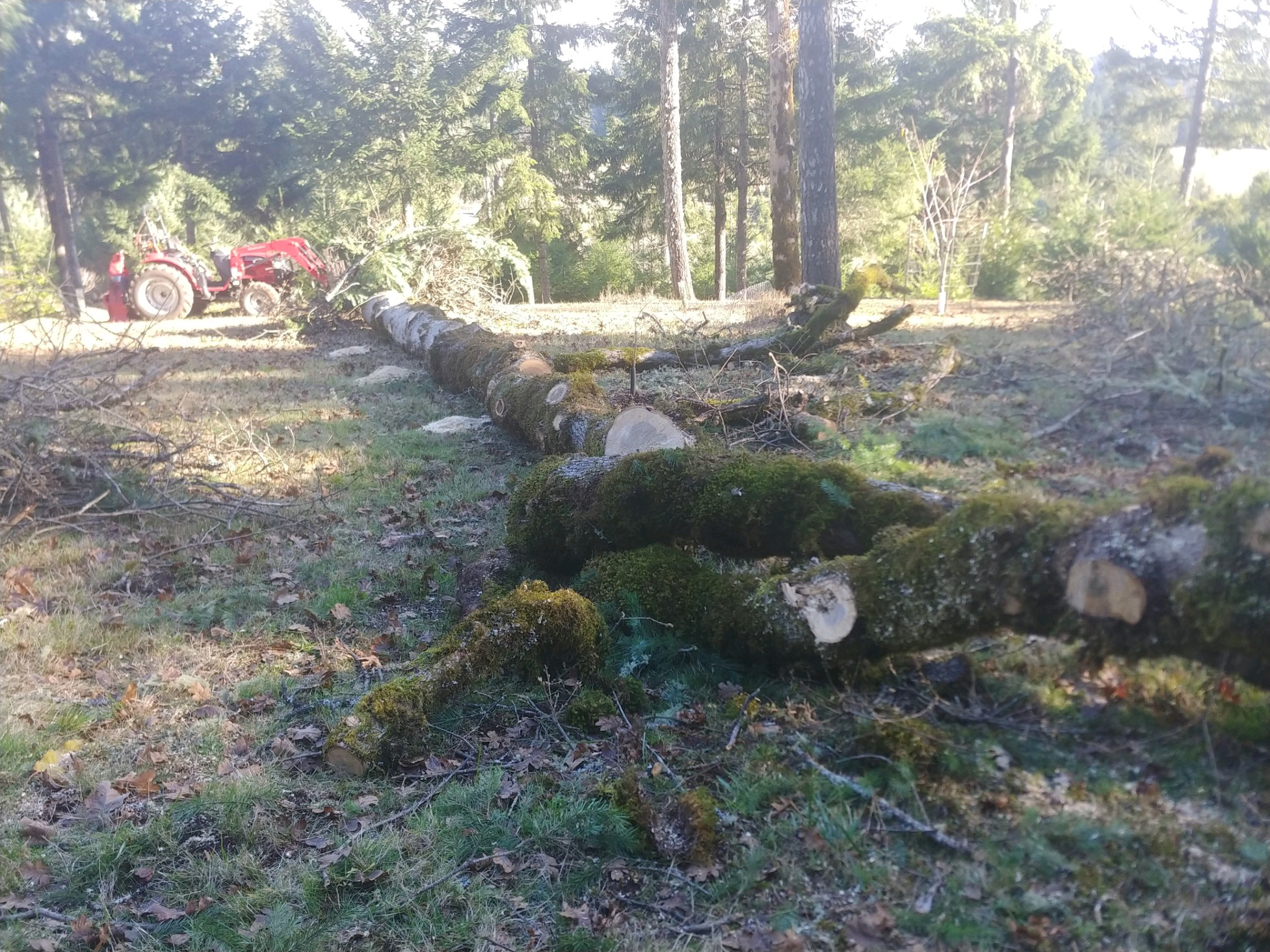

The 3016 barely lifted these 22" x 8' sections of Savana Oak today; I chose "forking" them over skidding...
I have 400# of rim guard in the rear wheels.
Mia culpa; the hydro fluid & filters are due for a change....😳

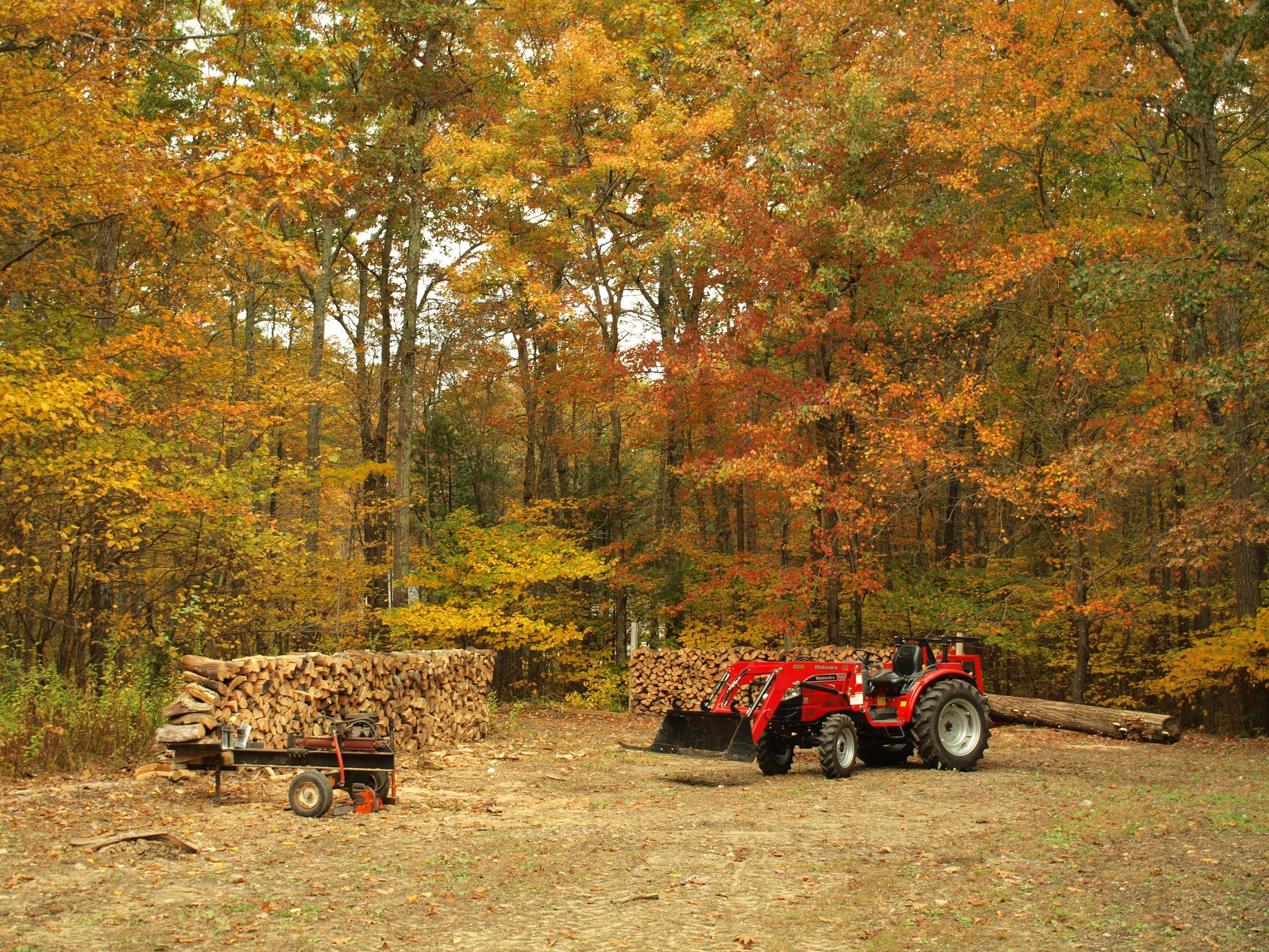

Still, the 3016 is pretty strong for its size. I use a modded carry all on my shuttle tractor for the heavy stuff as I do not like walking the tractor too far with this kind of frontal load. The oak stem pictured is about 1700lbs.

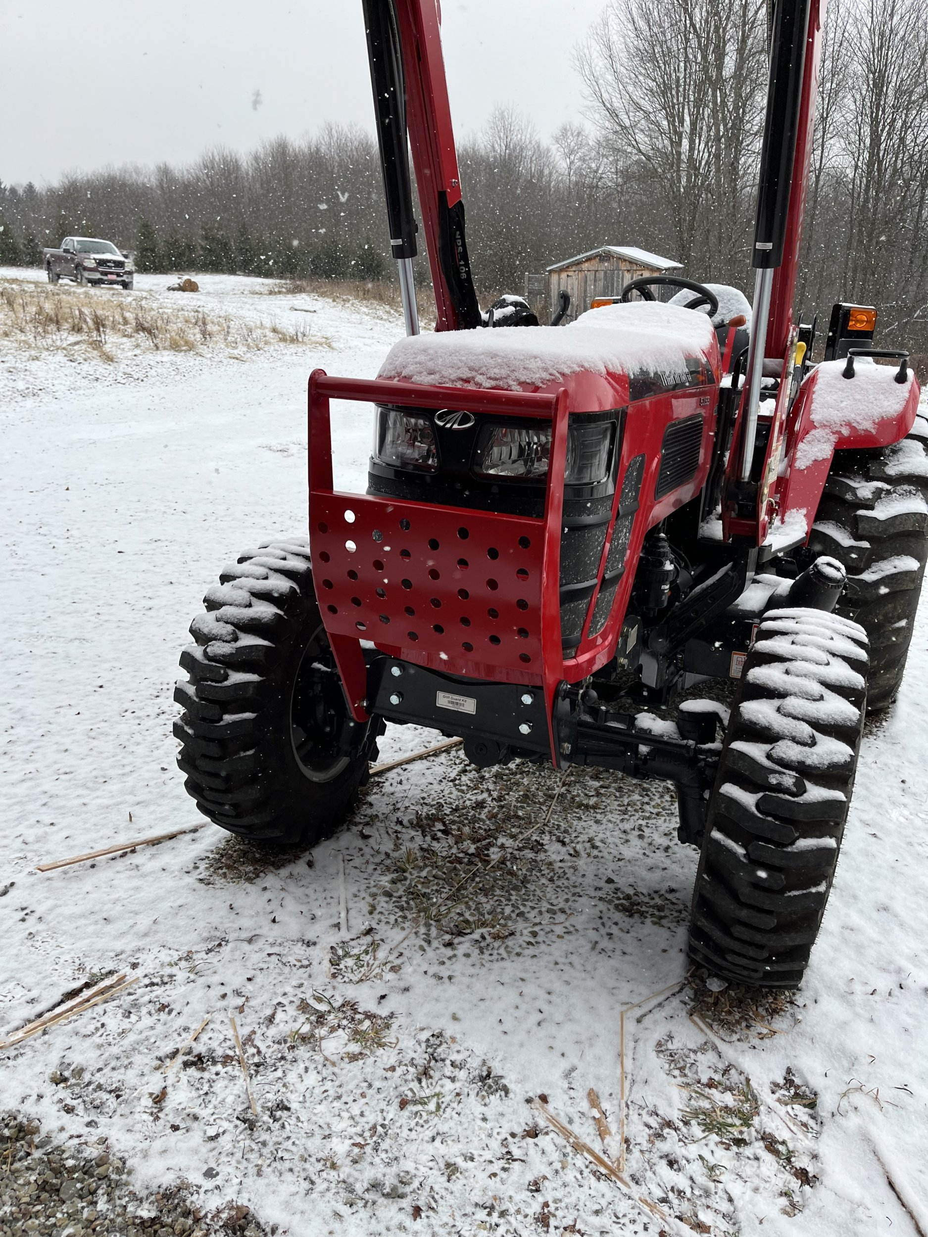

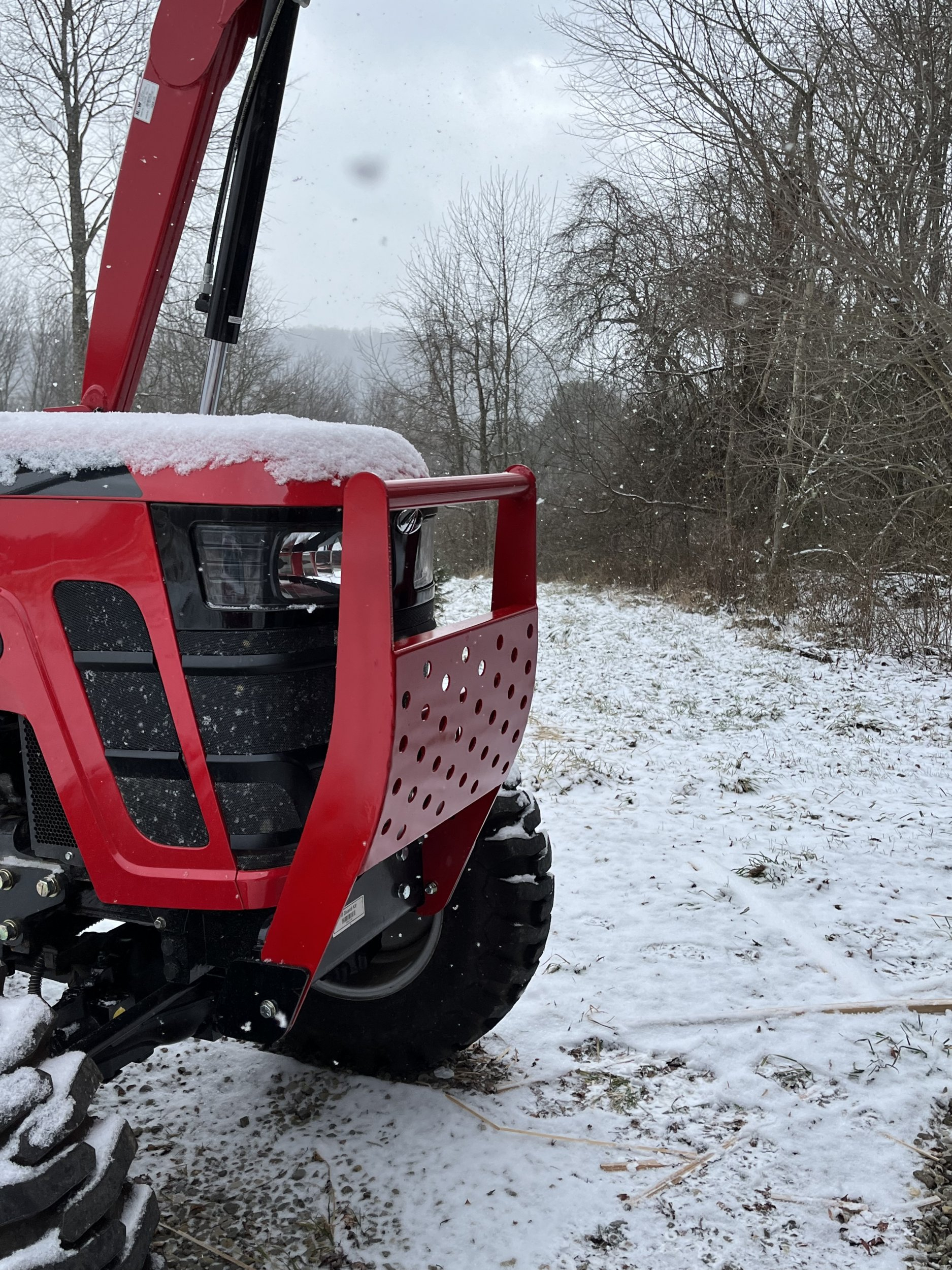

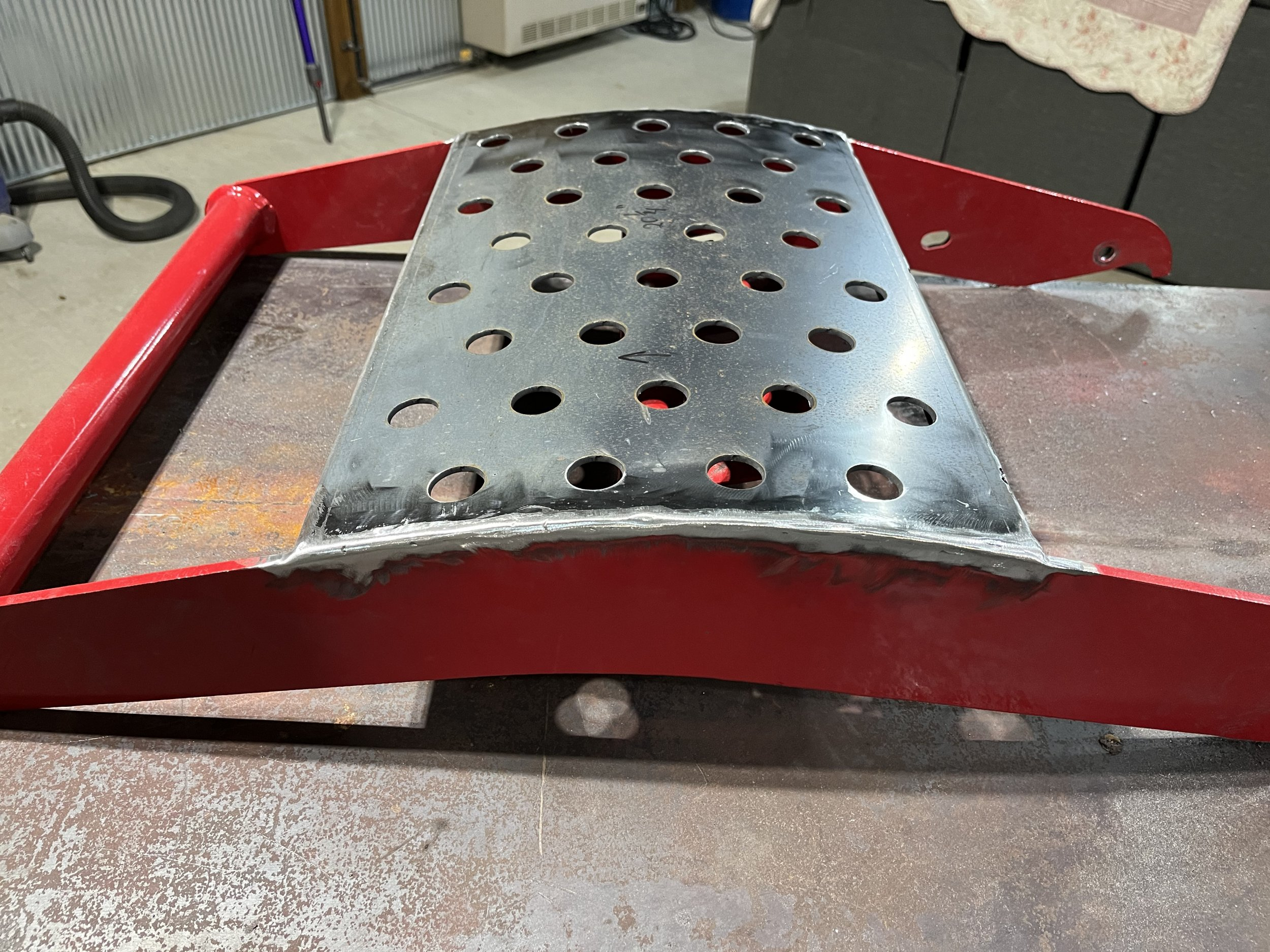

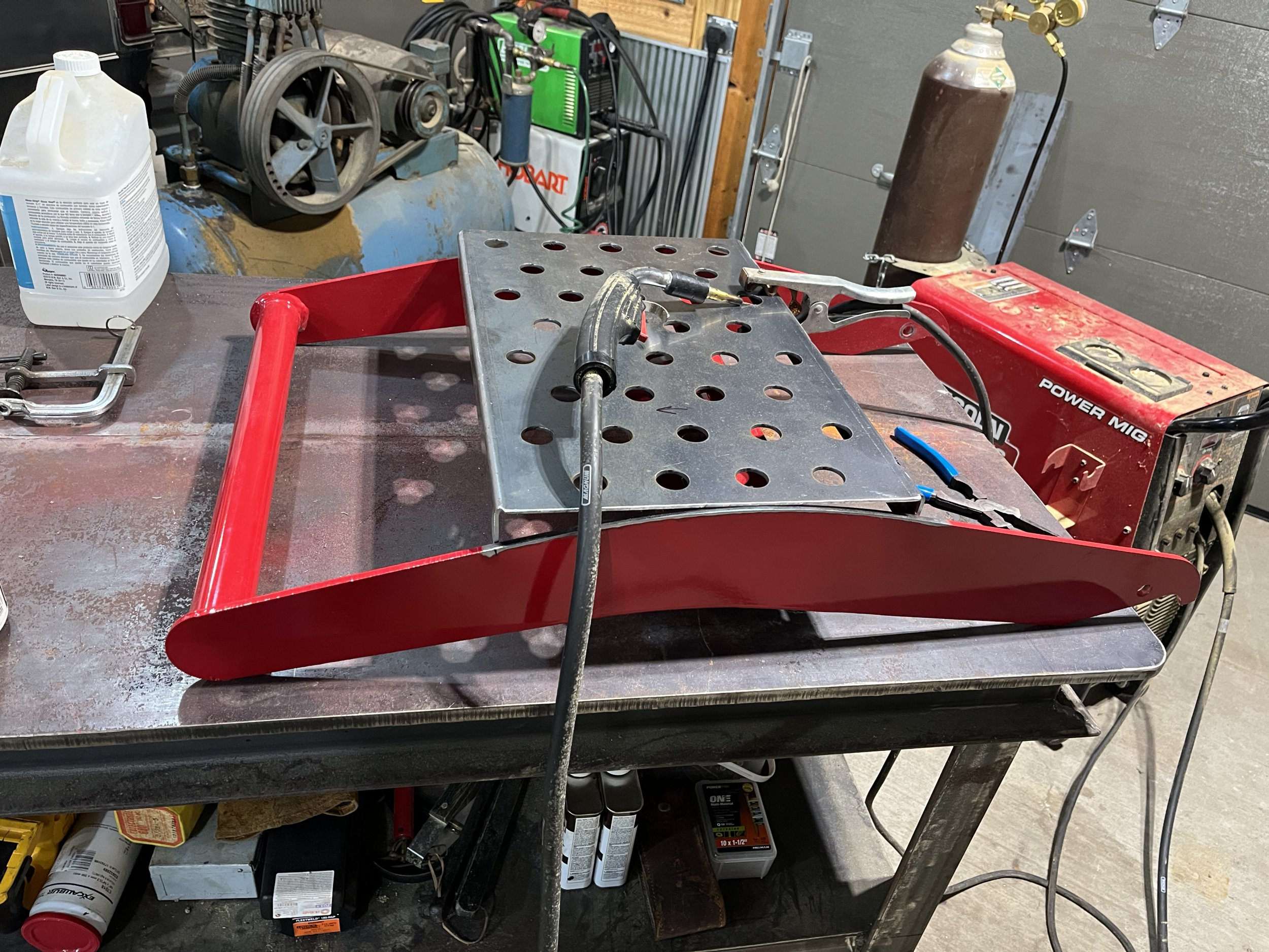

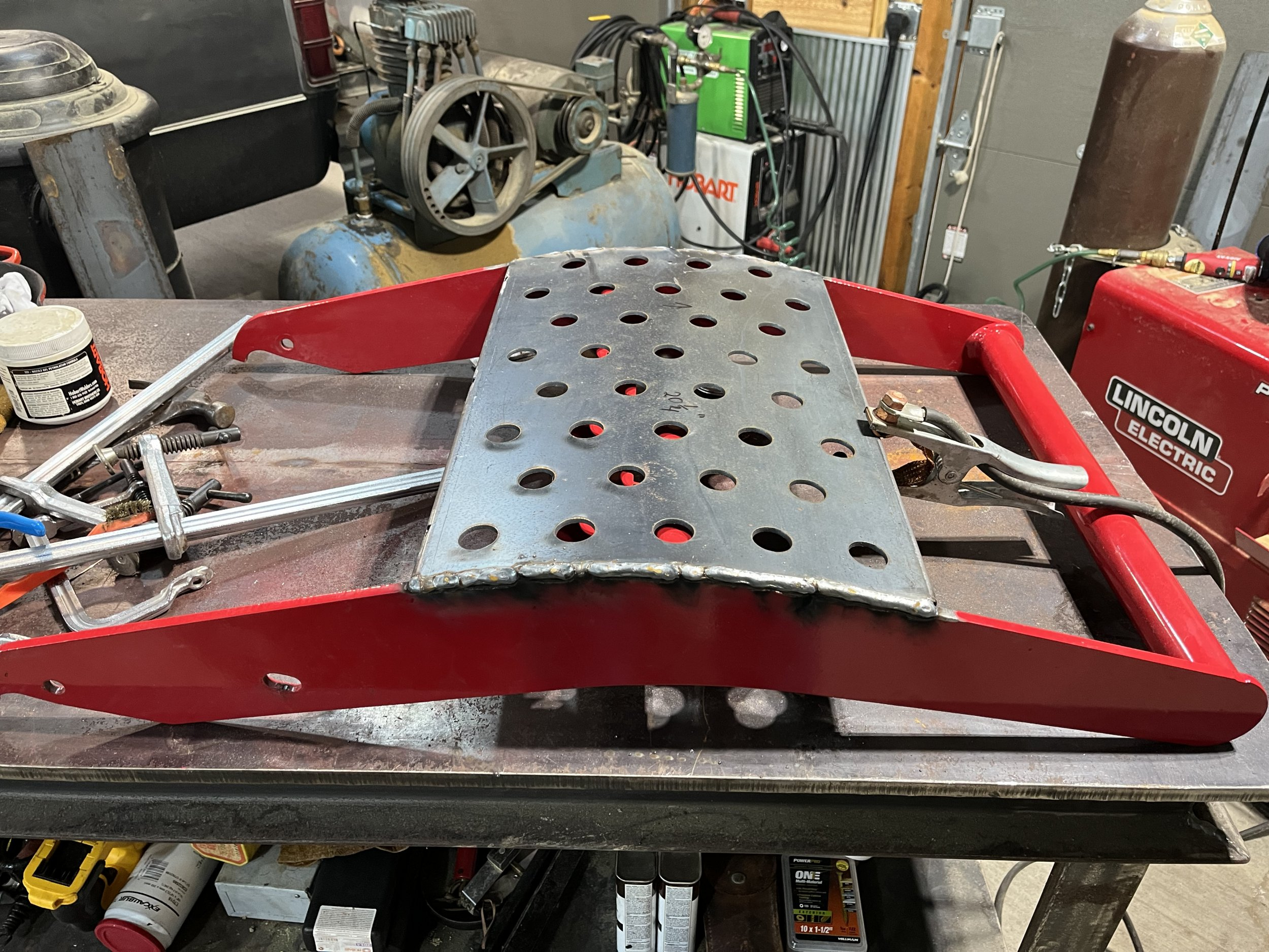

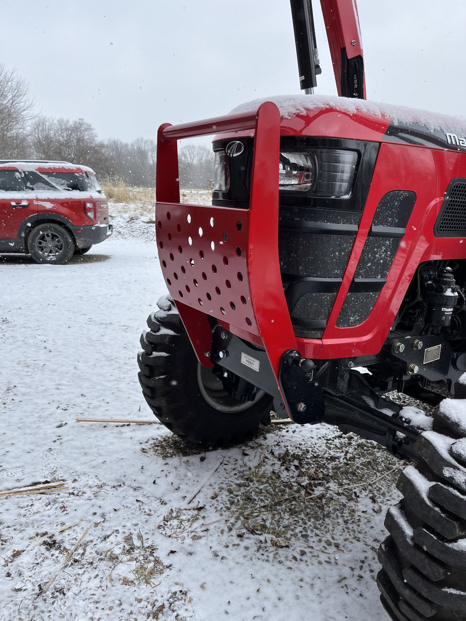

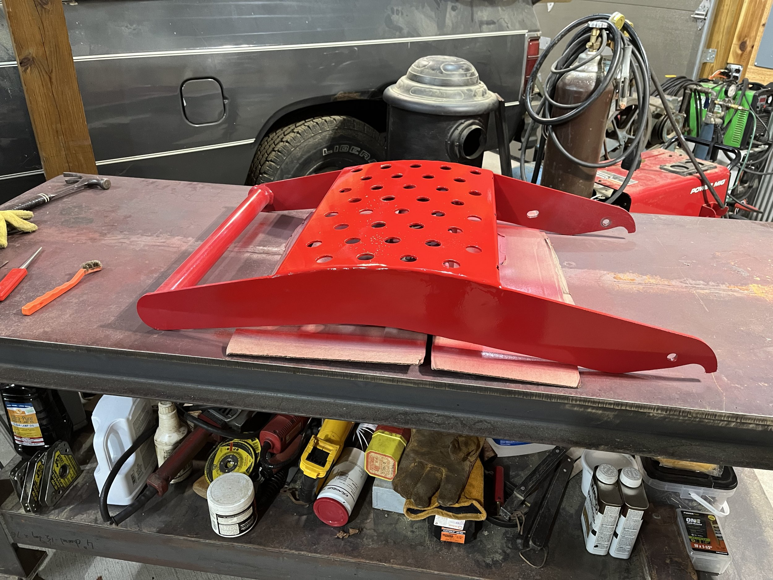

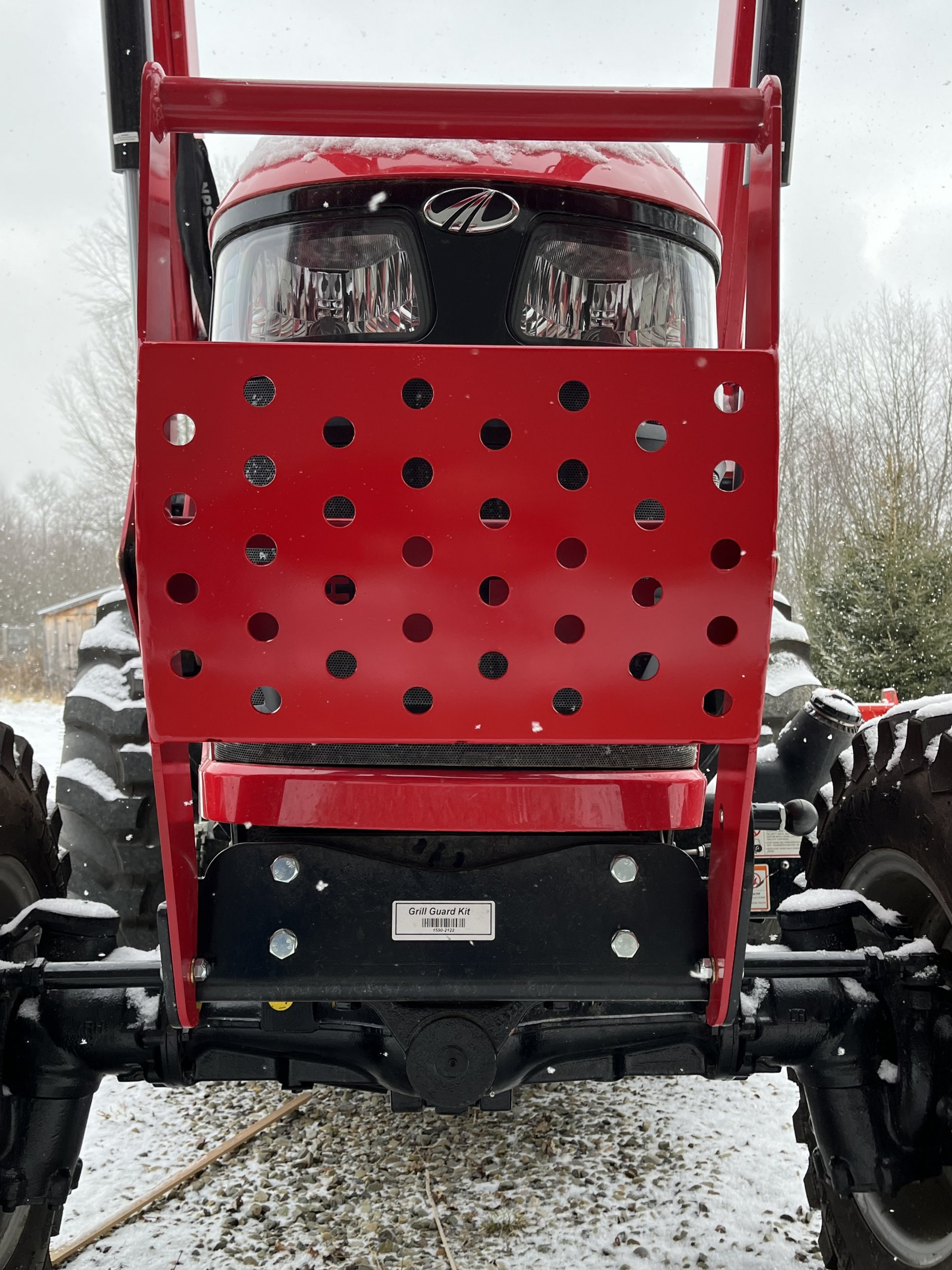

Just a little project I finished up today. I wanted to improve the protection of the factory grill guard. So I got a piece of this 11 gauge steel that had holes plasma cut in it. It was a leftover piece from a shop I know so I got it cheap. Anyway I think it will improve my chances of not puncturing my radiator when I’m using the grapple etc. BTW I found that Rust Oleum ā€œSunrise Redā€ is almost an exact match for the Mahindra red color.

Nice, i'm thinking of doing the same but i'm planning on using bar grate
