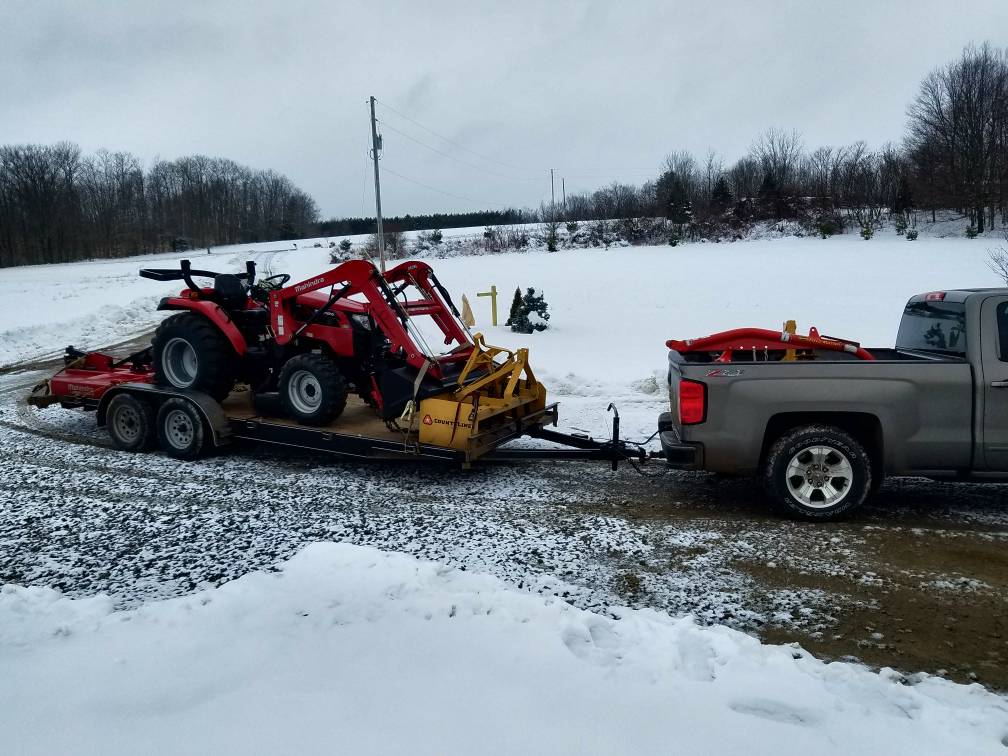

Anyone know what a 2016 mahindra 2538 with loader weights,(non loaded tires) looking to move it long distance and trying to figure out the weight, I'm hoping a 20' 7000gvw dovetail trailer will be fine and also have no issue pulling it with a 2017 silverado 5.3, thanks for the help

About 4,300 on tractor data. com

Why ? I think you need a bigger trailer

I would get a 10k or 12k trailer 22 foot deck Whats you truck rated to tow
/ Mahindra 2538 tractor weight
2017 silverado 5.3, i'd say around 9k to be safe
/ Mahindra 2538 tractor weight #8
Whats the empty weight of the trailer?
Trailer is 2000lbs, it's my father in laws truck I'm assuming it's just the standard 5.3 eco tec3 to be safe, I think the truck shoukd be fine either way, I'm more concerned with the trailer, I'm right at the max, and trying not to spend the extra $$ for a 10gvw, trailer, I won't be hauling the tractor much at all,

Yup made her home, long slightly stressful tow, but no real issues
#17
Yeah it was a tough call, I was trying to keep weight of tractor over axles, best I could, i was more worried about back tires of truck, but we made 60 mph whole way Charlotte NC to upstate NY,,, I wouldn't want to do again without a 3/4 ton truck20180306_121659.jpg
