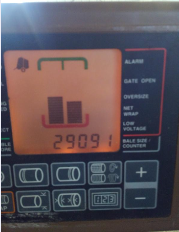

Not all rd balers have a duckbill. I know JD rd balers definitely don't have one. I think JD net attachment is relatively simple. My JD rd baler netwrap is still performing correctly with minor maintenance with 29091 bales wrapped. Ferrous dust hasn't affected my balers switches either. I've never seen the need to sharpen the net knife.
