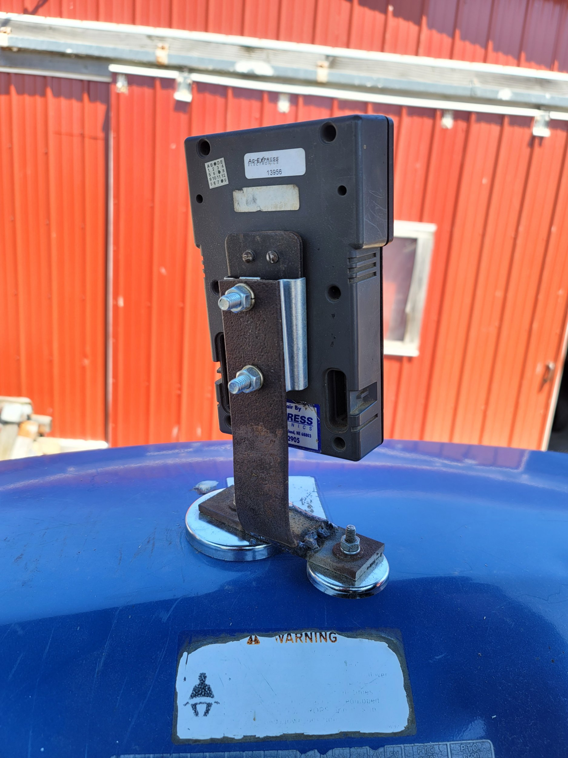

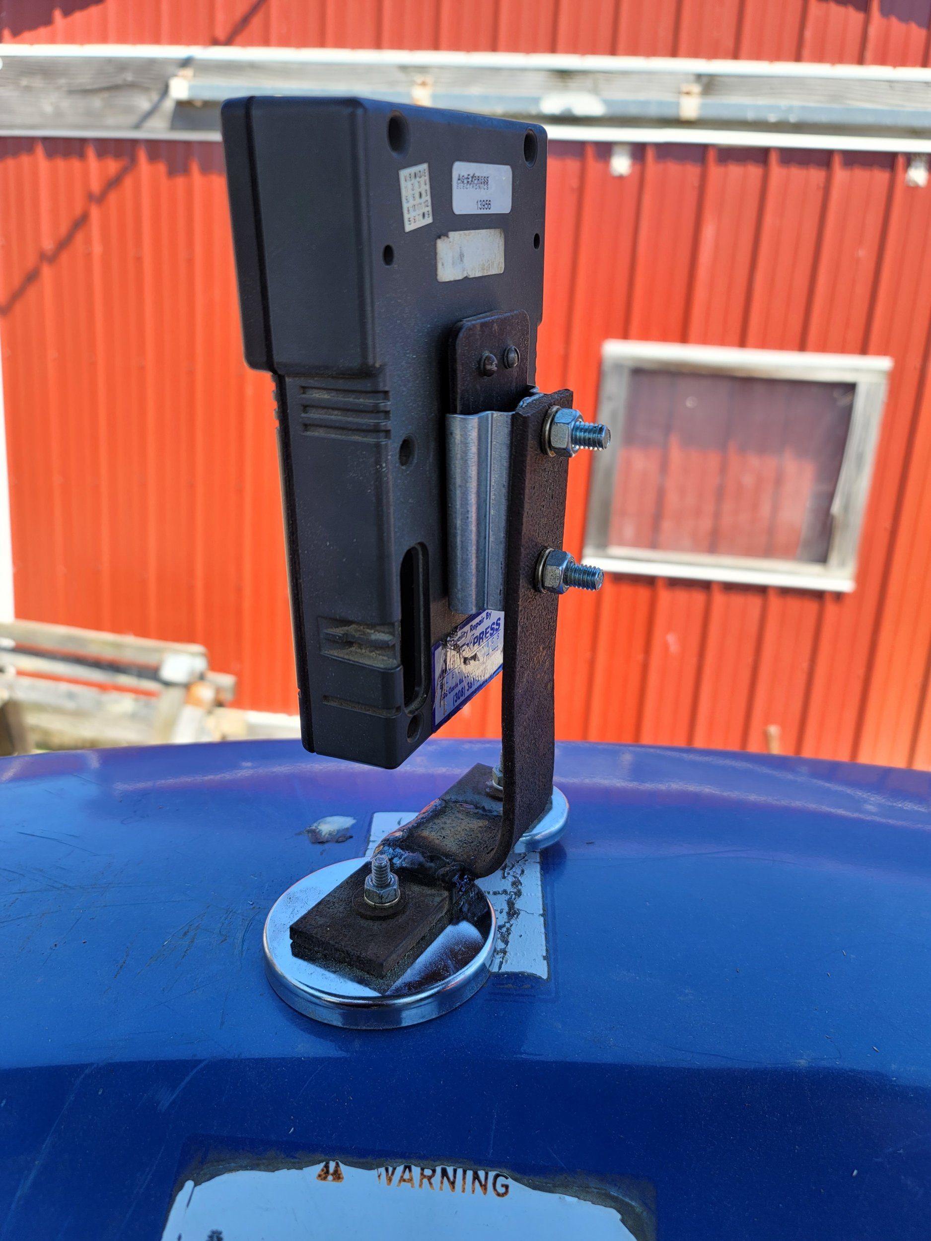

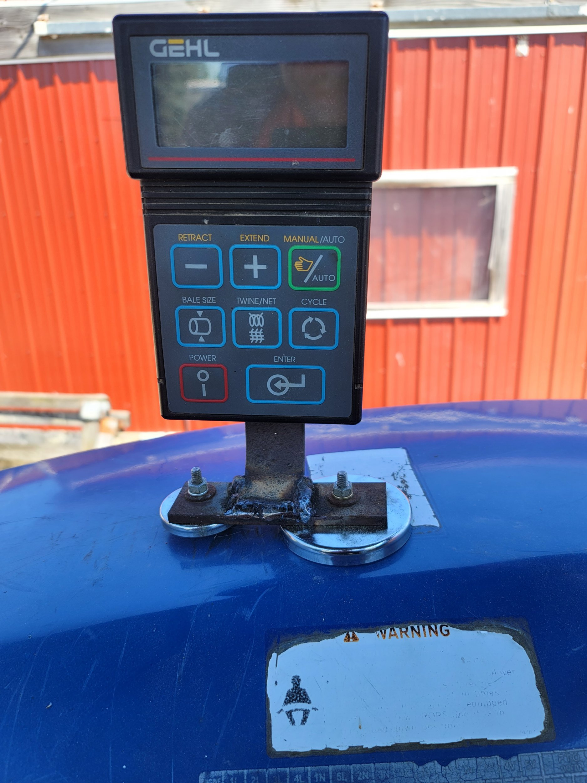

I'll update with some pictures later but yes, the emblem holder worked. The bracket on the control box fit just a bit more than half way into the holder. I bolted the holder to a piece of flat iron and made a 90 degree bend at the bottom then welded that to another piece of flat iron (I have tons of little pieces of metal every where). I used some magnetics I ordered off of Grainger and bolted those to the base and it functions great. It doesn't look pretty or anything but it held the control box in place on my fender while I worked and that was all I needed it to do.
   / Magnetic mounting hardware for round baler control box?
My homemade holder. It's ugly but it works. The little magnet is useless and wasn't strong enough, even with 2 so I had the bigger magnet around and used that.

Different angles.
