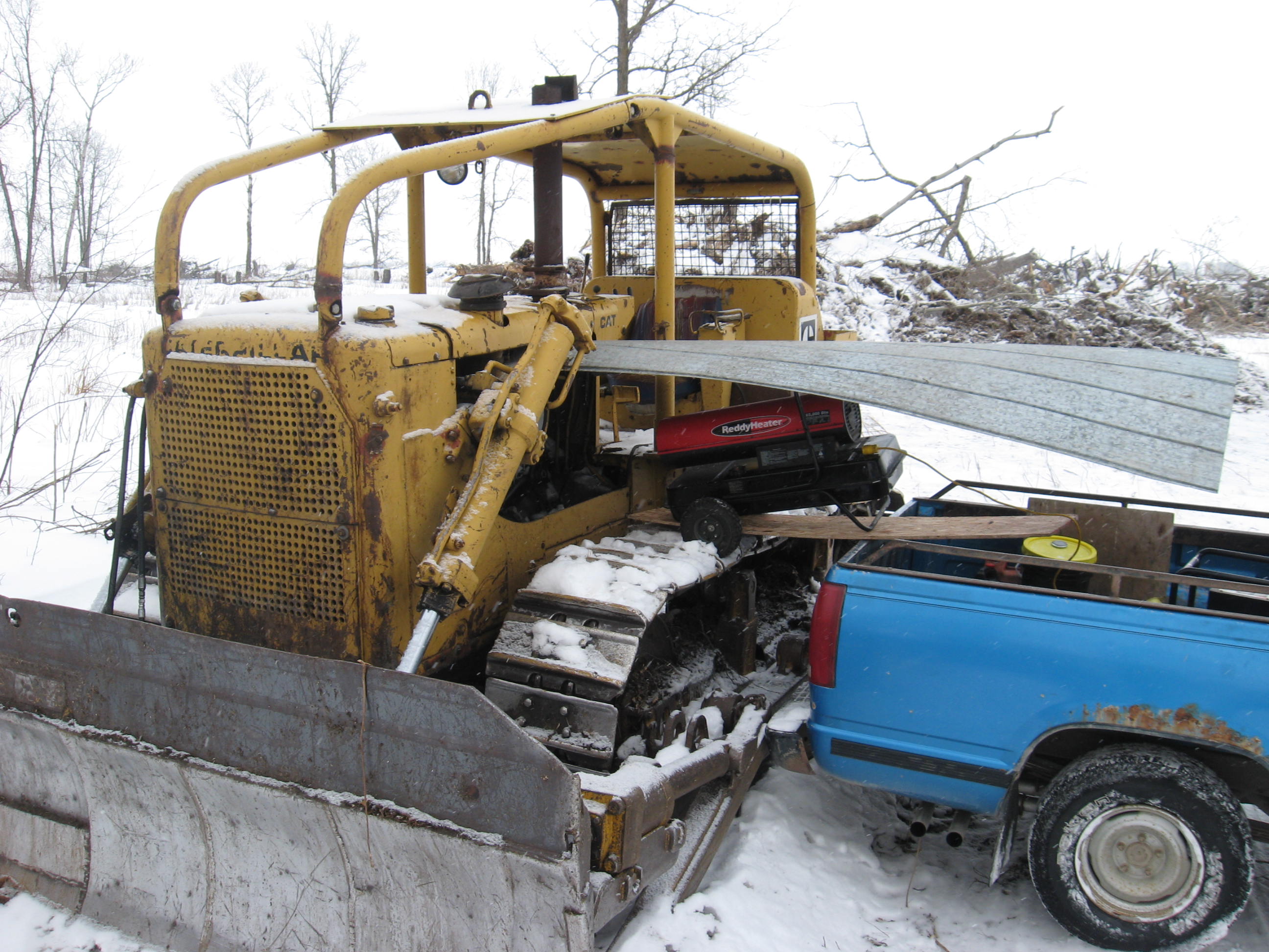

Inline hose heaters work very well, thank you.:D
Yes they do , actually better than core plug ..We have 30 odd pieces of equipment that has to start down to -35c . The 5 that have hose heaters are the fastest to warm up . Just throw magnets in the trash and same time .
Sometimes it's the only way :)
