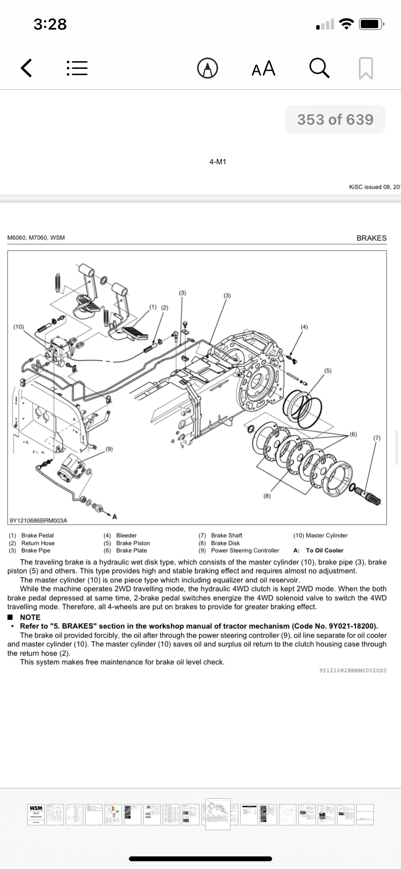

From the WSM.

Great image of the chassis and rear axle area with brakes. Very informative.

Transmission oil? I can't think that the brakes use transmission oil or any other oil. Surely they use brake fluid. Anyone else know for sure ? Manual should say.
These are wet brakes, the oil for the packs are being supplied by the transmission oil.

Ok that’s better than mine. Mine has a flimsy rubber cap and you fill it like an automobile master cylinder
I am gonna take the master cylinder apart after new year's, I suspect a plugged screen, I'll see. Gotta remove the loader, bonnet and dash assembly to get to it. Happy new year!
