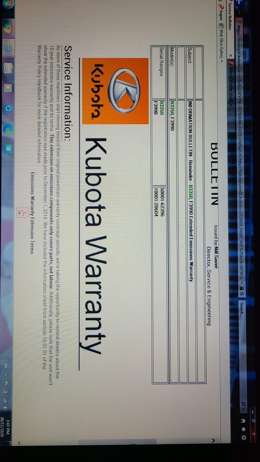

Anybody with a B3350: warranty out to 10 yrs now for emissions

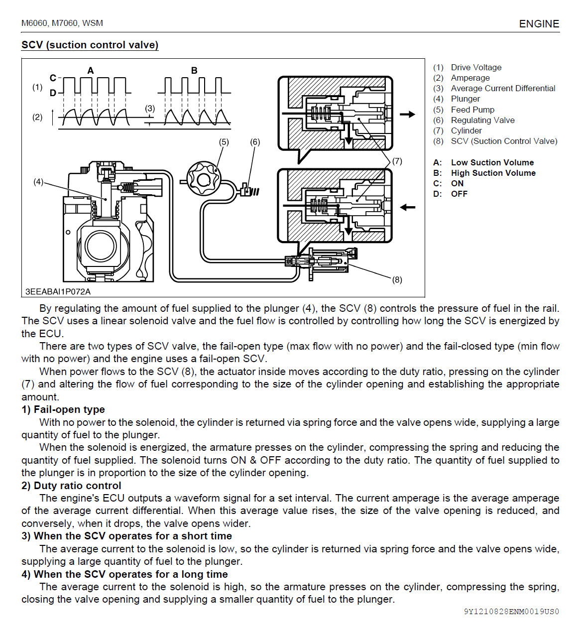

It was more than dirty fuel. Had error code for high pressure in the rail system, a new solenoid fixed it SCV.

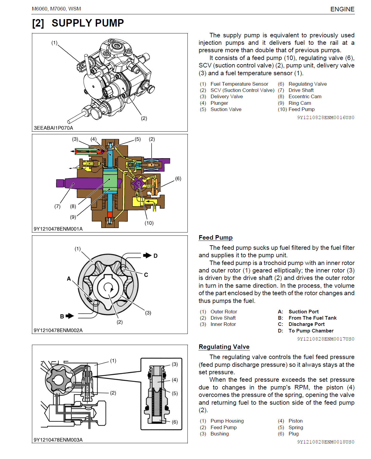

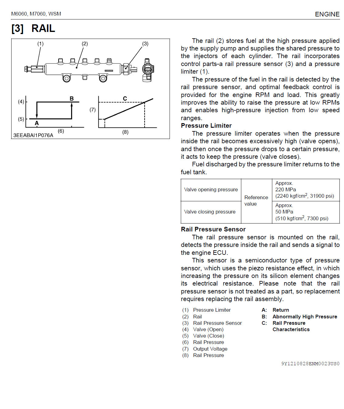

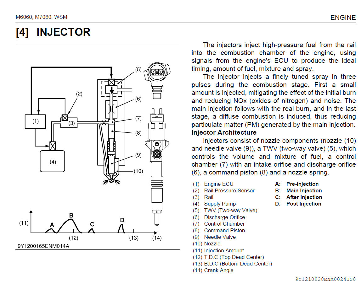

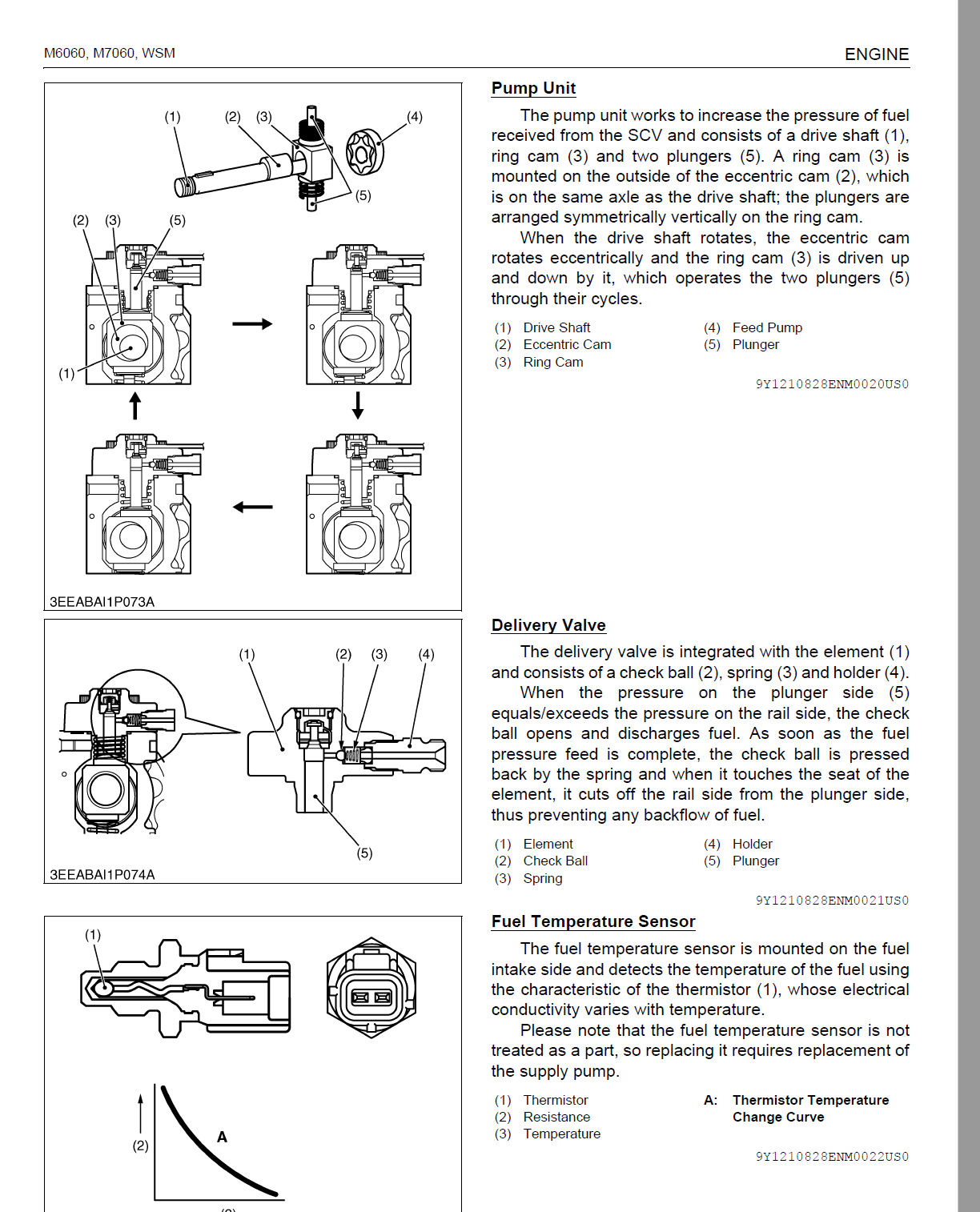

LATEST UPDATE
Fuel is off to the lab, reason I've 2 more drums full
The service was drain tank, flush. clean water separator, replace fuel filter, replace fuel pump, replace SCV solenoid.
The SCV was the cause of the high rail pressure error
ran some seafoam and marvel, then force a regen
KTAC does NOT cover losses due to contaminated fluids
I'm asking for old fuel pump and SCV solenoid so I can inspect, if the solenoid has an electrical open circuit I might ask for that portion of the bill be warranted.
So to sum up, it WASN'T a regen problem, looks like fuel waiting on lab test, however the check engine 50% power was the SCV solenoid will investigate that for qummed up or electrical failure.
See pics for fuel systems explanation and what is SCV function.
