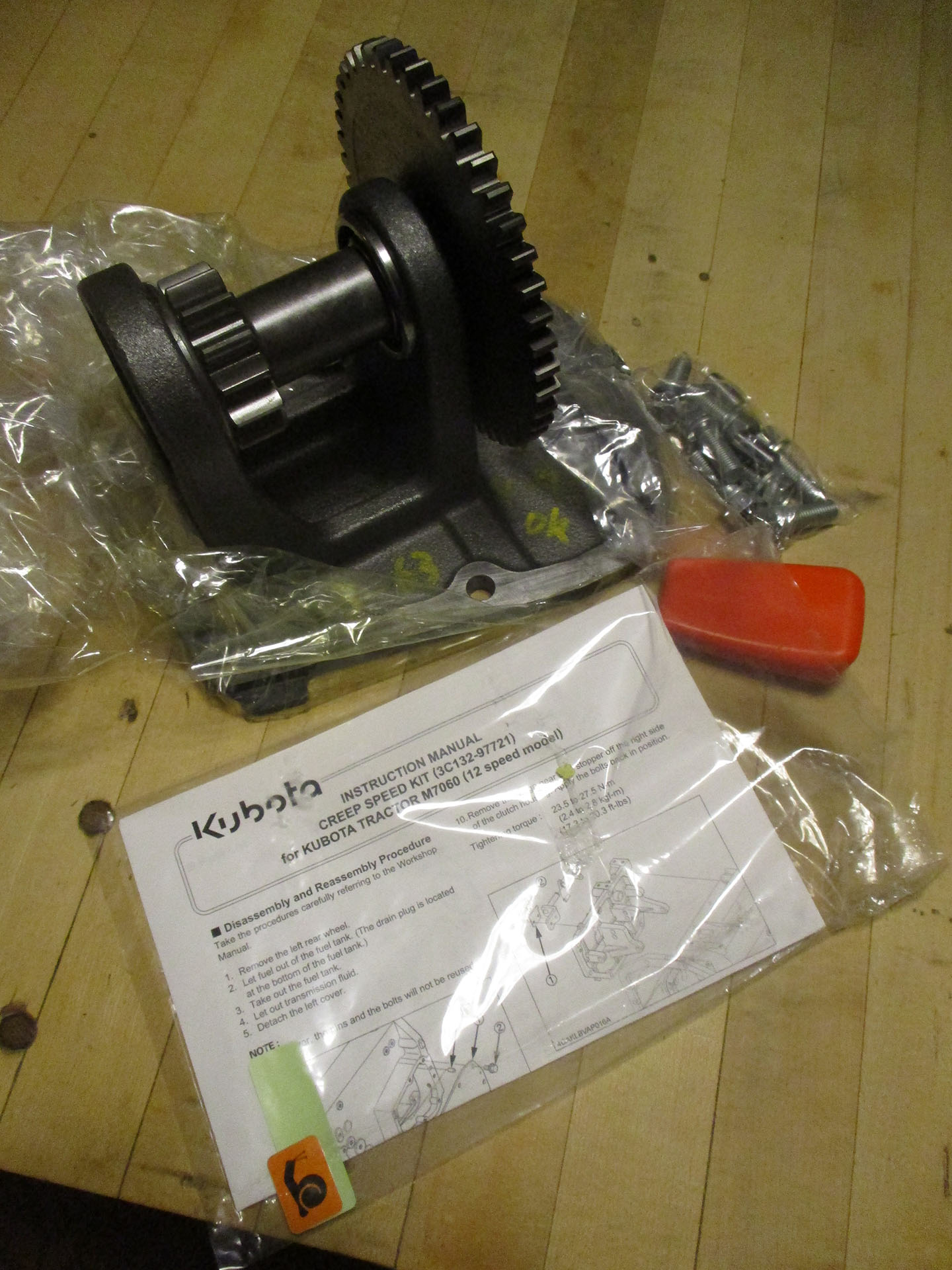

I installed the creeper kit on my M7060HDC12 about three weeks ago and love it - it was basically an easy install. I bought my kit thru the dealer. I use the creeper gears when I'm feeding my cattle while grinding it in the mill. Like you, I found no information on the 'net so I hope the following is helpful to you. This is for the 12-speed transmission but the 8-speed is most likely similar.
Kubota suggests that one remove the left rear tire but that isn't necessary. First, the tractor's left step must be removed, then drain and remove the fuel tank. The hydraulic fluid must also be drained. I used an inexpensive hand held transfer pump that I bought from Harbor Freight to pump both so that I could keep everything clean. The hydraulic fluid was pumped via its filler hole located at the rear of the tractor.
Multi-Use Transfer Pump
The creeper kit comes with instructions, the assembled gear and plate, new bolts, new range shift knob, two dowel alignment pins, and all necessary decals (see photo below). You'll have to buy some gasket sealer and it is recommended that you use Permatex Anaerobic Gasket Maker #51813 which is available at most automotive stores.
The installation instructions are also attached and can be seen in the pdf link below if downloaded.
  • Creep Gear Installation M7060.pdf
