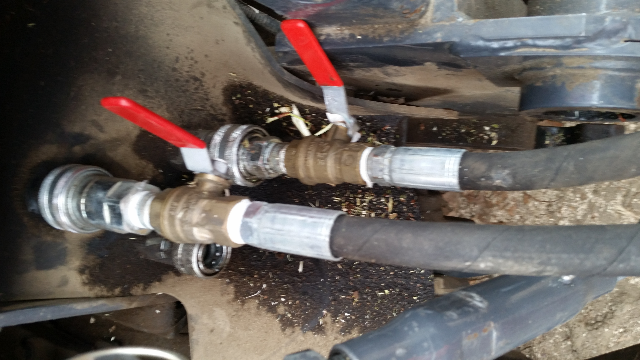

I may have been miss informed but I remember asking the dealer what the swing port put out and the main port put out and was told the same gpm number for both. But if swing valve is putting out less, I am going to switch mine because it doesn't take that much to make the rollers go and I no longer need the high flow to run the log splitter. As far as running the 3pt hitch while connected I ended up putting a ball valve after the quick connect fitting, works great. I did the unplugging and reconnecting hydro lines for a while and thought that there had to be a better way, and that's what I came up with.
   / M59 Discussion Thread #340
Sorry it's sideways.
