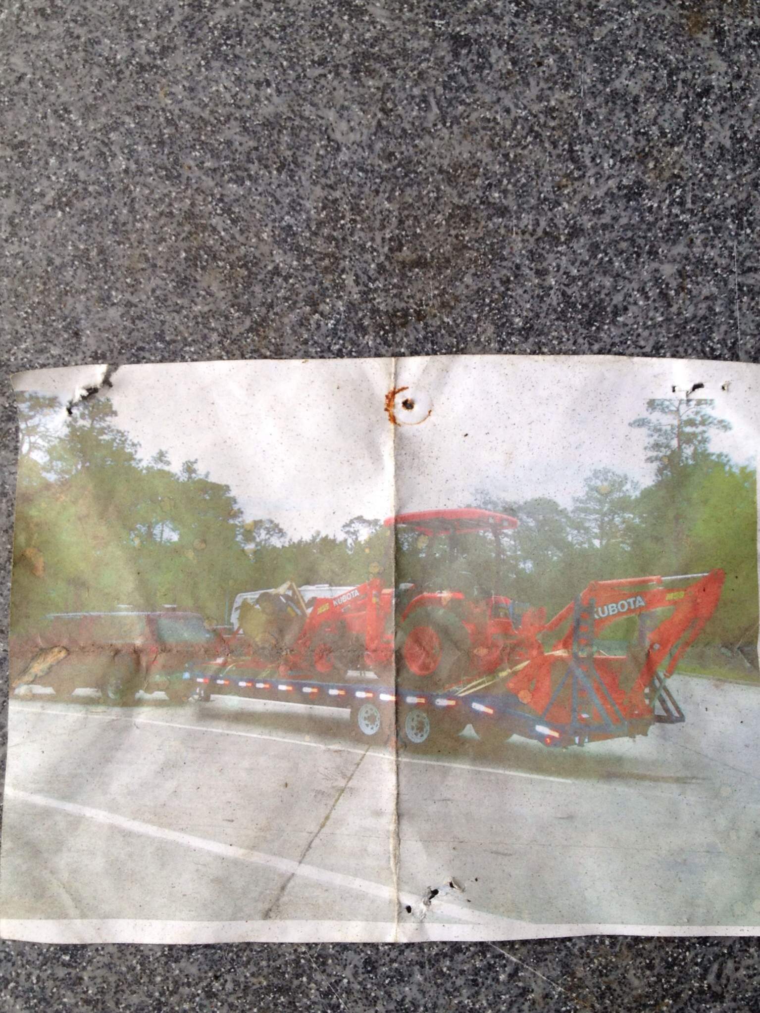

Bought it there and hauled it back, spend a few months down south during winter

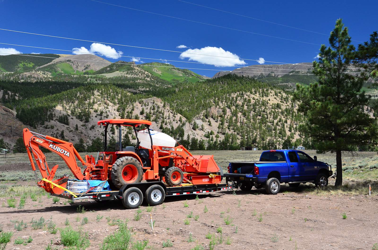

I haul mine back and forth between New Mexico and Colorado twice a year - tractor is up on the ranch, used mainly for construction currently, during the summer season. It is about 700 miles each way, and includes some serious mountain passes (I have even taken it over Slumgullion twice; that is up to 9% grade or so!). This is with a Dodge Ram 2500 with some mods, towing a 14K PJ bumper pull trailer. I think I have an old picture in my account, will try to attach below.

Can you give some details on your trailer? It looks really nice.

I think I've said this before, but that is a beautiful picture, really nice setup!
(aside from the power lines) :D
What size trailer are most of you guys with M59's using? Length/weight rating.

I wouldn't go with anything less than a 14K, two 7K axles with brakes on both axles.
Mine is 22' and this works fine, although I might as well have gone with 24'. The
bumper pull is harder to load and hook up, but saves some weight and leaves the truck
bed free for storage. For shorter trips a gooseneck would be more convenient.
I am thinking of getting a 16' GN dump trailer for hauling gravel etc., and this would
probably also work to haul the M59, although with the rear gates open and the loader
up on the GN. Another thing: these low profile trailers are 83" wide but the M59 loader
bucket is 84" or a bit more - if the trailer has rails installed, it has to sit up on the rails.
(The power lines are annoying all right, but that is the barn site at the edge of the
meadow where the picture is taken. Further back up the mountain, the power lines
are history. :) )
