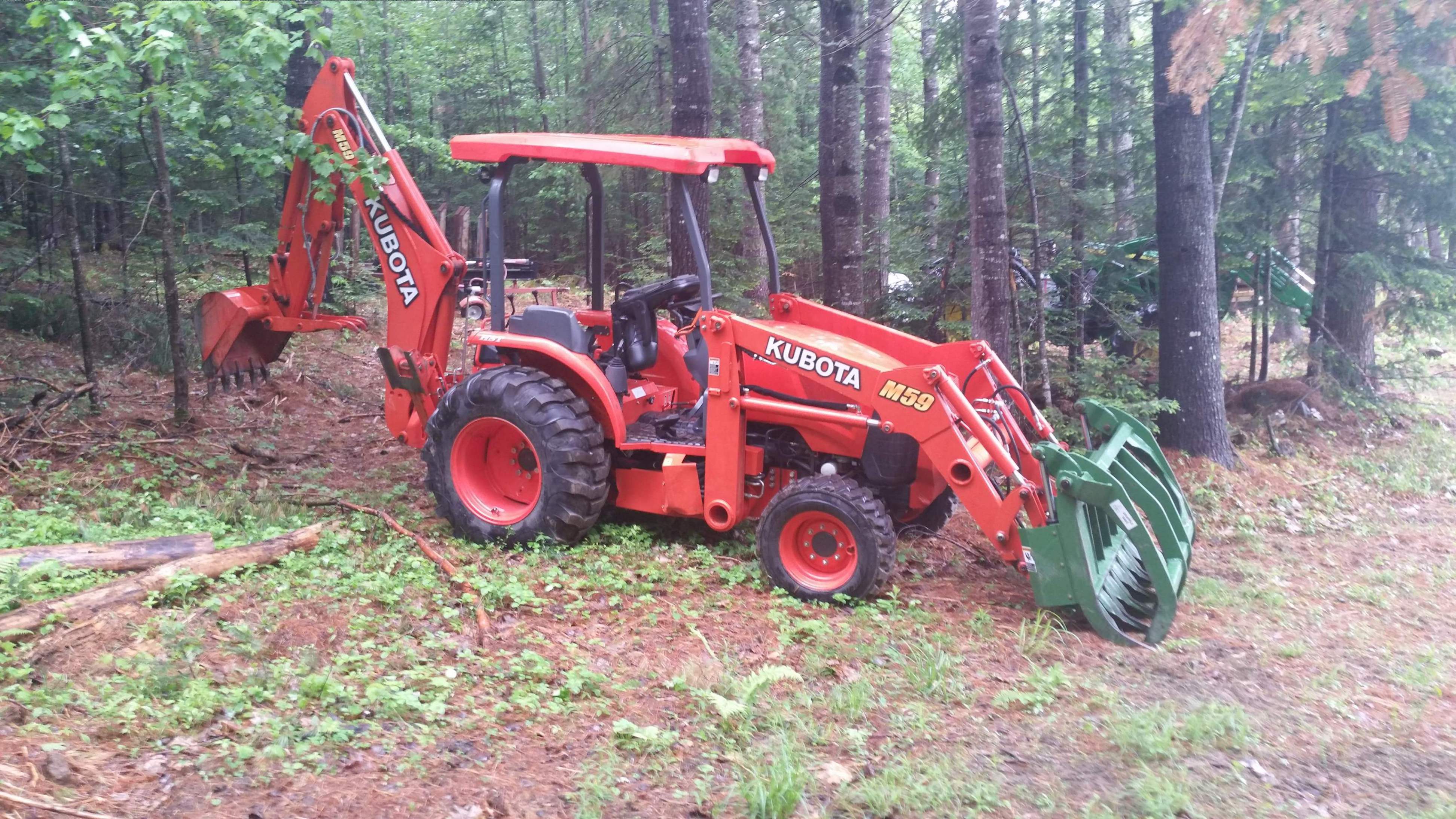

...AND FOR GOD SAKES, WOULD YOU GUYS POST SOME MORE DAM GRAPPLE PICTURES WITH THE M59! :D
I know, Not an action shot but a good looking pic. :) Don't know why it's upside down?

David, thanks for the pic! Love seeing new ones posted of the M59, and especially grapples :D
Here ya go...

Piston, thanks for the flip.
David

And an action shot, Upside down again. How do I FIX this?
David

Xfaxman, Thank you for the flip. The pic's look fine in the pic. folder of my computer. Only happens when I load them here.
David

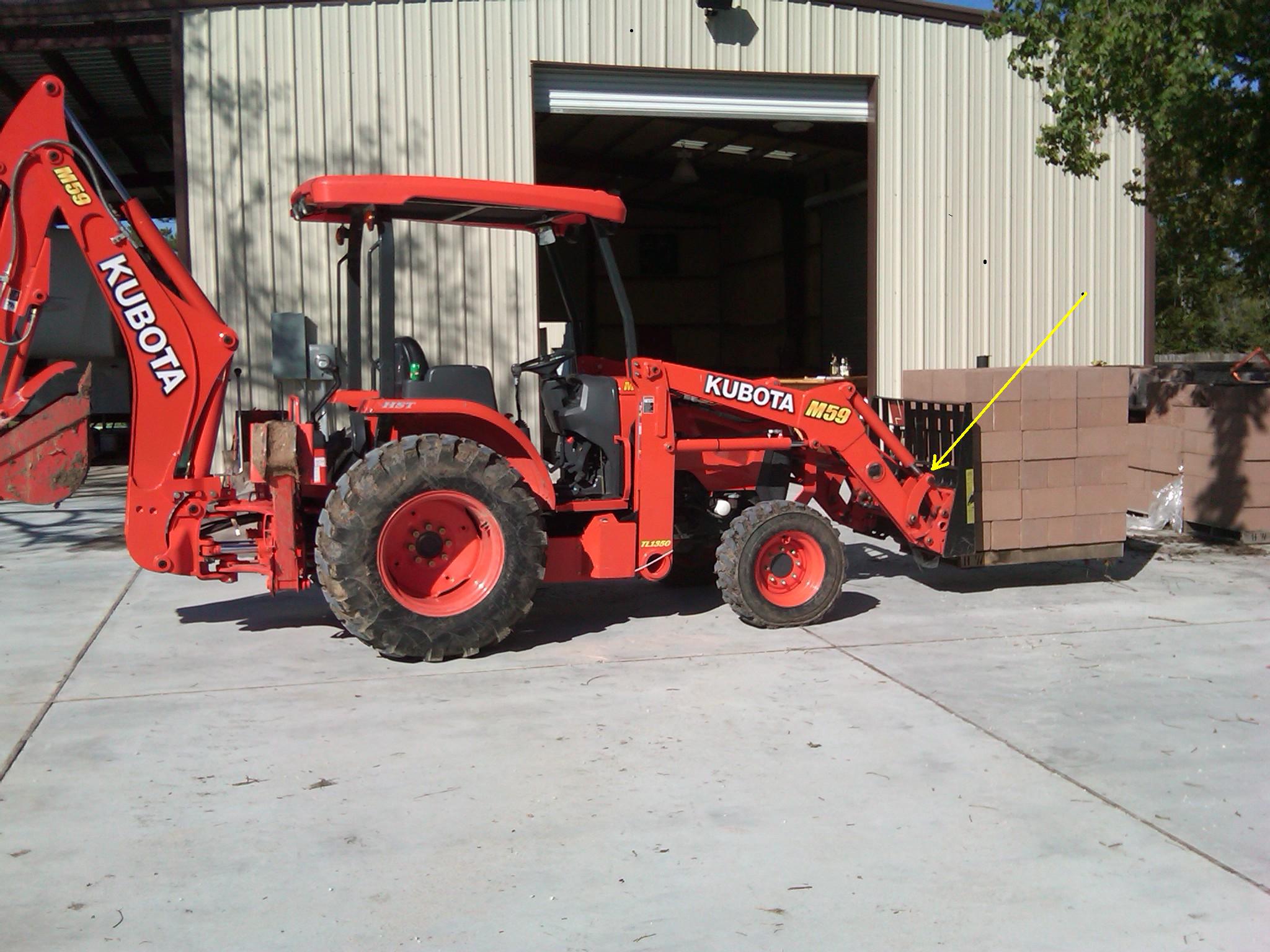

Another action shot. Just Call me wrong-side-up:)
David

No problem, we'll take what we can get :)
Thanks for posting pics!
