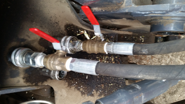

I may have been miss informed but I remember asking the dealer what the swing port put out and the main port put out and was told the same gpm number for both.
The L45 is rated, 11.8GPM main pump and 6.6 GPM on the swing pump, M59 I believe is 16.1 and 9.5 GPM. The ball valve is a good idea, but you only need the valve on the supply port for the lift to be able to operate. Something else to keep in mind is that you could combine the main and swing pump outputs if you ever needed it for a high flow attachment. One caution is that the relief pressure for the swing pump is lower than the main so you should add a check valve in the swing line to block higher pressure back to the swing pump.

Any idea what the max design working pressure the ball valves can sustain?
Very good point. I missed that. Those valves look like low pressure valves for water service and if so natem should replace or remove them immediately. You could get away with it on the return side if you always remember to shut off the supply side first. You need a valve on the supply side rated for 3000 psi or more working pressure. Like Ultrarunner posted or this lower cost one here:
3/4" NPT CARBON STEEL 5800 PSI BALL VALVE

I'll have to get one of them, I have not had any problems with it yet. But I don't think I'll push it.

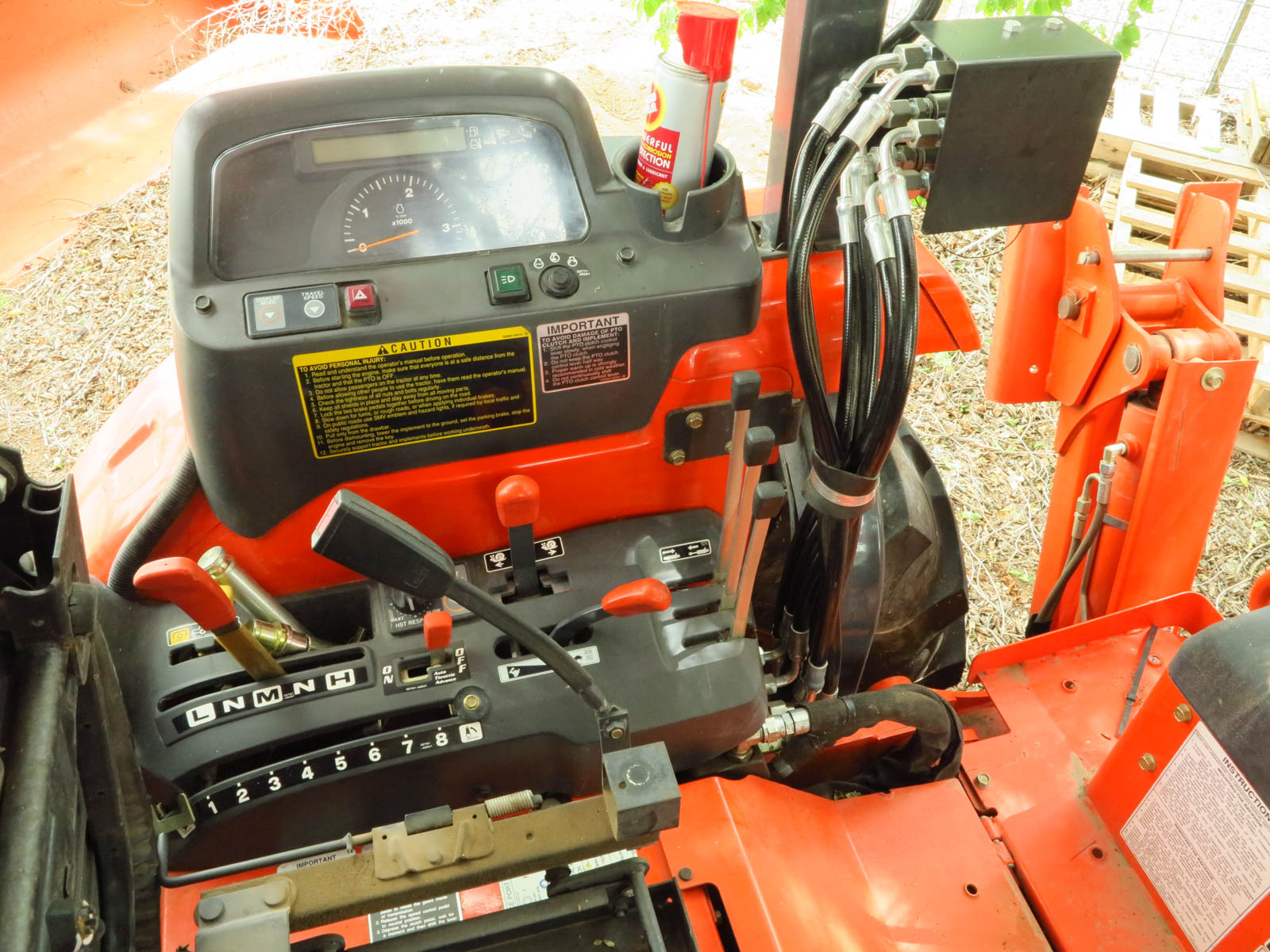

Can you take a photo of your spool layout from the drivers seat?

Sure, here you go. This is with the seat folded forward. The console area is pretty cramped so it would be challenging to get a good install without buying the Kubota kit. I had to cut out the slots in the console a bit at the back to make room for the spool levers. The spools have a detent/hold position on one side.
