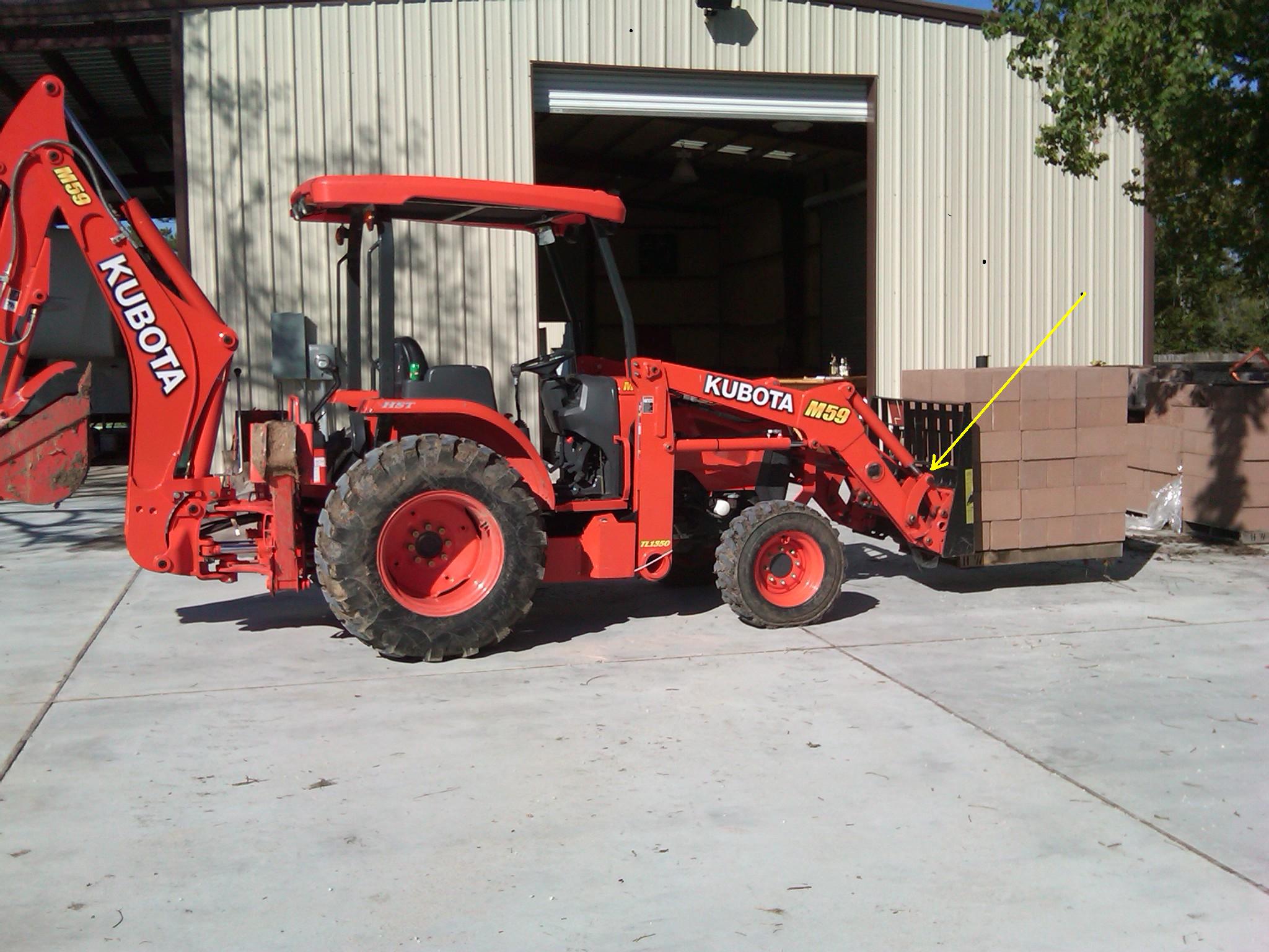

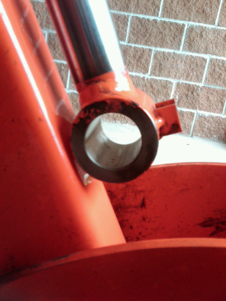

The bushings where the bucket curl cylinder connects to the quick attach plate.
Good news its only 16.00 a side so I am replacing both of them.
Click on little picture and arrow points to them.
Oh yeah, Chuck, I just checked my bushings and I have lots of play in them too! 400 hrs. Did you replace them yet?
Yes, seems when they replaced the FEL curl cylinder they forgot to install the bushing:confused:.. I Managed to install the new one in place without using a press, the other side had very little wear so I did not replace it.
