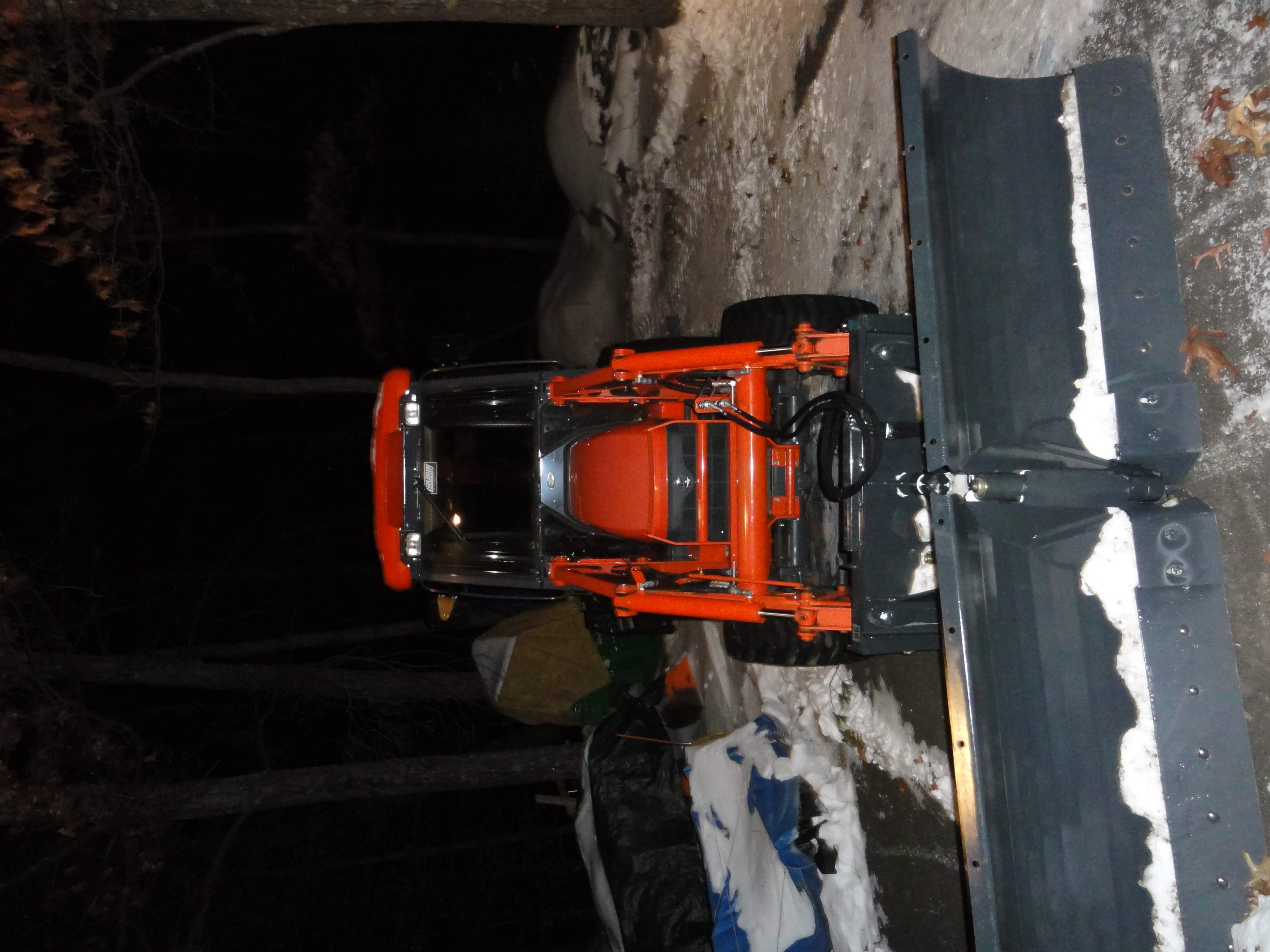

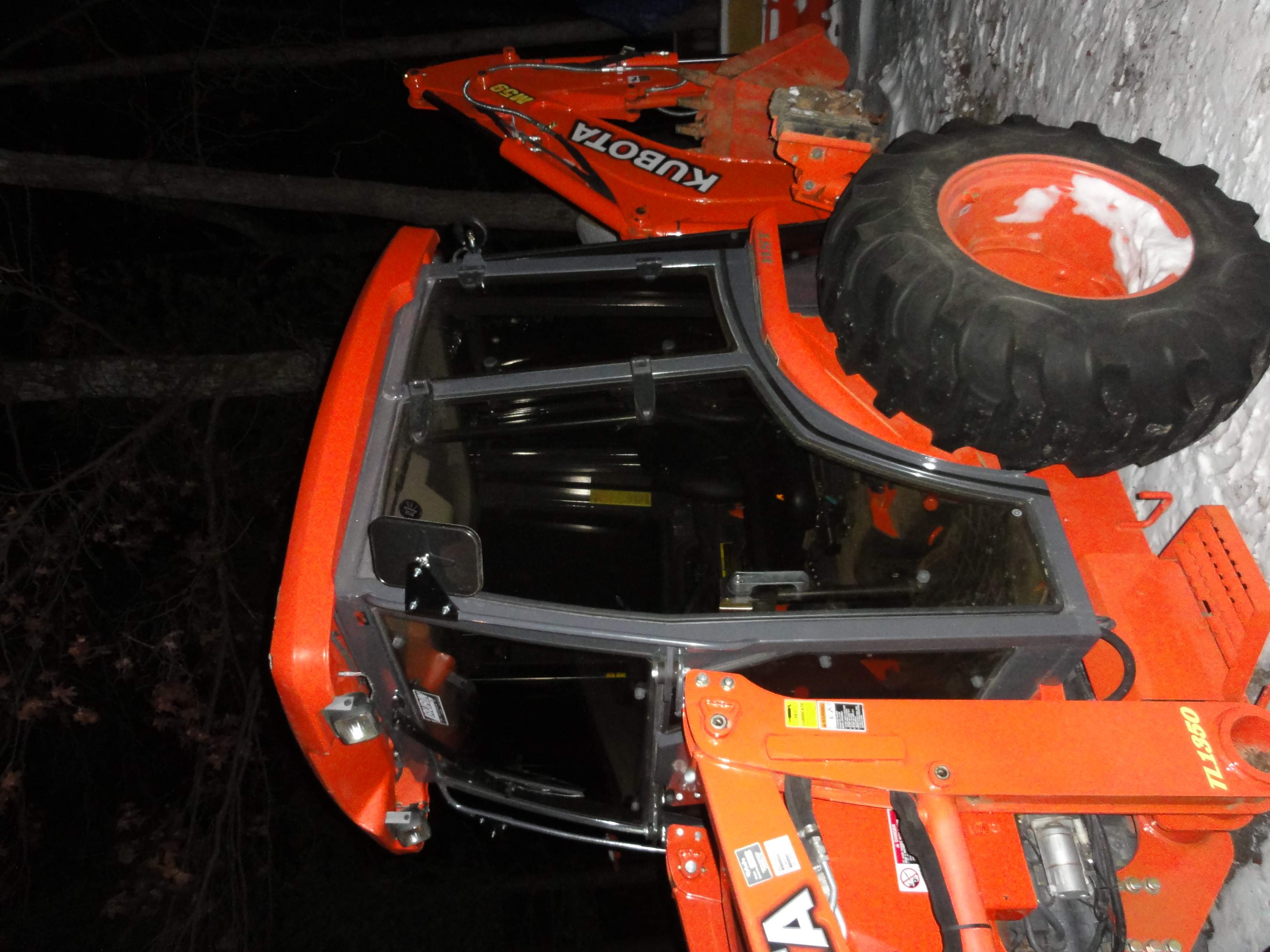

Added the cab last year. With all the snow and hours of plowing in comfort it has been worth it. Only down side has been the noise level. Higher than I would expect or like.

Just curious where you got the cab? I've been debating about trying to rig my own but I can imagine what it would look like. The one you have looks good!

PM me and I'll send the assembly dwgs from the factory used for installation. They provide reasonable detail.
