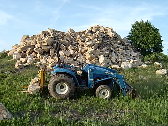

You think you have rocks? Ha. This was about 3 years ago. I have finished moving the pile and have to finish up the wall and other rock projects so I can move in the topsoil and get some grass growing. I just got my toothbar from markham and love it.

rockquarry:
By the way nice looking kid (great to give a sense of scale :rolleyes:). I am not usually impressed by much, but your TC29 did a great job on your rock pile :D. Now I think I "need" to buy a 3PH carryall to help me move even more rocks. I think you "rock" :cool:. My wife would probably not agree :eek:! Jay :)
