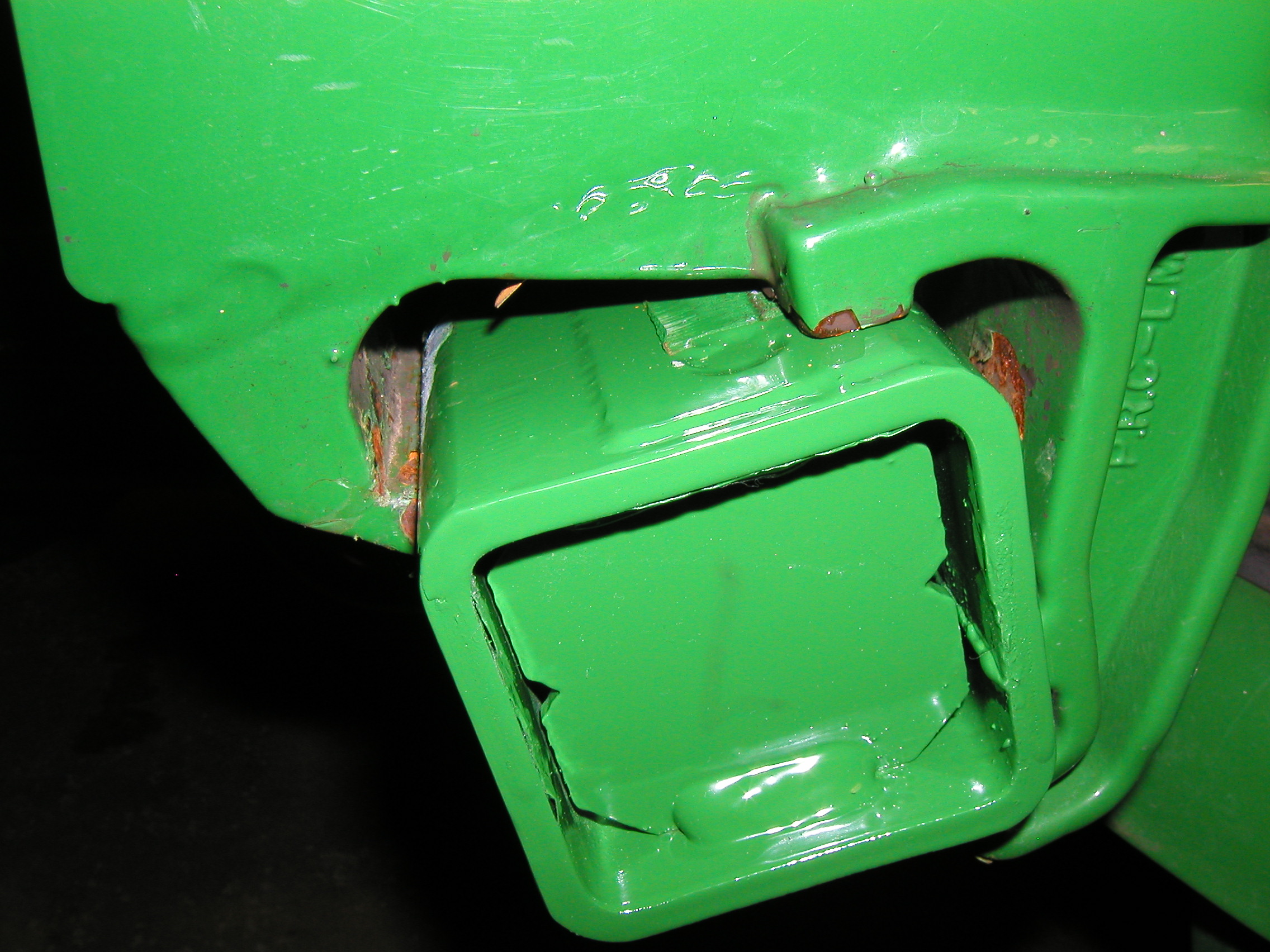

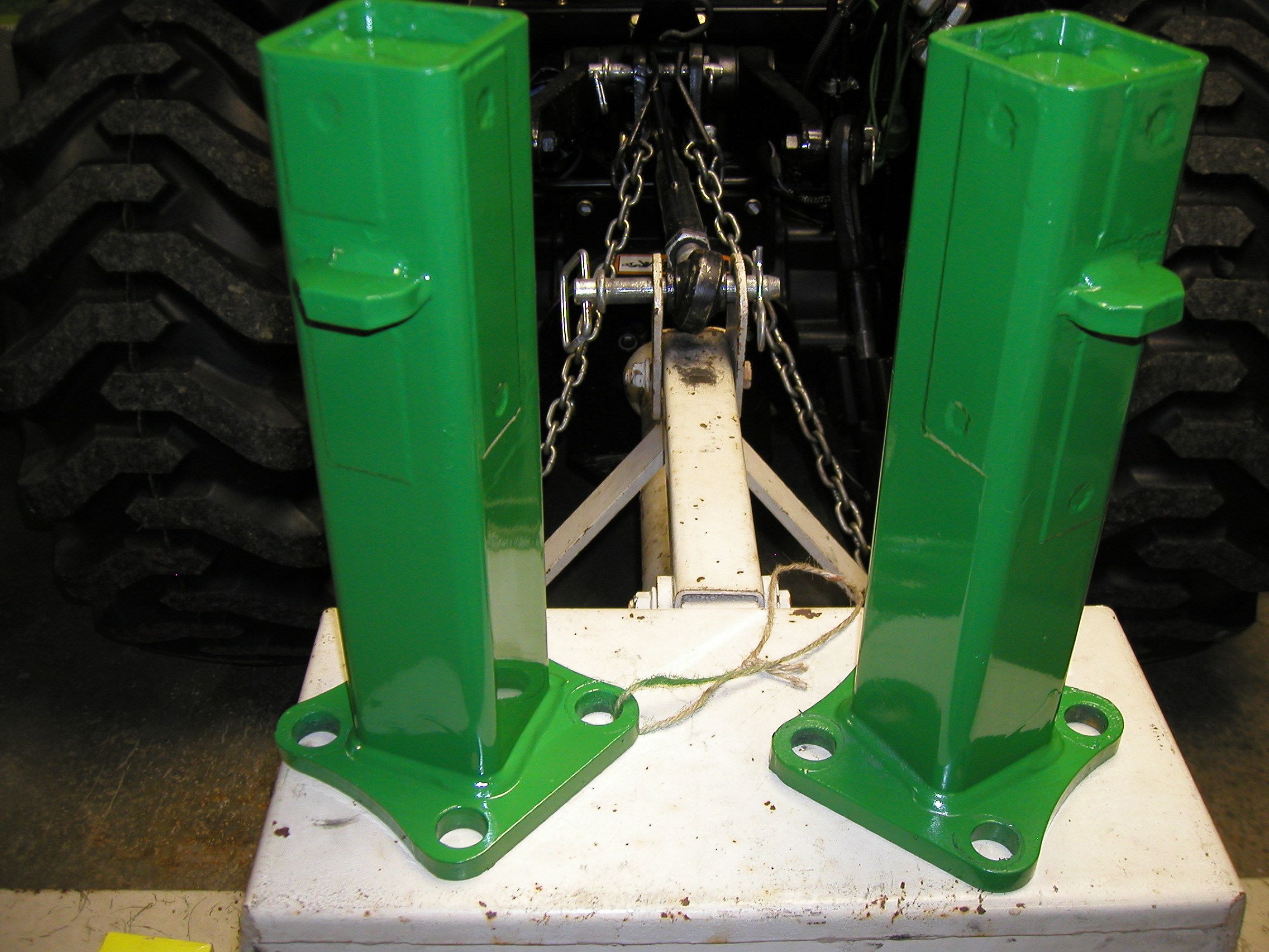

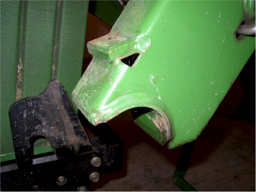

Last winter I rigged a "temporary" shim to tighten up the loader masts. They were really getting sloppy. It worked great and got me through snowplowing.

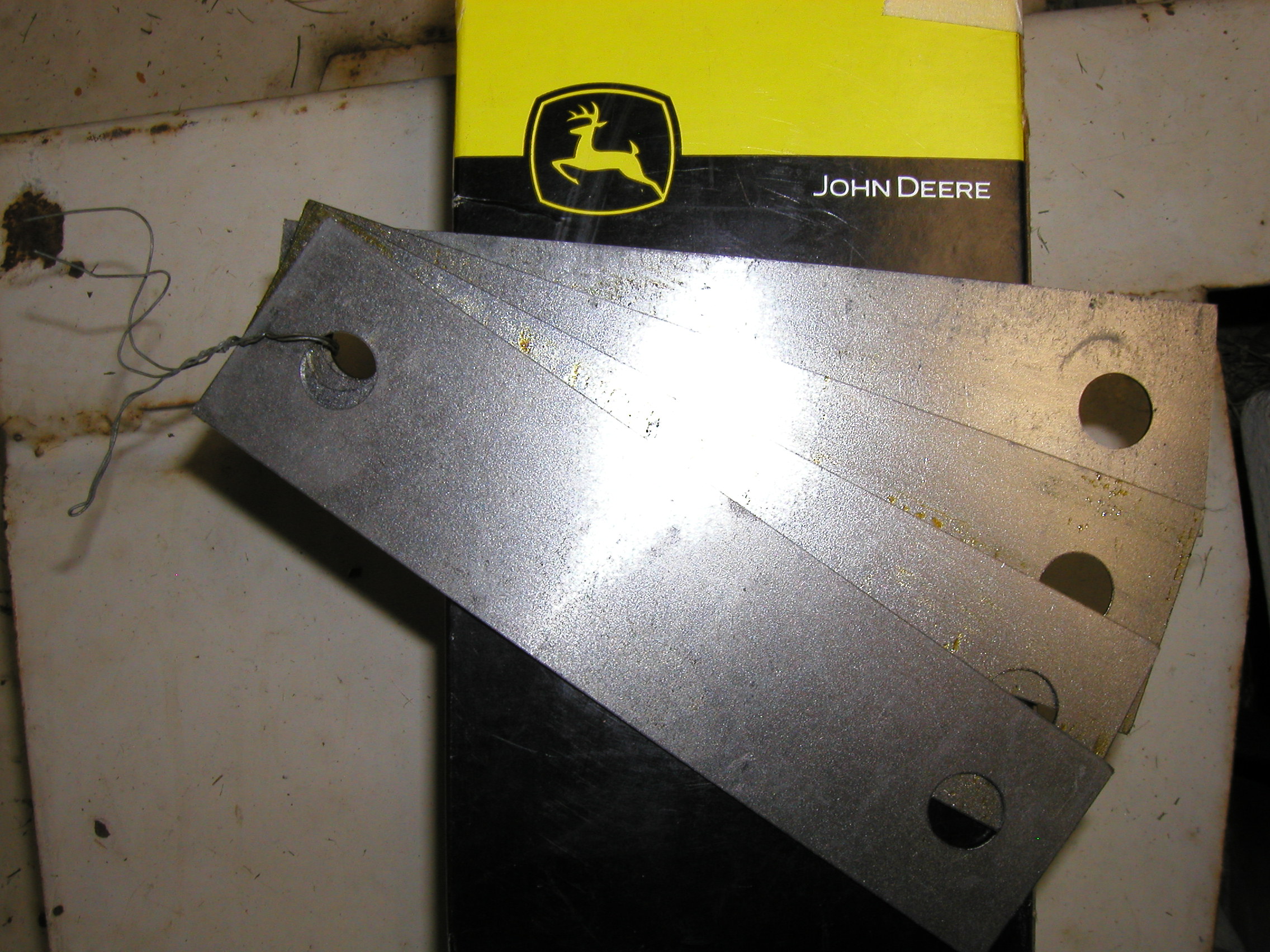

Well I finally got around to ordering the shim kit from Deere. +- $35.00.
I would NOT reccomend it to you due to the high price. Yes it works fine, but I'm sure you can find flat stock much cheaper elsewhere.
The kit comes with 12 shims and directions.
I removed the brackets and a friend of mine welded the shims on.
It did a fine job of tightening up the loader. Like new.:cool:

The short reply is yes you can do that provided that you wind up with a flat wear surface that will not distort the "claws" that contact the square mounting tube.
Also, I found that the contact areas are close to the "round" edge. The directions from Deere have you welding the shims just off the "round".
After installation, the "claws" are only contacting the very edge of the shim.
I'll post some pics of the shims with the loader mounted.
/ Loose 430 Loader shim fix

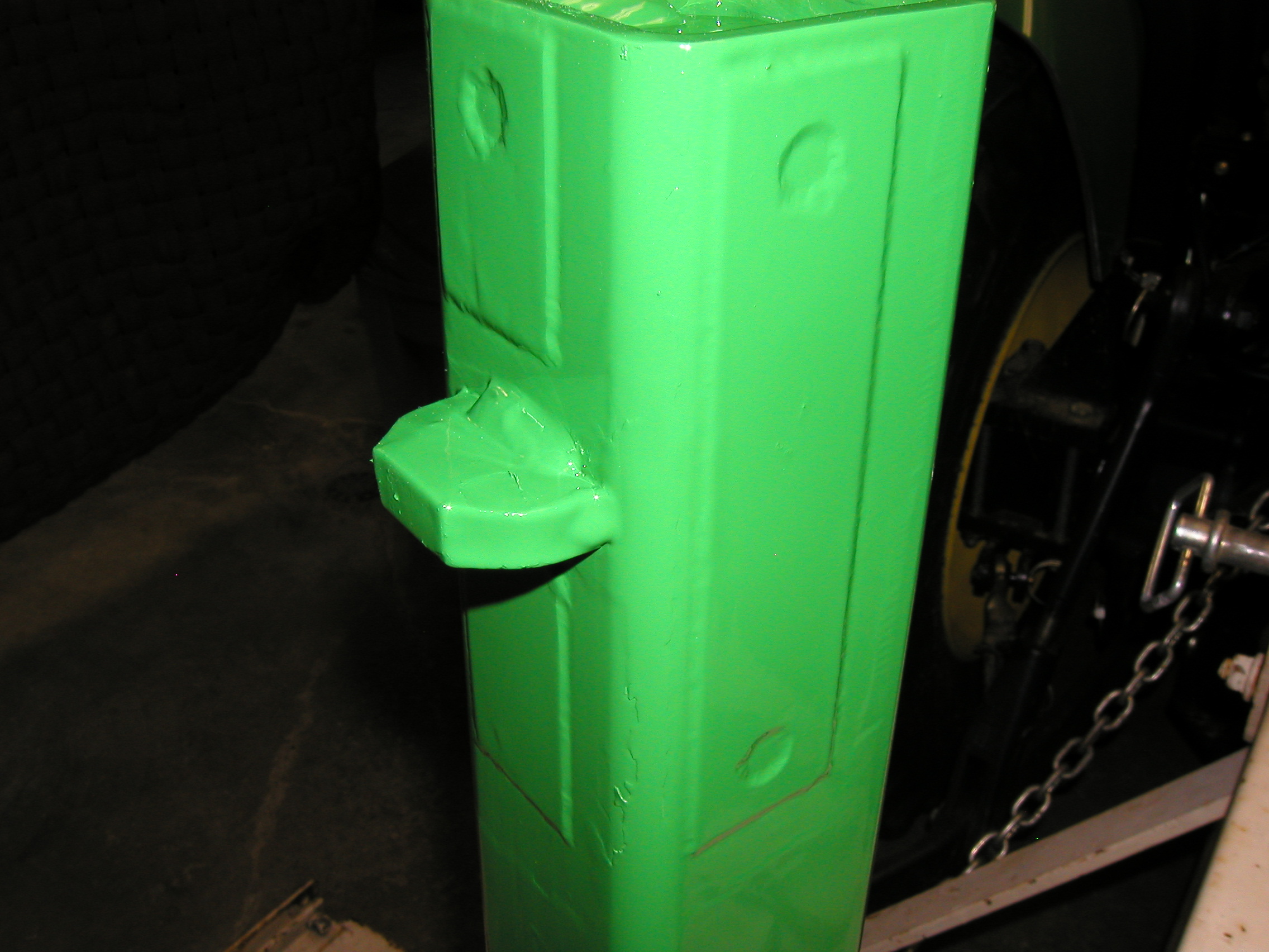

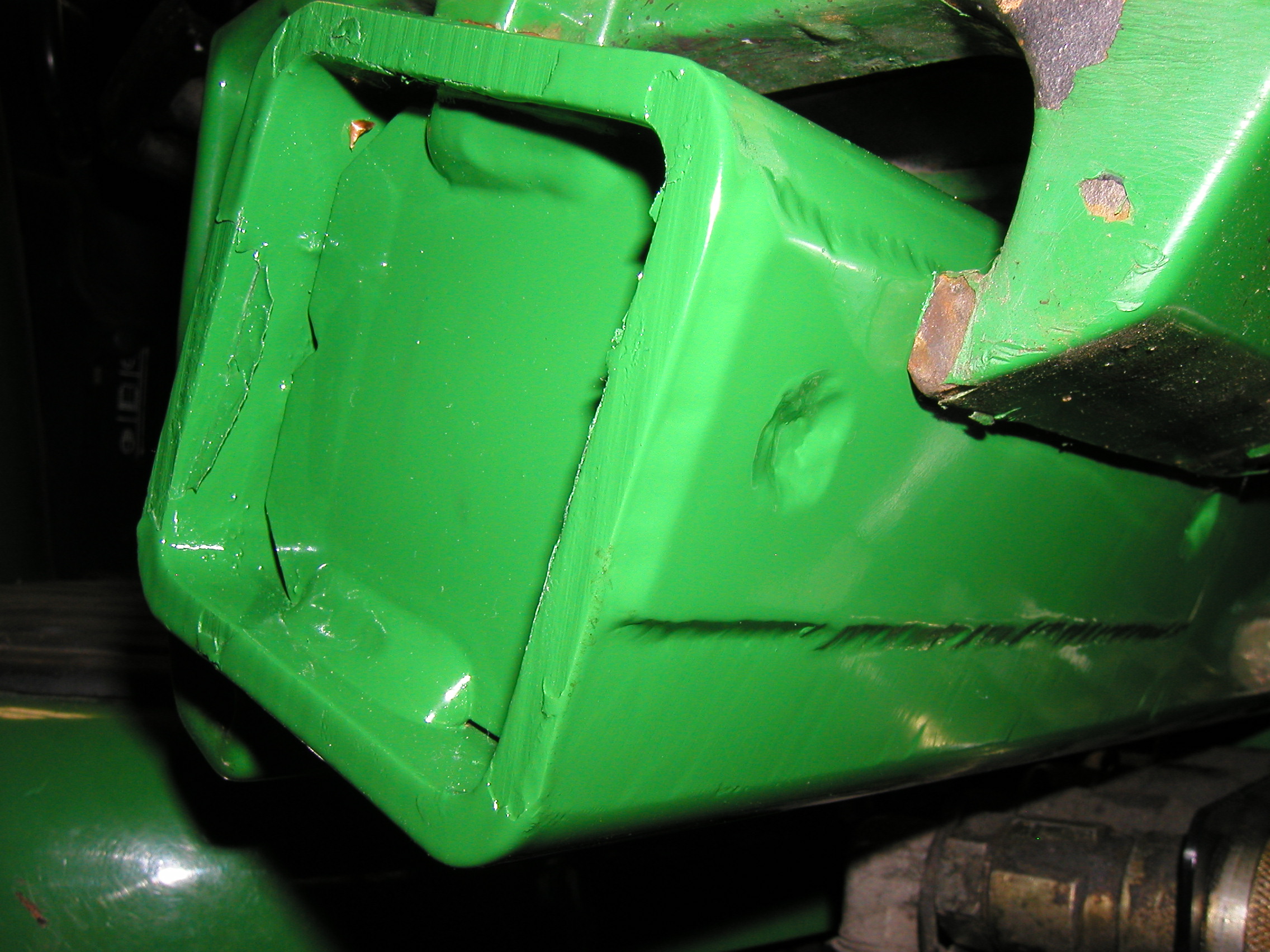

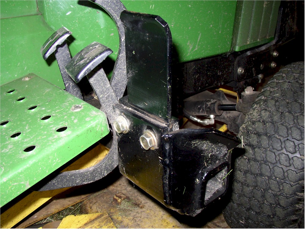

Here are a few pics of how the shims are ,by direction, in relation to the bearing surfaces.
If I were to do it again I would position the shims closer to the "round" edge.
It took about 450 hrs. to get to the point of having to fix the sloppiness problem. I use the loader a lot plus snowplowing with a Curtis [plow attached to the loader arms.
What type of gap have you got between the "claw" and the square bracket?

dfk- I'm sure your fix will work fine. If your bead is too much, just grind it down.
mjn- I had about 1/8" gap and it was enough to make me worry about the mounting brackets slipping off! It doesn't sound like much, but it has a big effect way out at the other end.
jd4300- Yes I was suprised at how quickly it got to that point. I thought it was just me because no one else seemed to comment on it.

There are three contact points on each side.
Five of mine took one shim and one took two.
Only two points looked obviously worn with a visible gap.
I figured that they were all worn to some degree so I didn't want to throw the whole thing out of kilter by just shimming the two points that looked like they needed it.
I don't know if this makes sense but it worked.:confused2:

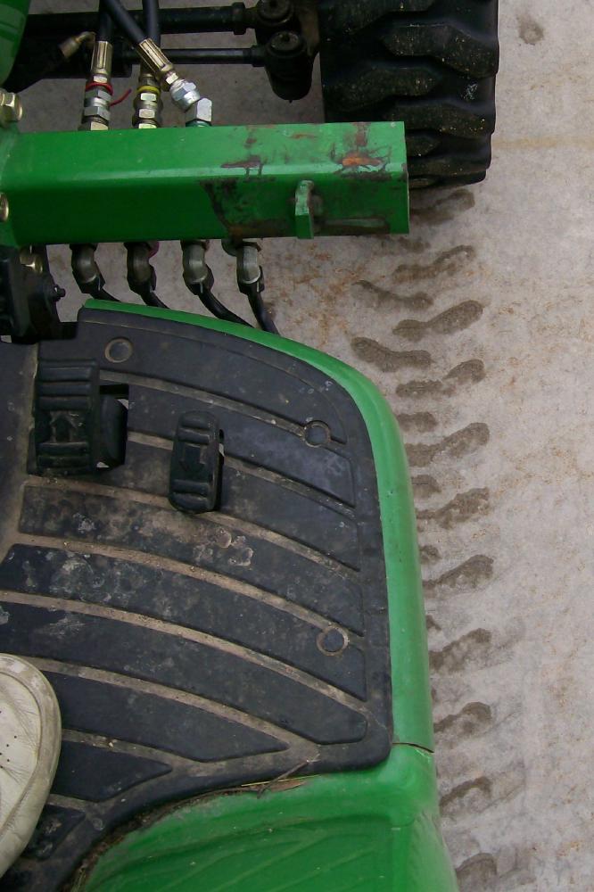

Good thread.
I haven't noticed wear on my 430 FEL, but will surely make note that it can happen.

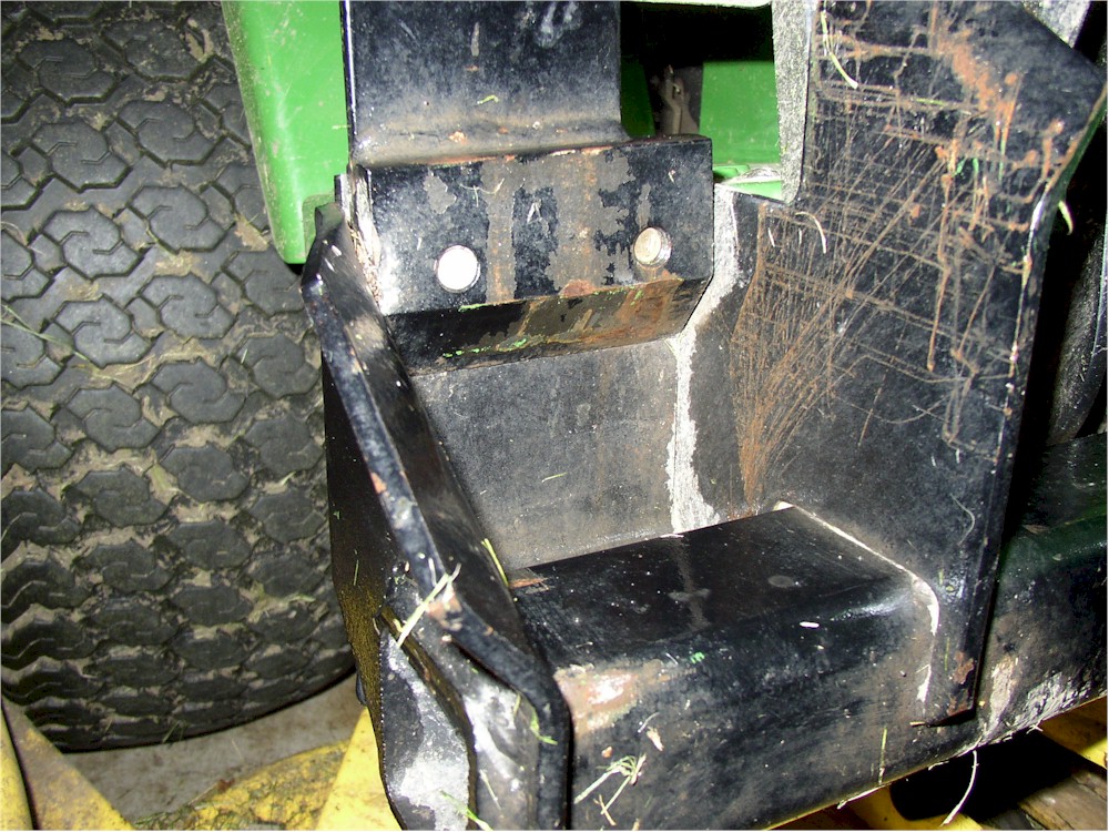

When new FEL's are setup, there are adjustments to make a snug fit. (to the length of the forward 430 stand that latches onto the front weight bar).
Are these adjustments made before the shims are put in place, or after? or not made at all? Seems they would be an integral part of "filling the gap" process.
If I were to weld shims on the loader stubs, my wing plow bracket wouldn't slide on. :(
But I don't notice any excessive wear to these stubs. (no paint after 12 years, and 500 hours).

Welcome. The shim kit on JD Parts is 'Item 17' in the picture. Apparently it's meant to be used at the front of the loader; but some guys weld them onto the frame stubs where the masts attach. For the ~$40 Deere charges for the kit, I can buy a lot of sheet metal scraps. I used mild steel, and I'm assuming the JD shims are too. Other guys run a weld bead where it needs shimming on the stub, then grind it down till it cures the problem.
