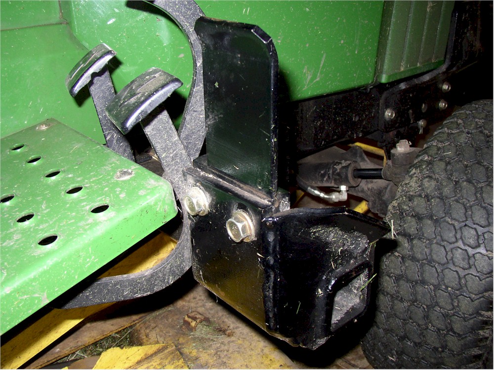

Welcome. The shim kit on JD Parts is 'Item 17' in the picture. Apparently it's meant to be used at the front of the loader; but some guys weld them onto the frame stubs where the masts attach. For the ~$40 Deere charges for the kit, I can buy a lot of sheet metal scraps. I used mild steel, and I'm assuming the JD shims are too. Other guys run a weld bead where it needs shimming on the stub, then grind it down till it cures the problem.
Now this (item #17) seems to be a different "shim" kit than was being discussed in the thread.
Or did I miss something?
Where these shims go is where the JD 430 loader adjustments are made to keep the FEL on tight. It is not clear what these shims do in the image of the parts and their location. But may be for attaching the same FEL to different tractor models.
/ Loose 430 Loader shim fix #23

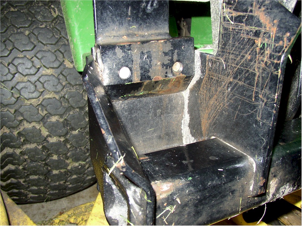

If you look at the pictures in the first post, you can see where the OP plug welded the shims at the OEM bolt holes.
My guess for the front location of the shims is to account for manufacturing variations in an effort to keep the loader within a specific width tolerance.
Either JD has alternate instructions in the kit for welding them to the mast mounts as shown in the first post, or the OP said "What the heck, I'll weld them on the mast mounts." Again, just guessing on my part.

Were these shims supposed to go on the loader posts, or on the arms at the adjustment location near the front weight bracket as shown by the pic of mjncad?
Wondering what the directions said. ?? Whatever works tho. :)
#25
The directions that came with the shims show them being welded onto the square mounting brackets that support the "towers" just as I described in the beginning of this post.
That is exactly how I installed them and it worked fine. Tightened it right up.
I made NO adjustments to the components in the front of the loader whatsoever.
