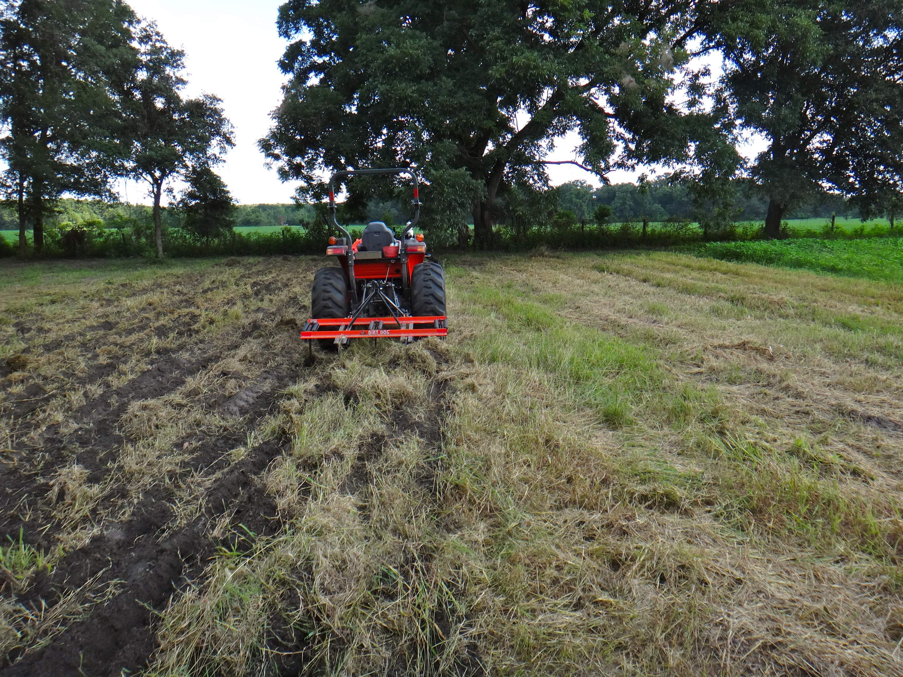

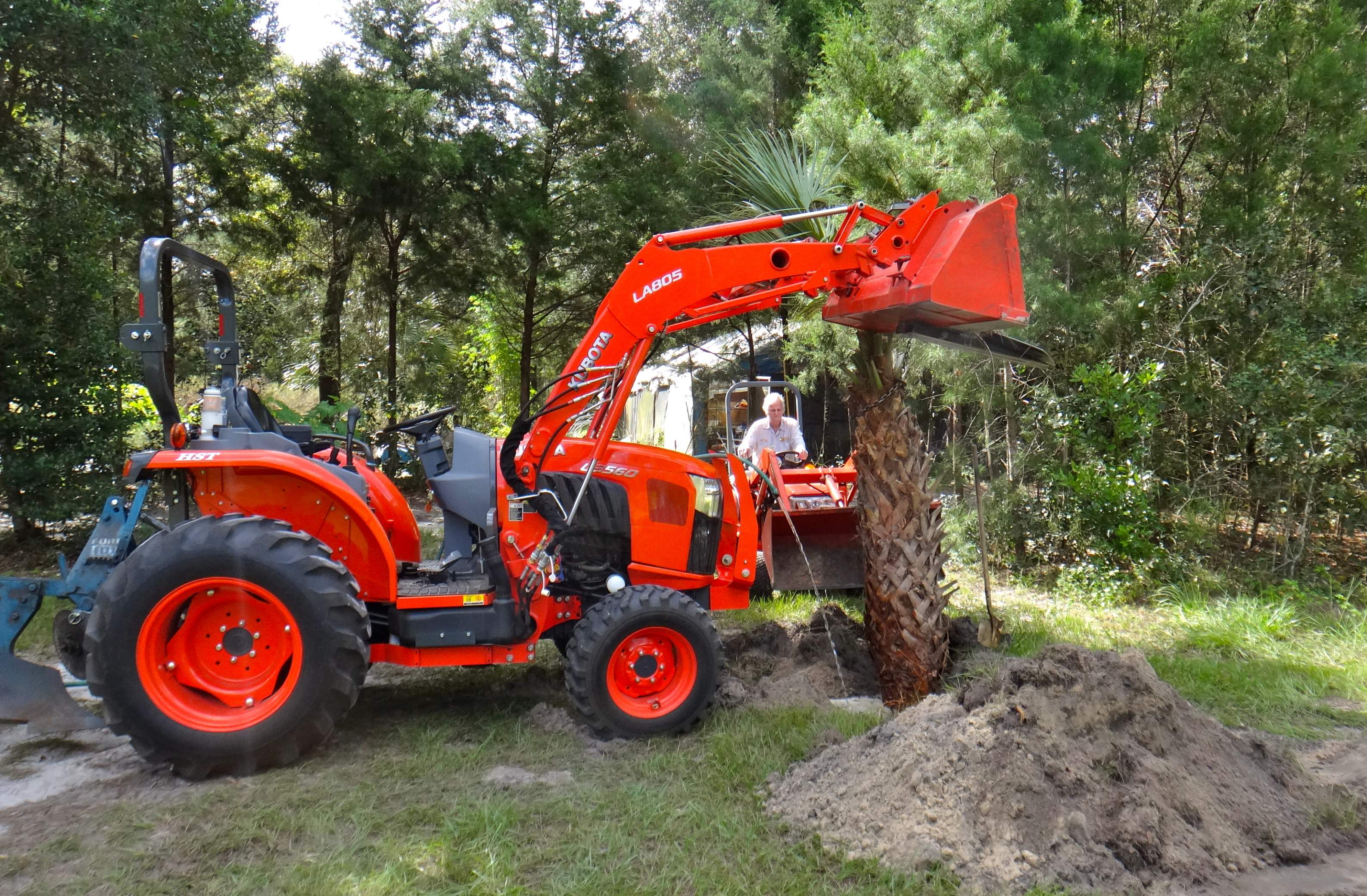

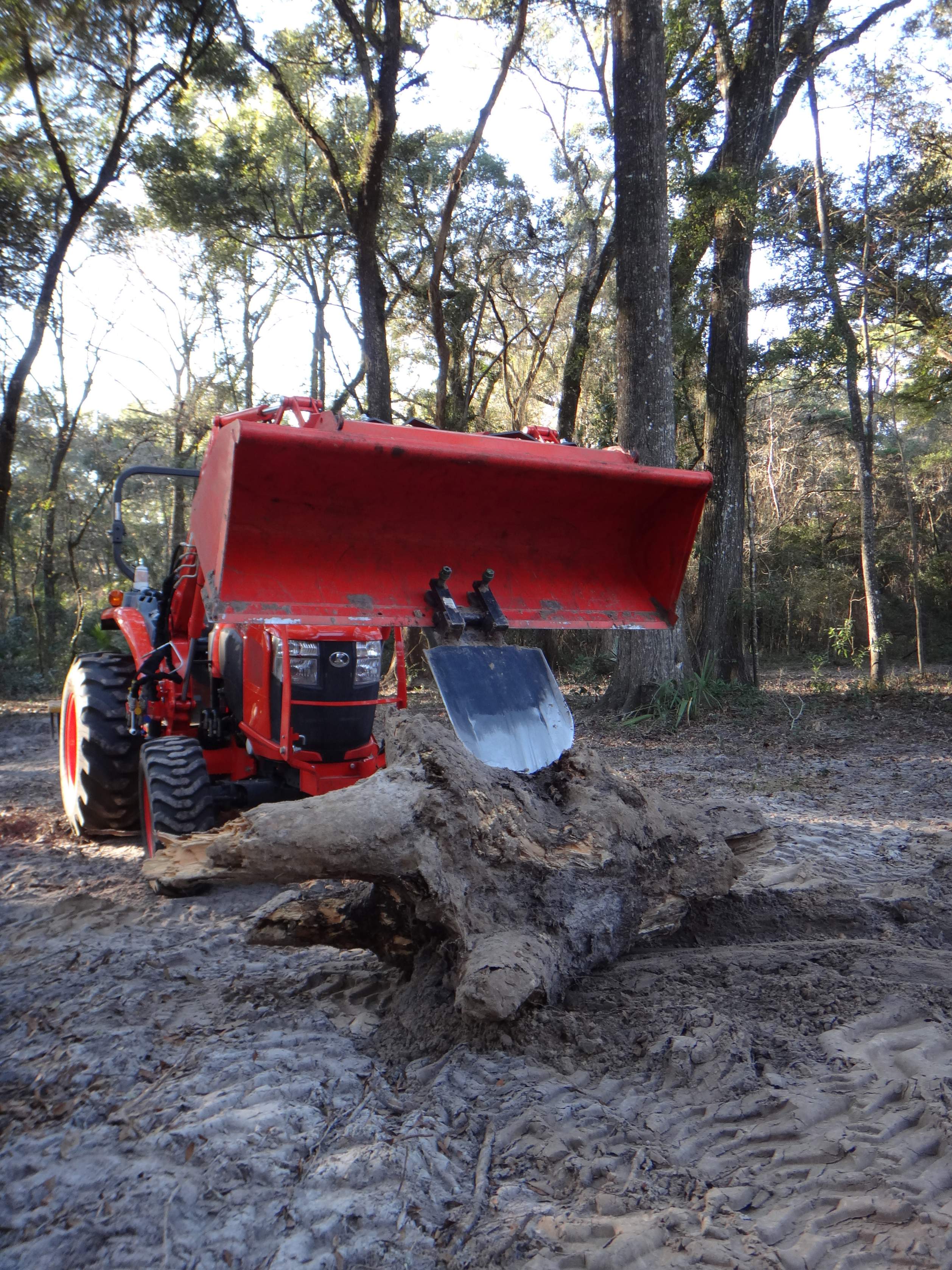

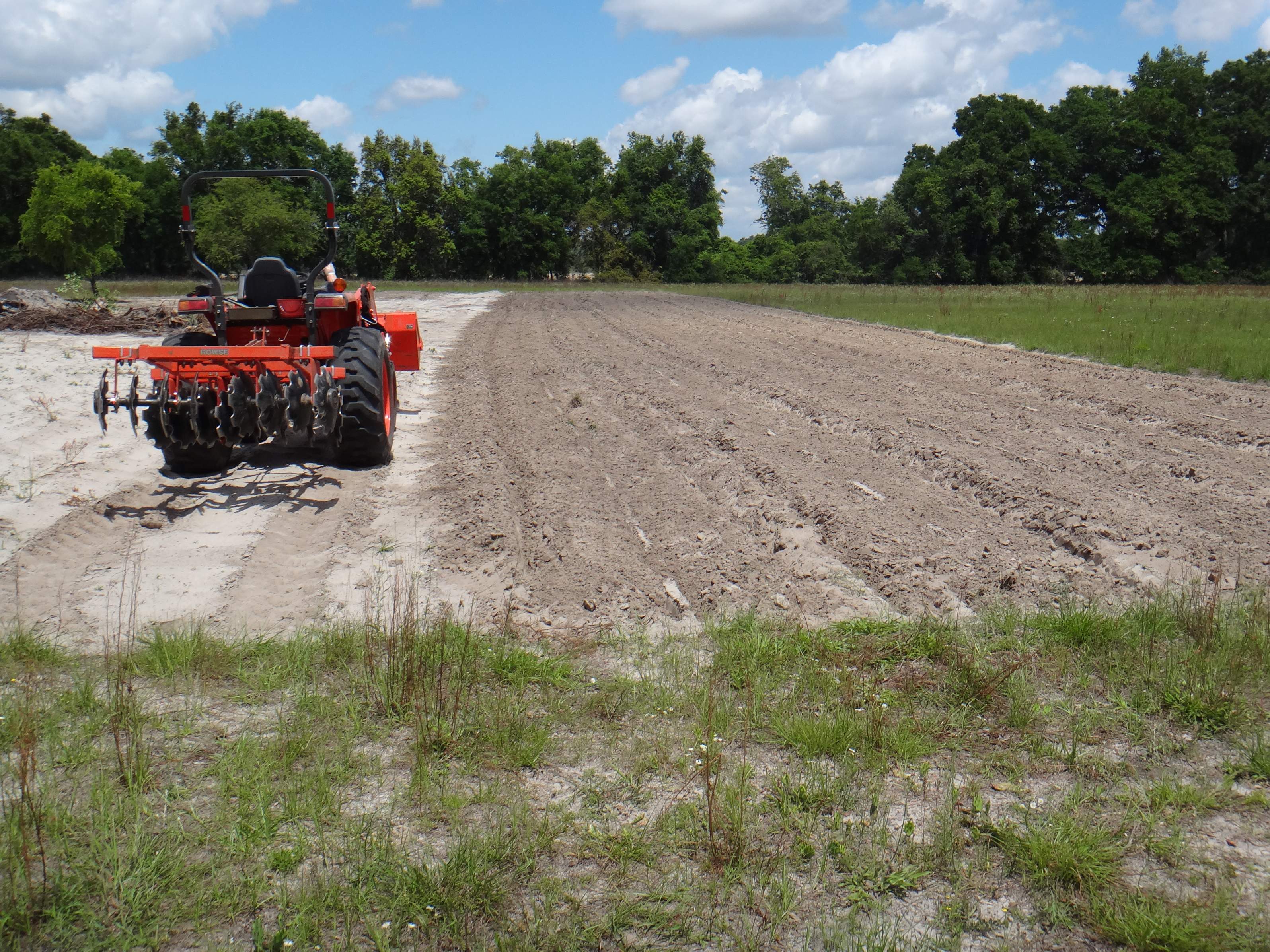

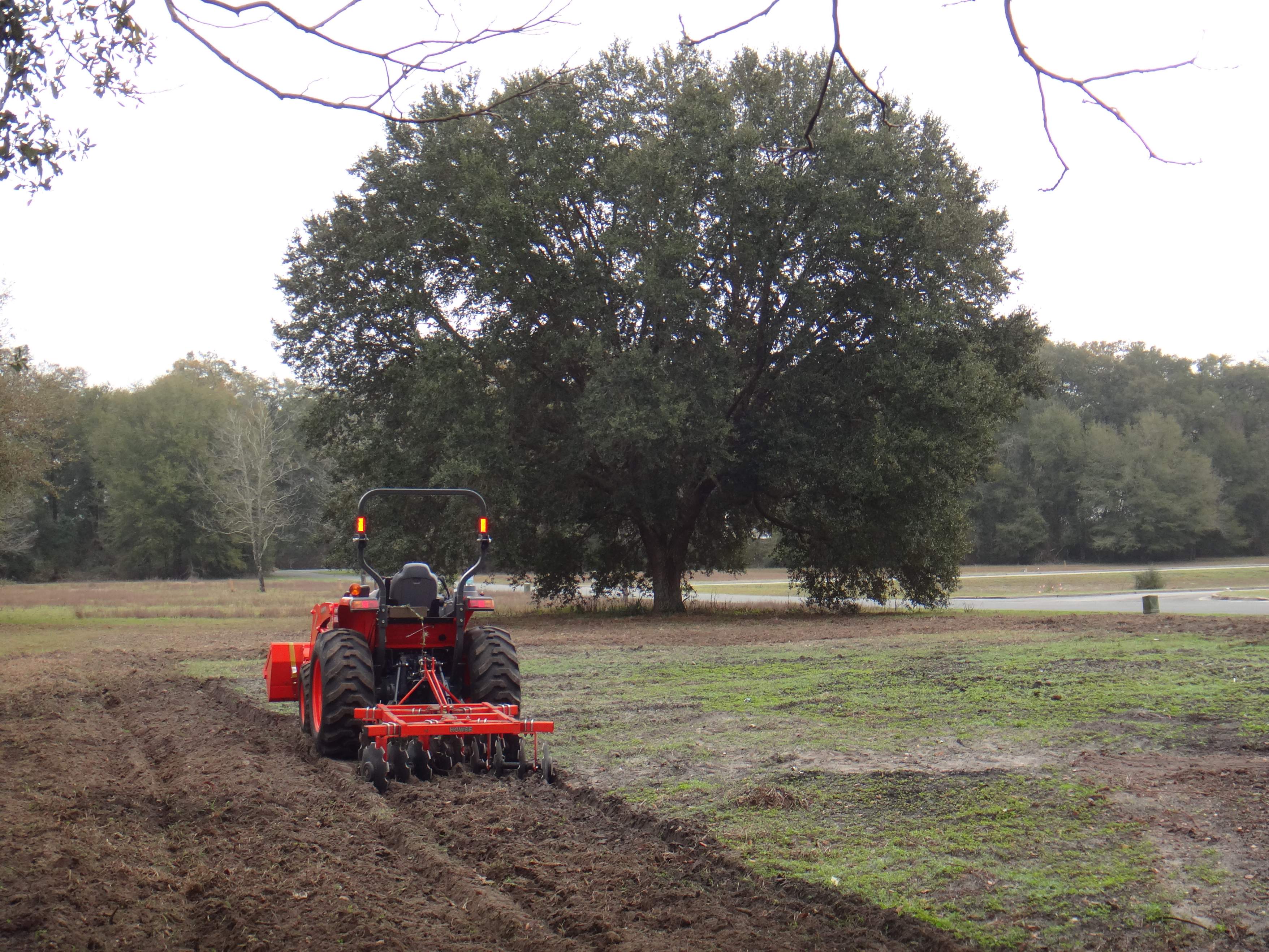

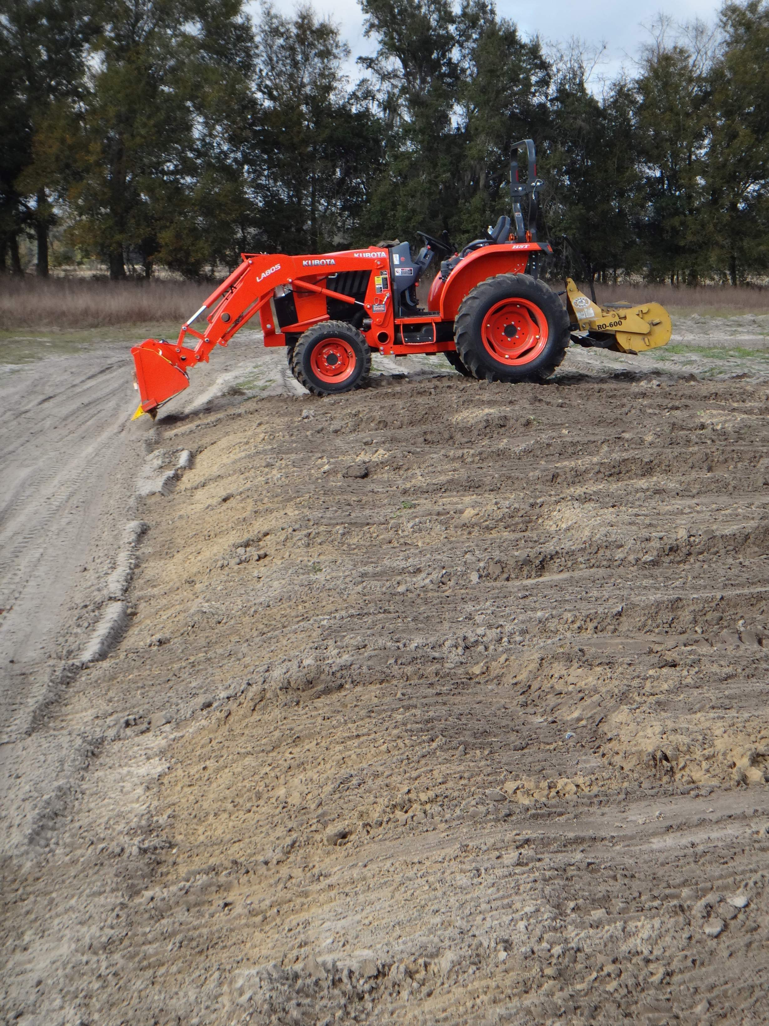

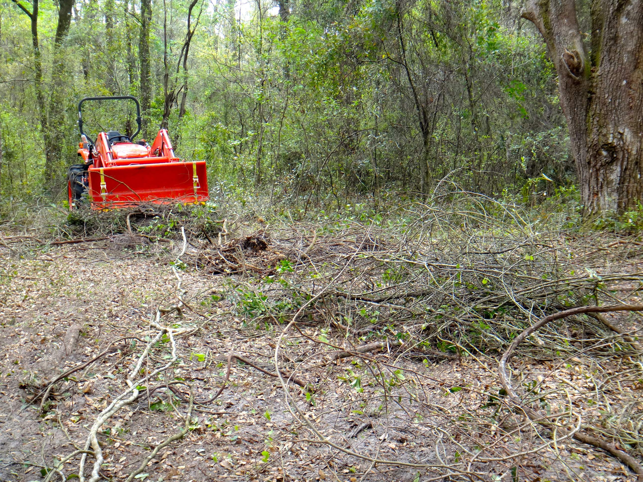

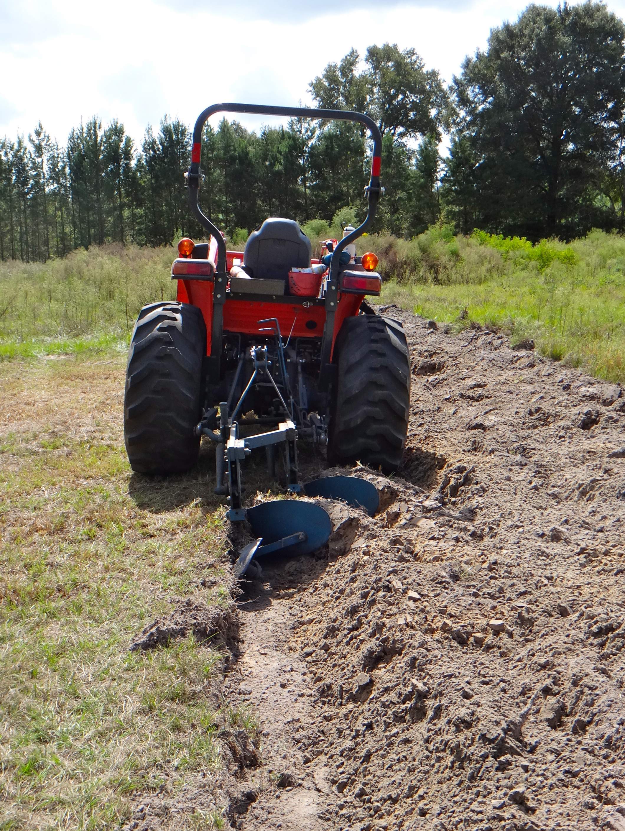

What you will miss, downsizing to a Kubota L3301, is weight.
Consider, instead, one of the Kubota "Grand L" models. I have the smallest in the series, an L3560. It is slightly larger than the L3301 but much heavier. The extra weight is thicker steel. The HST+ transmission on the Grand L models is a huge improvement over the three speed HST transmission on all other tractor brands and models. Pinned stabilizers and telescoping Lower Links make mounting heavy implements relatively easy.
I am age 69. I know where you are coming from. Factor in all the options. Factor in our age. Grand L the best way to (compact) tractor.
