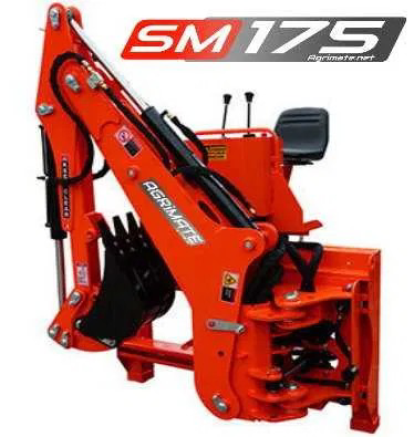

I Will like to have not really a front loader but one of these:

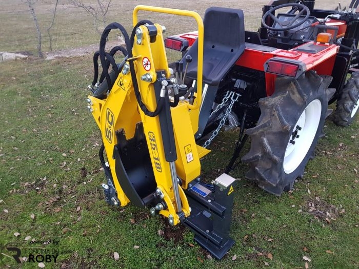

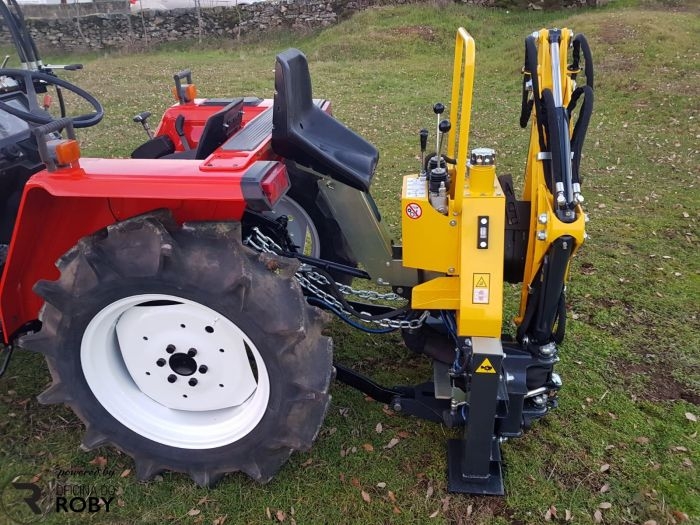

if you do go the backhoe route get a sunframe made up, they put a LOT of load on the superstructure otherwise.
/ Looking to buy a tractor #11
The backhoes sold here are often undersized (mostly run at lower hydraulic pressure) for the tractor they are going to, plus they tie the backhoe to other points of the tractor in addiction to the 3 pt.

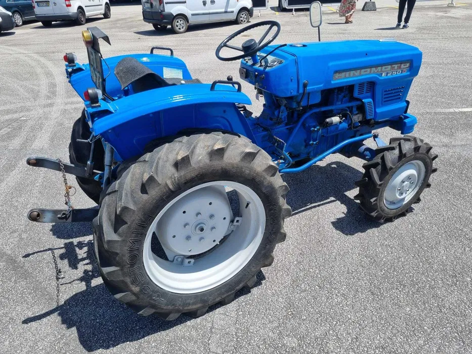

Today i'm gonna see this:
The price is nice enough (5700€), it has a licence plate and i have researched and there is a portuguese representative, so spares should not be a problem, i guess. The low price makes room for the backhoe and some other implements i would need.
But i need to know first if it has power steering. Other than that, everything seems to fit. One mistrust: the paint shines like new... i guess it was repainted. I hope it wasn't a quick fix to cover rust...

I can see the steering linkage on the right side in the picture and doesn't have power steering. Also, the Hinomoto Portugal representatives are only for the new models which are actually TYM tractors painted in orange.
The older Hinomotos are very hard to find parts, unfortunately.

Congrats on the new tractor. It's made by LS but you can get parts both ways, either New Holland or LS if you end up needing.
For the backhoe, you won't be able to find that model "in this side of the pond" and it's only meant for the US market. You'll find something very similar though, just different brand and paint.
If you can, I suggest that you get one with sideshift on the boom if you can find it for that size of tractor. This is a great feature because you can then often the arm one way or the other so you don't have to dig with the arm right in front of you, blocking the view. It also allows you to dig close to a wall. Plus, you can ofset it to one sid and fold the arm all the way, making for very compact setup.
Either way, you'll need counterweights for the front of the tractor.
