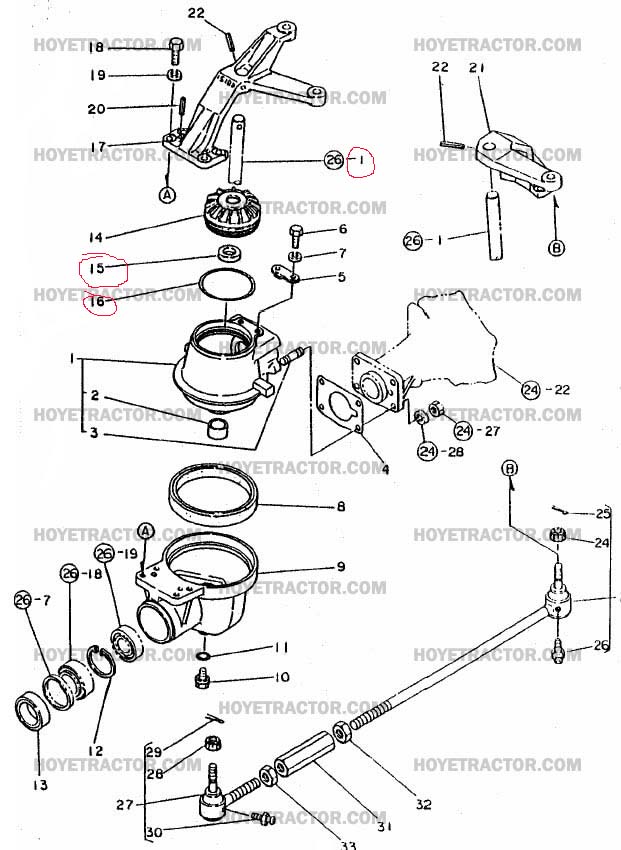

In advance - thanks so much! I have found a 1510d with a Koyker 80 FEL, finish mower, rake, box blade and 6x12 single axle trailer for $5500. Owner has had for 5 years and put 100hrs on it, previous to that 50hrs by another and previous to that reconditioned (???). No Rops. It also has a problem when driving the wheel will get violently jerked as if a front wheel is locking up and then frees up again. Any advice on buy or pass? Does wheel situation sound like the possibility of large problems or an indication of what I can expect in the next 100hrs? Unsure of where reconditioned. Also, is Yanmar the way to go for first tractor? Lots of scary reconditioning stories. Thanks to all.
/ looking into buying a 151d - help! #2
The 1510D is a GREAT little tractor and I would heartily recommend it for a first tractor. The power shift is fantastic and the power is more than adequate. The refurbished aspect can be scary, but since this has a few hours after the refurbishing, it may be alright--check it out carefully and you should be alright.
The wheel locking up could be a real big and expensive problem. While the front end is not too difficult to work on, it does contain some parts that are costly. You can search under my name to find a thread where I had the front hubs apart. It sounds to me like there may be something broken in the one front hub. I would not drive it until I found out what and why. You really do not want to ruin more than is already broken. Something is not right for sure.
Possibility--if it were really cold it could have been a chunk of ice (water) in the hub? Push the top of the tire with your knee, if you get movement or a "clunk" sound it indicates looseness in the bearings and a potential problem.
I would not pass on it, but I would want to know what was causing the problem. You could drain the oil from that hub and see if you can find anything with a magnet.

First, the design is as simple as it looks. A countershaft in the transmission has a sliding gear/dog to engage the front driveshaft. Open differentials front and rear with a diff lock for rear only. The front hubs are complex but the effect is the same as front half-shafts driving the wheels. Take a look at the front hub diagrams on Hoyetractor .com. From what I read here, the hubs are likely the problem.

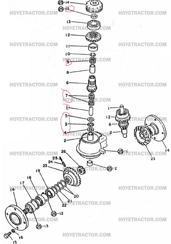

I agree that it is probably in the hub on the side that pulls. You should be able to feel it if the front wheels are off the ground and just spin the wheel by hand. It is something broken or a bit if debris floating in there. I would not drive it any more at all until it is fixed. It would be a shame to damage something else in the hub.
From the parts diagram it is hard to tell what is going on if you have not had it apart and can therefore put things together, because there is an internal and an external diagram of the hubs. I will post them here as taken from Hoye's site. Basically you have a center king pin on which rides a gear cluster. This gear cluster transfers the power from the axle gear to the hub gear and provides a final gear reduction. If you pull the center pin (it is attached to the steering arm with a spring roll pin, the steering arm attaches to the bottom half of the hub with 4 bolts), then the lower half of the hub will drop. You can take the whole hub off by dropping the tie rod (and the steering rod if on left side) and 4 nuts on the axle housing.

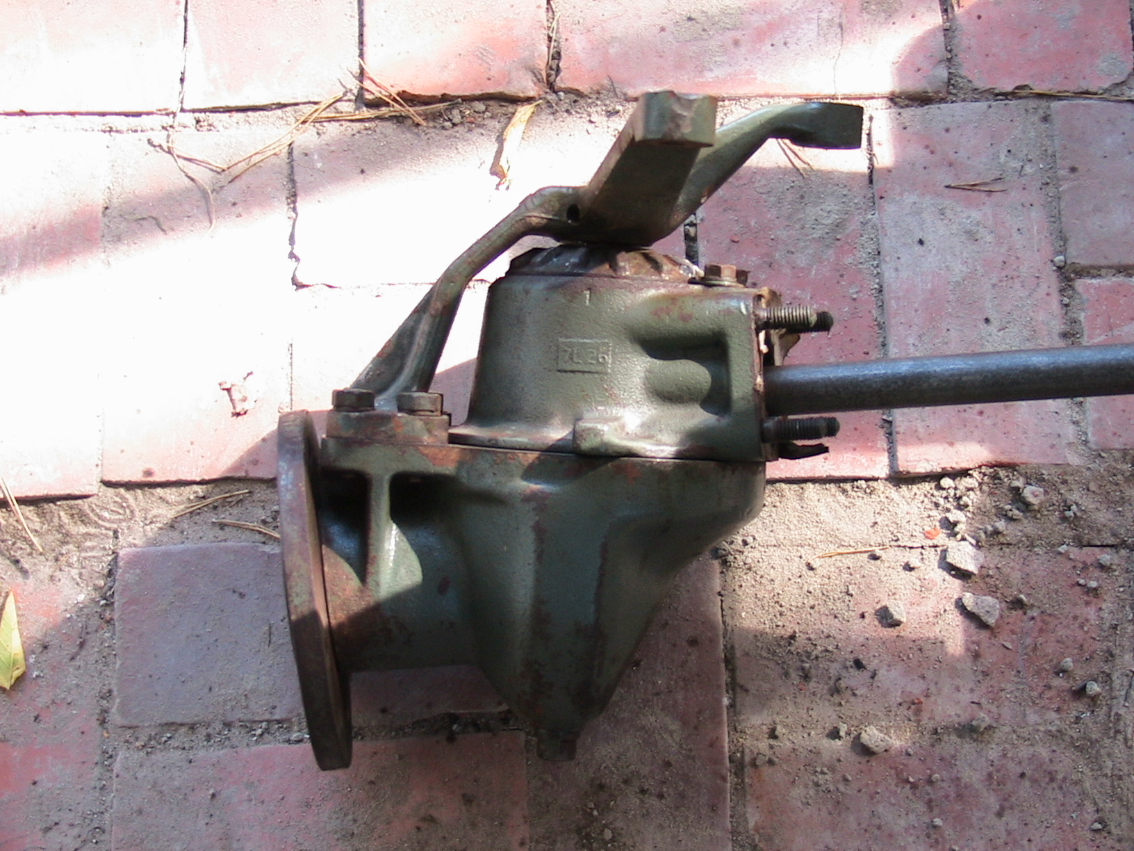

I had mine all apart this past summer to replace the seals in the spindle shaft and tighten the spindle bearings. I will post pics of the parts, but you can read about it here.
One of the dealers that posts on this forum was talking about getting one of the internal gears made(#6 in the internal diagram). You can get all the pieces in this hub but they are not cheap.:eek:
One more thing. Do not expect help with rebuilding the hub from the service manual of the US equivalent 186D, as the front axle on the 1510D is very different.

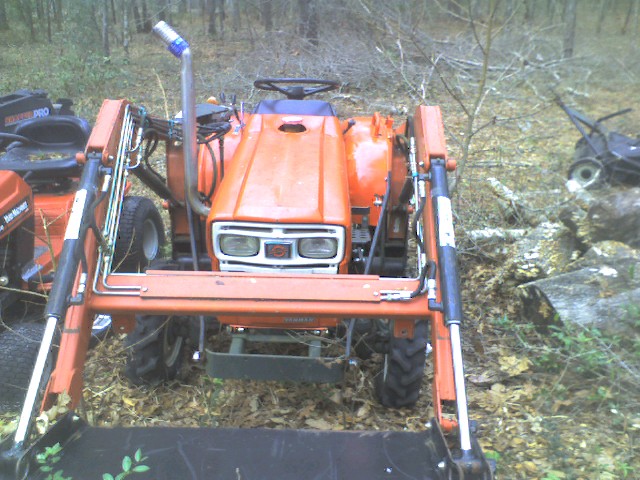

Gonna see if I can get a few pics online here. Like I said, I haven't closed the deal yet, but if something doesn't happen soon I might lose it! Pics look orange because they are taken with a phone, but I have seen others and it and loader are very red.

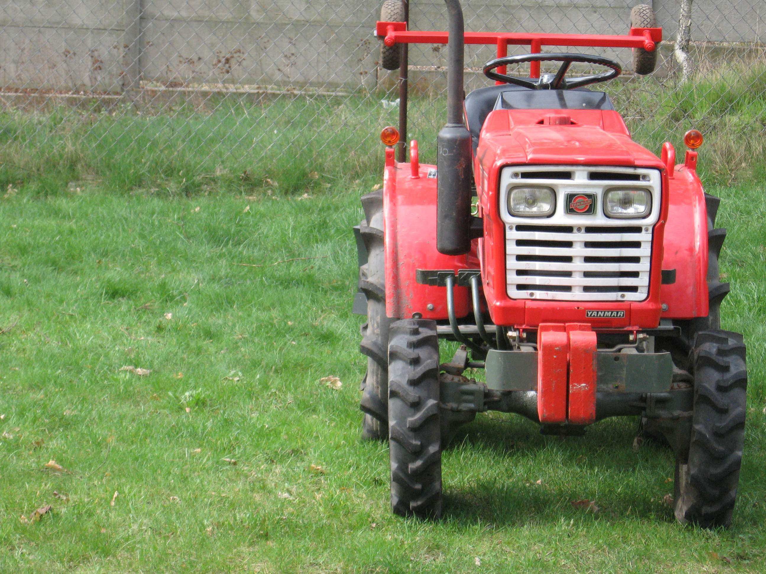

That isn't an original muffler. This thing may be REAL loud.
The original muffler would look similar to the one in the first pic and a replacement to the one in the second pic. That does not have a muffler that I can see. Yes loud. Good call Calif.
The one in the first pic is for sale and I am thinking about getting it now and selling one of the tractors in the spring. They are asking about $4800 but it comes with the tiller and 3 pt linkages and does not have the implements that the one Ron wants. The tractor in the second pic is a VN rebuilt.

It is hard to tell from the pics but it looks like the front wheels may be reversed.
/ looking into buying a 151d - help! #20
Good call on that. I did not notice that but you are right, the front wheels are reversed. That is a no-no in what I have read. Besides it gives the wheels more leverage to jerk out of your hand if one wheel hits the smallest object. It could be a major factor in this situation. I will post a pic of a wheel on the normal way.
If you draw a line down through the hub kingpin then you will hit the ground in the center of the tire. With the tires on normally then when you turn it pivots on the tire. If it were reversed the tire must roll around an arc. It is this movement which is extremely hard on the front end and makes steering more difficult. Reverse the rears for stability, but leave the fronts like normal.
