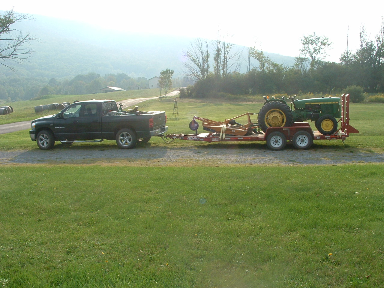

That loading doesn't look too bad to me, but it really varies tractor to tractor. If anything, I would have rolled the tractor even more forward on the trailer, but maybe there wasn't enough room. When I looked at working out tongue weight and balancing, most handbooks assume the tractor center of mass is just forward of the rear wheels. Ideally, you'd want to have that (or the real center of mass) evenly positioned over both axles. Implements will skew the overall center of mass in the direction of the implement, and how you lower or block implements will factor in. Where they touch the deck (or not) impacts how they affect the balance of the whole load. This definitely matters with long implements.

All very good things to consider when loading. For me, I need to load facing forward (FEL, Ballast Box on rear) and position the rears slightly ahead of the rear axle (weight distribution from FEL up front and having filled rears).

I had to load backwards to balance load and to keep brush hog connected. Loaded frontwards and keeping the brush hog connected and then moving both forward enough to be able to fold up ramps I had way, way, way to much weight on the truck. Good case for slide in ramps.
It handled very smooth loaded like this even though the tractor is turned around from the preferred you couldn't hardly feel the load back there.
Believe me I worked with it for an hour to get it safely loaded since I was travelling 125 miles.

I follow the process here, and it makes sense. I don't see how having sliding ramps would have helped you really, as the brush hog would have been hanging off of the back of the trailer. While you could hang a flag or something for safety, that leaves a fair portion of it completely unsupported.
