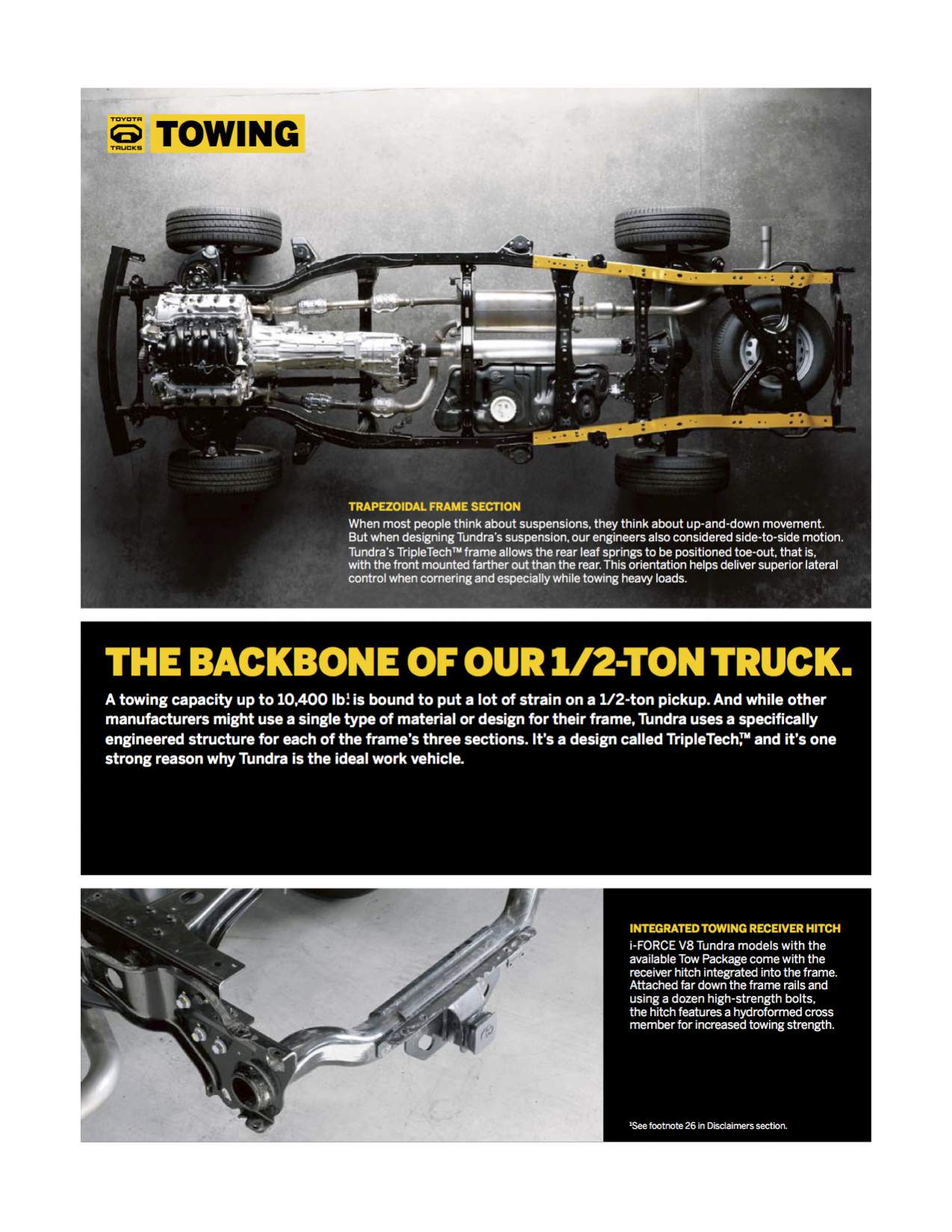

Yeah, that is simply a factory hitch on the Tundra, and not much different than any other bolt-on hitch.
/ Looking for input on trailer choices
#43
Removing the factory hitch also removes the bumper mount (the mount is welded to the hitch) and changes the integrity of the frame (hence the "Integrated" statement from Toyota).
/ Looking for input on trailer choices #44
Looks like it's time for you to take a trip to the local Toyota dealer to see it in person, then. This is NOT a bolt-on hitch. Here's pages 7 and 8 from the Toyota eBrochure for 2012 (which is just about identical to the information published for 2011, and my truck is a 2011). This is the second generation Tundra and has been in production since 2007, so the design has been around for a number of years.
View attachment 272273View attachment 272274
It says right there, "Using a dozen high-strength bolts."
That being said, it does look like the hitch has been designed in such a way as to have a relatively high tongue weight.

Agreed... But look at the tubular portion that inserts THROUGH the frame rails. There's definitely some torsion control going on there, and as I stated in a different post, the mount for the rear bumper is welded to that cross member. If you unbolt the hitch, there' nothing left to mount the bumper to. I would have to buy the corresponding piece from Toyota that they install in the trucks that do not come with the factory hitch.
