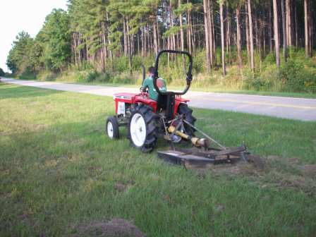

Wooly, an old thread where I compared them:
Mowing: Big twin (YM240) vs little 3-cyl/Powershift (YM186D)
I hope your slopes don't look like this steep part of my ravine. See my posts (#5, #10) in this old thread. Clemsonfor, is Eucalyptus like this common everywhere?

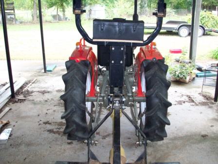

Spacing of rear wheel.
i did notice what i thought was eucalyptus in your pics. And No we do not have it here in the south...other than like cultivar plantings. I dont think it grows anywhere on the East coast. If anywhere the south would be the only place as were closest to yalls climate. The cold i would think would kill it and limit it. I bet in south GA or FL they could grow it...but florida is not a well know area to me as there still so different as far as soils and lack of winter are concerned. Where i live here in Upstate SC we esaily and routinely hit 100F most every summer, and we easily freeze every winter and usually have regualar lows into the upper teens and low twenties each winter. the last few have been exceptional with lows in single digits. I dont think it would survive here. We can grow banana trees but if it frosts it kills them to the ground even in coastal SC.
Being a simple southerner i have not traveled many places and although i am a forester i dont study other areas and therefor really lack a knowledge of thier tree species. I have a general idea but as far as ID and specifics its just what we were taught in school. You are basically just taught forestry for the region you go to school in. So i am basically a southern Pine forester. Yes we have plenty of hardwoods both bottomland and upland but there not managed here and the quality other than some good bottom lands is not good.

Here is a pic of the tires i think at the narrowist . i did a tread on swapping the tires on here.
The next is me cutting but i have none on here where i am standing beside it. I might dig those up tomorrow?

Thanks for the photos. Your YM2000 looks pretty tall and narrow to me. I assume swapping the wheels and pushing them as far out as possible made a noticeable difference? Are you saying the frame and rear wheels on the YM240/TM2000 is roughly the same?
