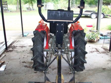

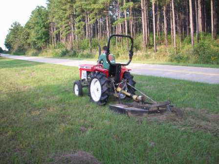

Same American R-1 ag tires on both, not rice tires that have even higher lugs. The tires in the 'twins' photo are now on the sale tractor, after cleaning up those rims some.
The loader is original Yanmar OEM on the tractor since new, I think built by a North American plant.
Loader is capable of whatever I attempt, maybe 600 lb rated??? These tractors are so short that you never know which end of the tractor will raise when you lift an implement or loader-full. They really need ballast set up specifically for whatever project is next. For the loader tractor I've been hanging two 77 lb wheel weights off the 65 lb quick hitch at the back (photo) and that's barely enough to offset the loader forks and platform I sometimes attach to the front bucket, if I have some weight on that platform. (Need the front platform to carry orchard ladders, crosswise, where I can see them). For this sale tractor, I first installed the front weights for some discing and mowing to get the front down where I could steer it.
i wouldn't sell this without a personal walk-around. It has so many dings and wrinkles in the sheet metal that there must be a story of some farmer's angry girlfriend in its past. A buyer needs to understand I'm selling it for its capability, not its looks. I would say my price is fair considering its appearance. A pride of ownership type of buyer might take the hood and fenders to an autobody shop for straighten and repaint before showing his wife. :)
I think the loader would clear the side of a pickup with its bucket level, not sure.

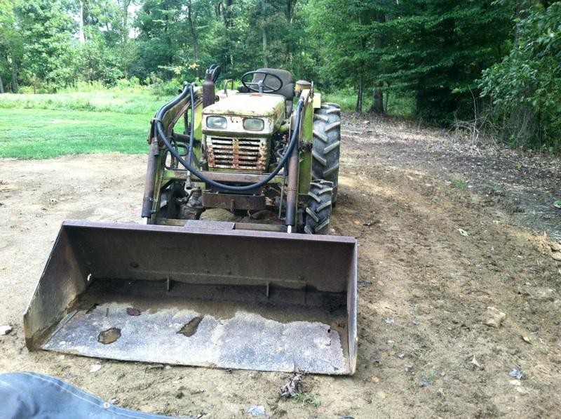

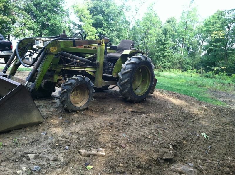

Another one just popped up today. What about this? The bucket looks WAY too big for this tractor. If I were to go look at it, what should I pay attention to? M__2F5A.jpgM__A2F2.jpgM__D8C1.jpg
Thanks
/ Looking for first Yanmar #90
I agree that bucket looks monstrous on that tractor. Also looks like the front wheels may be in the wide stance which would be asking for trouble, in my opinion. Looks like the loader has it's own hydraulic resevoir and hoses running everywhere. I would tear that one hanging down off on my first trip through the woods.
All that negative doesn't mean it couldn't be a good tractor.

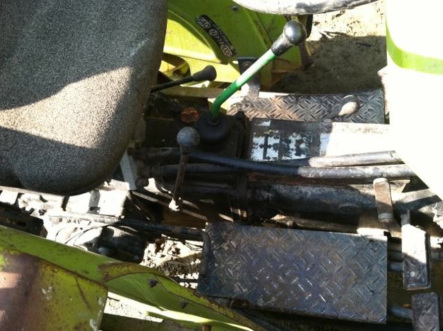

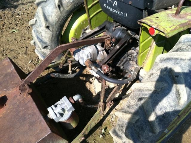

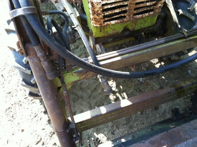

Thanks for pointing that out. This is about 3 hours away and I'm trying to decide if I should go see it. Asking price is $2500. He sent a few more photos. Comments welcome. I'm not sure what to make of this. Thanks.
It looks like this loader runs off the rear PTO. How difficult/expensive would it be to plumb that into the tractor hydraulics? This arrangement has the rear end occupied for loader use. I'd like to put a box blade on the rear and still be able to use the FEL.
Correction- The loader does run off the tractor hydraulics. That contraption on the rear is for an added remote, at least that's what the seller says.
Am I reaching on this one?
/ Looking for first Yanmar #92
I can't give good advice here. The price is cheap for a tractor with loader but no doubt this tractor has been around the block. Just the way I am I would go take a look believing I can fix anything. However, when I got there I might make a u turn and go home.
I notice an unattached quick disconnect up toward the loader in one picture. Wondering if he had a grapple on there at one time.
One thing for sure, the seller is not polishing it up, could be something said for that.

I talked to the seller. Turns out he bought this from a guy who used it for fencing. Said it had a post pounder on the front and that's what the apparatus on the rear pro is for- running the front aux hydraulics. He doesn't use that but left it on the rear for weight. Post-pounding with the front sounds like it could be hard on a tractor- at least where I am- stones everywhere.
I know California has a YM240 that isn't pretty but runs well and gets a lot of work done. Maybe he'll chime in.
My father, who knows tractors better than I do, is actually going to be near where this is being sold and is willing to have a look at it. $2500 is not much for a 4WD with loader so I guess the bar is pretty low.... But I really don't want something that is in need of a lot of work. I'm not worried about the dents and scratches- I'm worried about the bones.
Is this good- he's not trying to hide anything? Or is it bad, doesn't look well cared for?

The paint on the loader appears to be Yanmar green and match the rest of the tractor. It's be nice to know that's a factory loader and that it's really the bucket that too large for the tractor, not the loader itself.
Do you think that's a factory loader?
/ Looking for first Yanmar #95

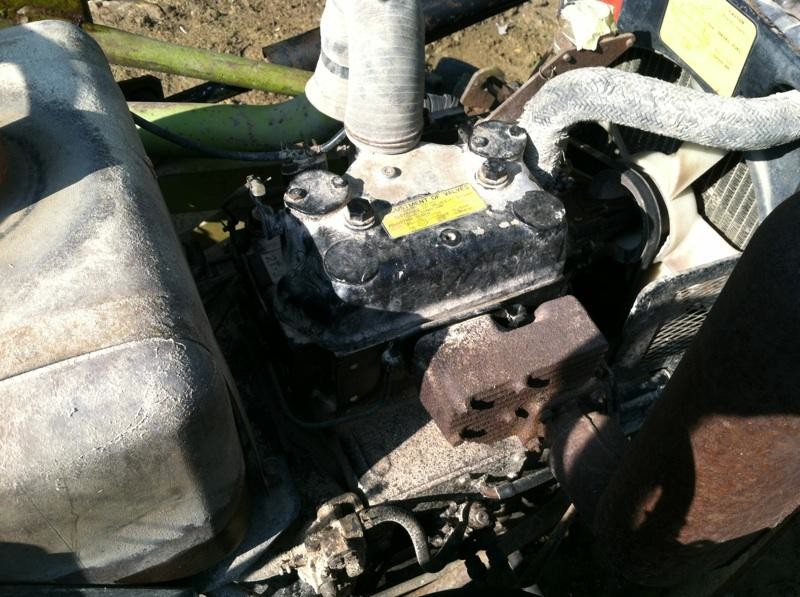

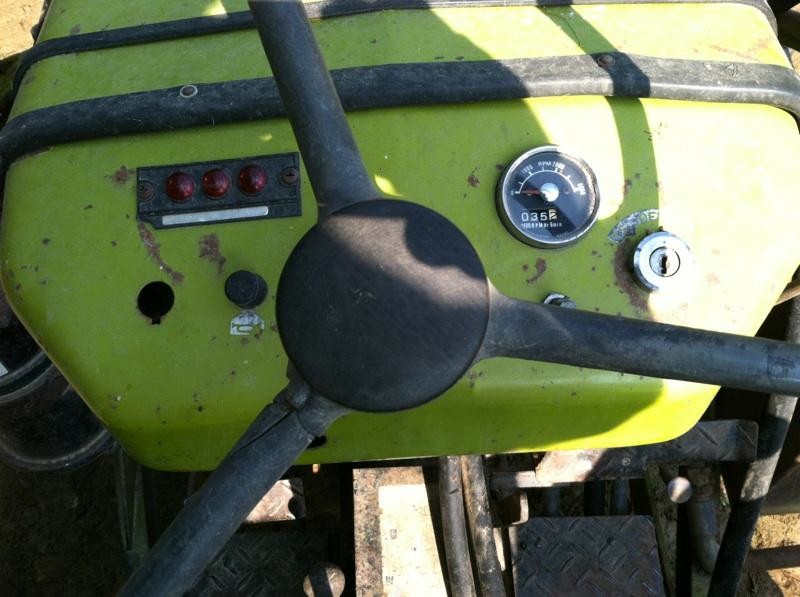

That thing looks slightly rougher than my similar YM240 was when I bought it. A couple hundred $ brought it up to good working condition, replacing fluids, battery, bashed headlight, etc. This model is pretty much unbreakable, if you verify that everything seems to work as intended. And idiot-simple to work on if it does need something. (No comments from the peanut gallery please. :D)
That's a factory original loader except the bucket. He must have had a business selling mulch or sawdust or something. My nearly identical loader - a Great Bend third-party loader likely installed by the dealer - runs from the tractor hydraulics like that one, and is slower than you would want if you are buying the tractor to use specifically as as a loader. Also the non-syncro transmission is a nuisance if you want to go backward and forward all day. For farm or hobby-farm work where the loader is important but not used all day, this model is fine and has lots of lift power.
As Winston noted the front tires shouldn't be reversed like that. More risk of breaking a spindle, and running a tire into something could jerk the steering wheel out of your hands. Look for front end wear, but I doubt anything's broken.
The low front tires are a caution that he isn't keeping up on maintenance. For loader use they should be at the maximum pressure declared on the sidewall.
I'll bet with all the hydraulic plumbing and that big bucket, the tractor was used mostly stationary to power a log splitter.
That's a final-year YM240D indicated by the external air cleaner. (So 1981).
In summary, an excellent model but after 30+ years you need to verify that this individual unit is in normal condition.
Added I see there have been more posts while I was drafting this. $2500? If Dad says it looks ok, tell him to buy it on the spot. Else someone else will. At that price you have some margin for minor repairs. For me I would just do a major service - fluids, filters etc - and keep on trucking as-is.
I don't think a fence pounder could hurt it; not an issue.

I can't think of anything specific to this model. Simple and bulletproof. As I've posted before, I believe this is the model that spooked Deere into contracting with Yanmar instead of designing their own line of small tractors, they couldn't improve on it.
Tell Dad the horrible racket likely isn't a rod knock, they just sound that way. CLANK CLANK CLANK.
Look for jumping out of gear, a slow starter motor (only $100), and the obvious diesel stuff - severe smoke at idle, etc. You mentioned Dad has experience with diesels so a general look-over should spot anything. Tell him to be sure to run through all the gears including FWD, check that the tractor's hydraulics lift the loader and 3-point, etc. That additional hydraulic system might be worth some money to somebody for a log splitter especially if can mount on any 3-point.
For me, I would look it over thoroughly - then I would buy it at $2500 if it checks out. That's a great price for anything with 4wd.
