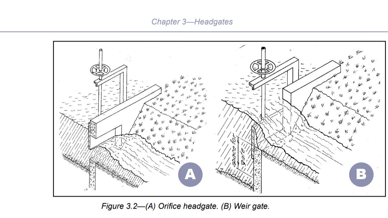

I think a weir gate is the answer you need.

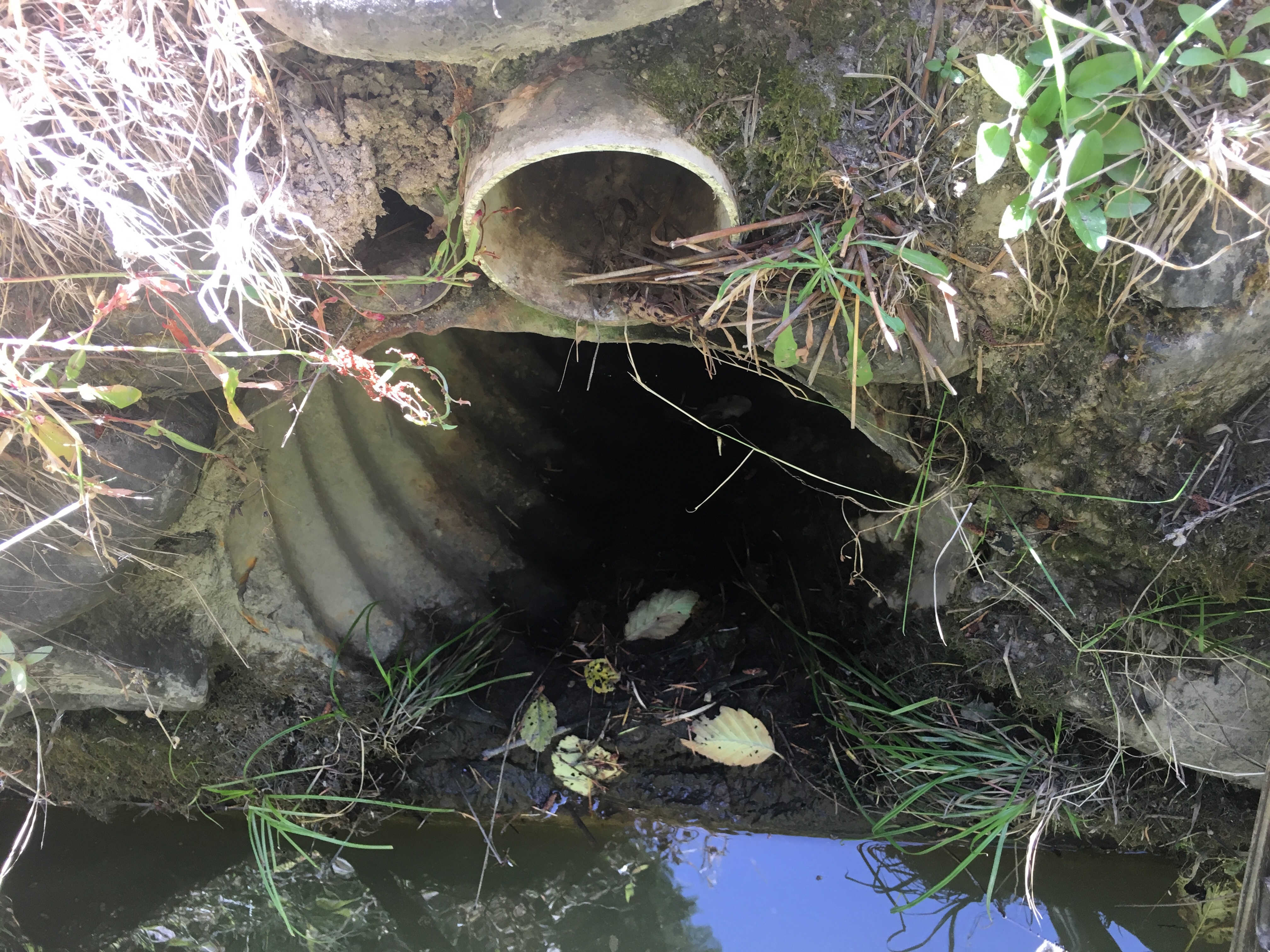

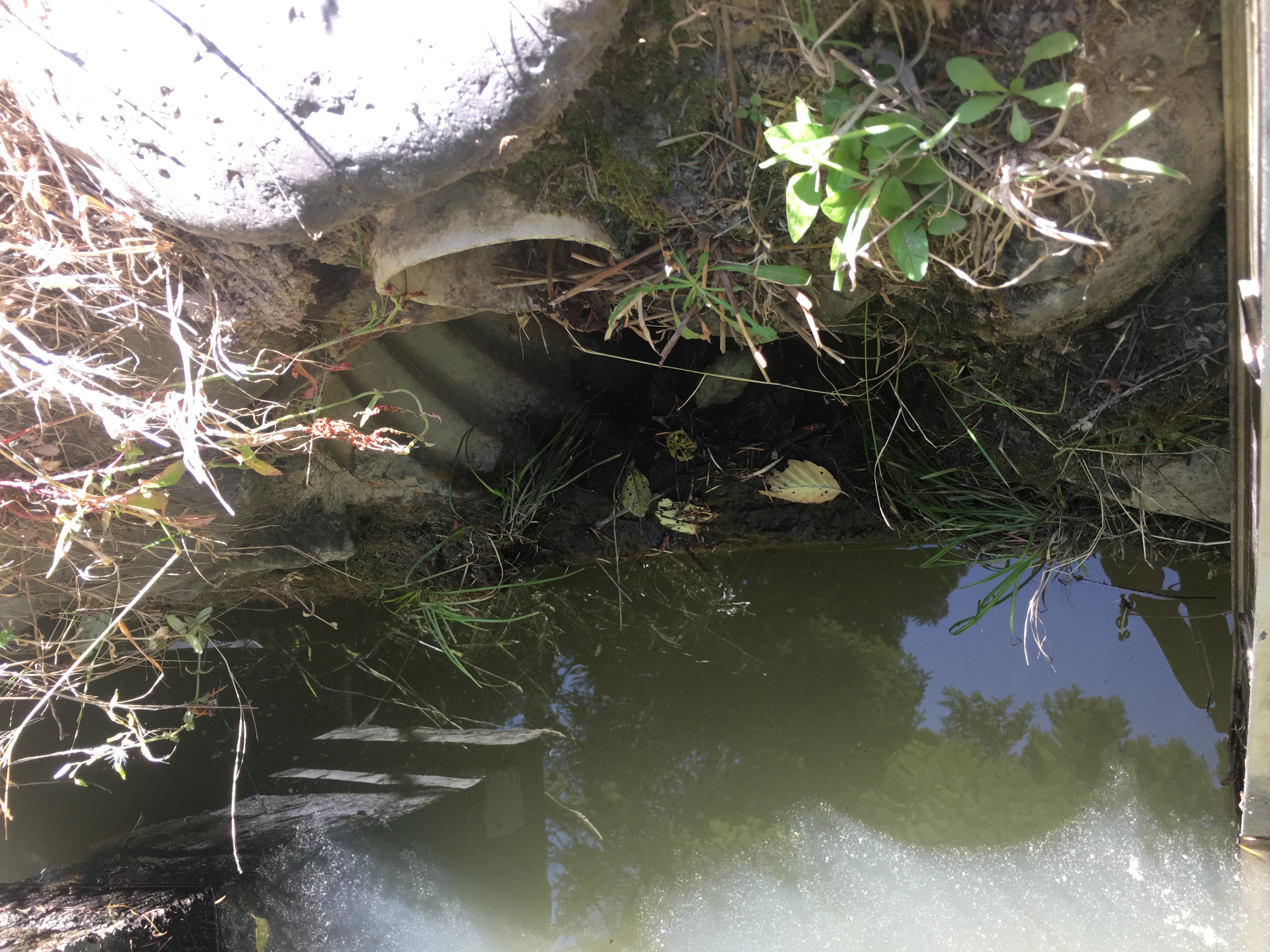

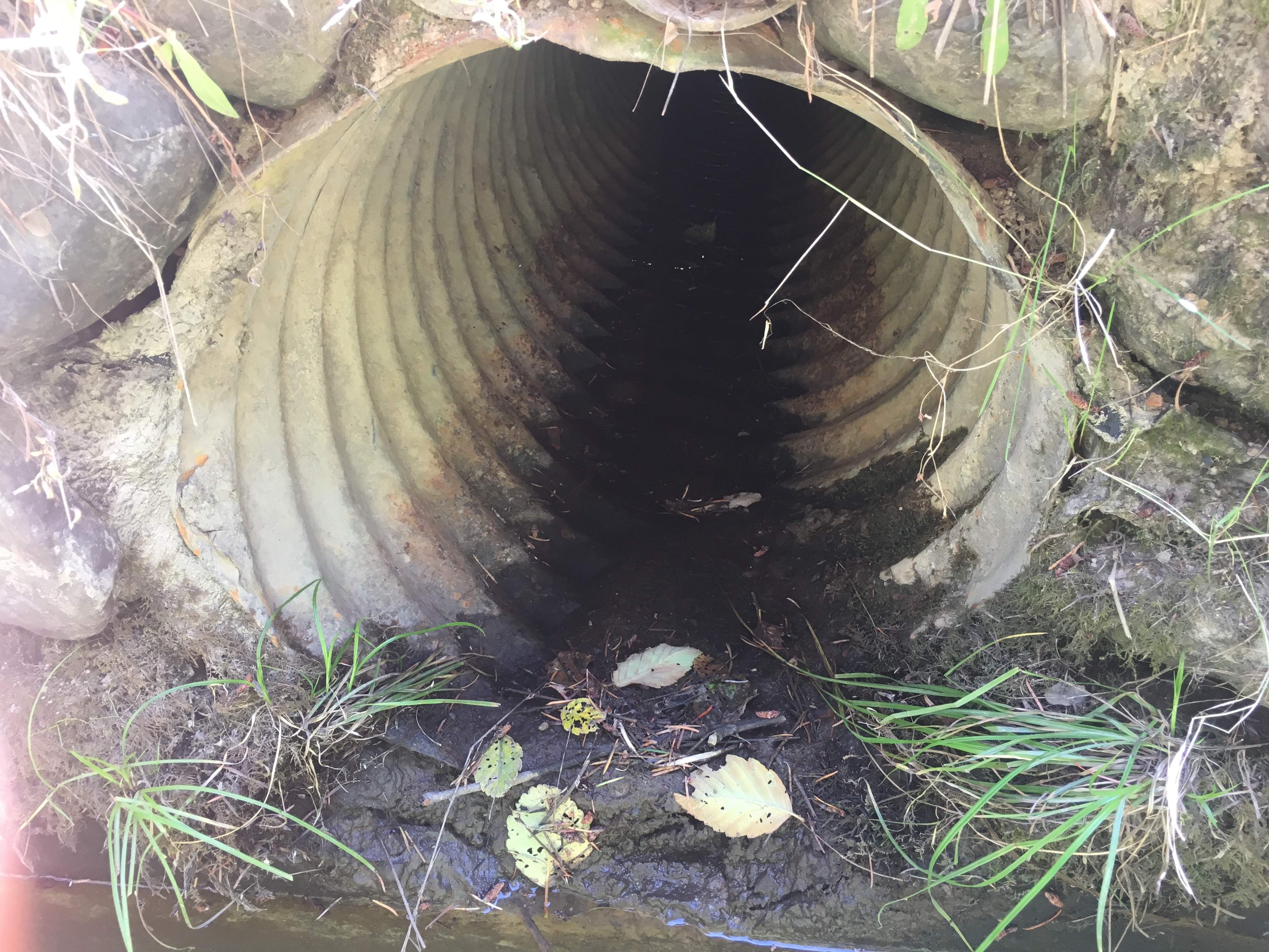

Okay, here area few pics. Hopefully they show how the pond side of the culvert is recessed into the bank (I think the dam actually starts below it). Please let me know if I'm missing something, but I think I'd need to somehow extend the culvert if I were going to attach one of those gates you guys are suggesting. Same with the straw bales, as it stands now the bale would be able to sit flush against the rim of the culvert. The other concern I'd have with the bale solution is that the flow rate into the pond is so low in the summer, even a minimal amount of leakage would render it ineffective. My irrigation shut off this morning at 8am, it's now noon here and you can see in the last picture that the water level is still well below the culvert. It takes almost the entire day to recover with the low inflow.

Can a section of PVC (or similar) pipe be forced inside the culvert? You'd have to closely match diameters, then maybe pour concrete around the coupled area to seal leaks.
/ Looking for advice on (temporarily) plugging a culvert #13
If you want a positive seal, then it will have to be a wooden gate, rounded to the bottom shape of the culvert. It could be jammed down into one of the culvert grooves. Line the bottom of the wooden gate with some type of rubber - as a gasket. Heavy foam rubber or something similar.
Or, as Diggin It, suggests. Only, use high density expanding foam to seal around the coupled area. With a chunk of PVC extended out into the pond - a sealed gate would be easy to fabricate.
BTW - the pics are a BIG help.
