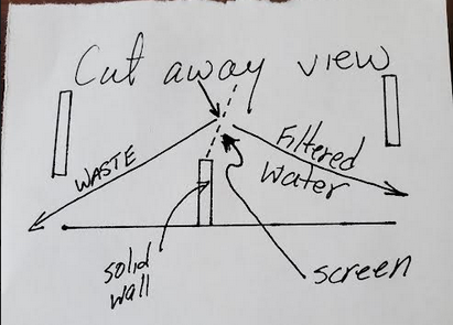

My concern is any particulate large enough to permanently obstruct a 5/8 ID tube about 700’ long. That would suck.
KilroyJC,
Your water source is the end of the pipe so I suggest the following setup to eliminate anything short of bacteria in the water you are receiving.
2manyrocks' suggestion of a tote is a good one but with the following modifications. Between the water source ( culvert pipe end and the tote) I would place a open topped box with a divider in the middle to separate out the "big" stuff you don't want flowing into your tote. Pic attached. The box is a separator where you place a screen ( of your choice for mesh size ) on top of a divider ( solid wall ) at which you direct the water flow ( best choice is not directly at ( 90 degrees) but at a glancing angle so the screen is self cleaning) and the "filtered water passes thru the screen and the "waste" water flows away carrying debris ( leaves, frogs, chipmunks, sticks, chunks ) that would otherwise end up in your tote. This eliminates the need to clean your tote as frequently and eliminates most of the floating debris that gravity separation will not deal with. Now the tote. How much sediment you want to remove is dependent on whether you intend to pump the "filtered" water and whether or not sediment will damage the pump choice. You want a tote that is a rectangle since fine silt takes longer to sink due to gravity and any currents induced by taking water off the "clean" end of the tote. You want to add the water from the separator box by plumbing a bulkhead fitting into the tote at point halfway up the side wall and take your sediment free ( or near sediment free ) water off the tote at the farthest point away from the entry point. The reason for plumbing your feed water in at the tote's side is the sediment has shorter path to drop out of any possible currents within the tote and the clean water rises to the top. The tote needs to be open to the atmosphere otherwise it will pressurize and stop filling. You could cascade from first tote into second tote and then pump from second tote depending on how much water you need at each time you irrigate. You could also set up a float actuated switch to turn pump off when tote was near empty to prevent pump damage.
I will elaborate if any part is confusing.
Hope this helps.

KilroyJC,
2manyrocks' suggestion of a tote is a good one but with the following modifications. Between the water source ( culvert pipe end and the tote) I would place a open topped box with a divider in the middle to separate out the "big" stuff you don't want flowing into your tote. Pic attached. The box is a separator where you place a screen ( of your choice for mesh size ) on top of a divider ( solid wall ) at which you direct the water flow ( best choice is not directly at ( 90 degrees) but at a glancing angle so the screen is self cleaning) and the "filtered water passes thru the screen and the "waste" water flows away carrying debris ( leaves, frogs, chipmunks, sticks, chunks ) that would otherwise end up in your tote. This eliminates the need to clean your tote as frequently and eliminates most of the floating debris that gravity separation will not deal with. Now the tote. How much sediment you want to remove is dependent on whether you intend to pump the "filtered" water and whether or not sediment will damage the pump choice. You want a tote that is a rectangle since fine silt takes longer to sink due to gravity and any currents induced by taking water off the "clean" end of the tote. You want to add the water from the separator box by plumbing a bulkhead fitting into the tote at point halfway up the side wall and take your sediment free ( or near sediment free ) water off the tote at the farthest point away from the entry point. The reason for plumbing your feed water in at the tote's side is the sediment has shorter path to drop out of any possible currents within the tote and the clean water rises to the top. The tote needs to be open to the atmosphere otherwise it will pressure and stop filling. You could cascade from first tote into second tote and then pump from second tote depending on how much water you needed at each time you irrigated. You could also set up a float actuated switch to turn pump off when tote was near empty to prevent pump damage.
Hope this helps.
This is exactly the type info I am looking for, and no pumps are needed, as the culvert is approximately 80’ up from where I am sending the water - gravity is a wonderful thing!
basically I will be building a septic tank it looks like. . .

I guess that's one way to describe it. Water source feeding a separator feeding into septic tank feeding into a water storage tank that you pump from.
Sorry the separator is crude hand drawing but a quick way to describe how to have a self cleaning means of mechanically separating the big stuff that you don't want entering your gravity settling tank.
The separator is a box with big holes in the opposite sides to allow waste to flow freely away and a wall between waste side and "filtered" side to prevent cross contamination. The "box" has a bottom so it can be weighted and does not slide away from water being directed at screen.
You want to cascade the water from first tote to second tote to prevent the high currents, induced when withdrawing irrigation water, that may prevent silt from fully dropping out while in first tote. Residence time, when using gravity separation, is critical when working with very fine particles.
