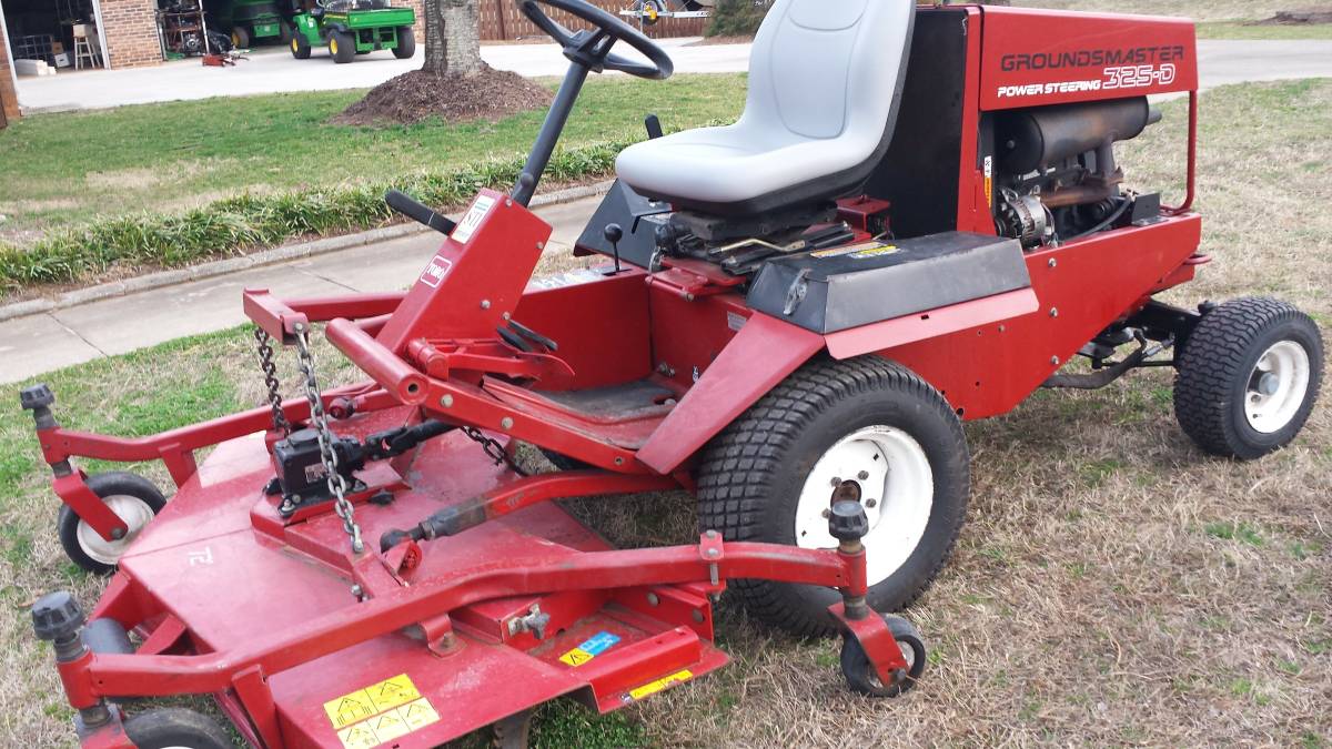

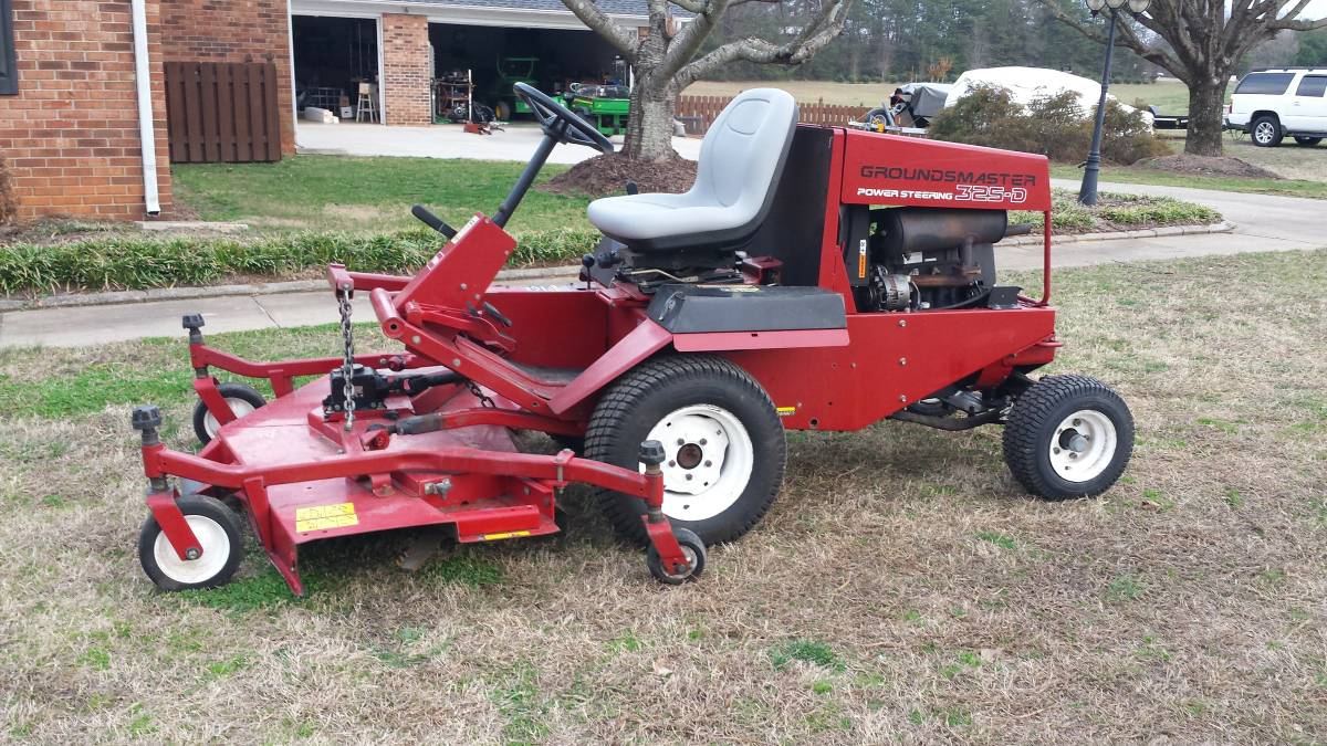

The Goundsmaster that I have is built like the F series Kubota. They are not as fast as a zero turn but I have very steep and rough ground to mow. The greater speed of the zero turn is reduced somewhat by rough or steep terrain of which I have both. I picked up this unit for $3K. So far I have replaced an alternator belt and bought some different blades. Doesn't use any oil and cuts great. I like it.
