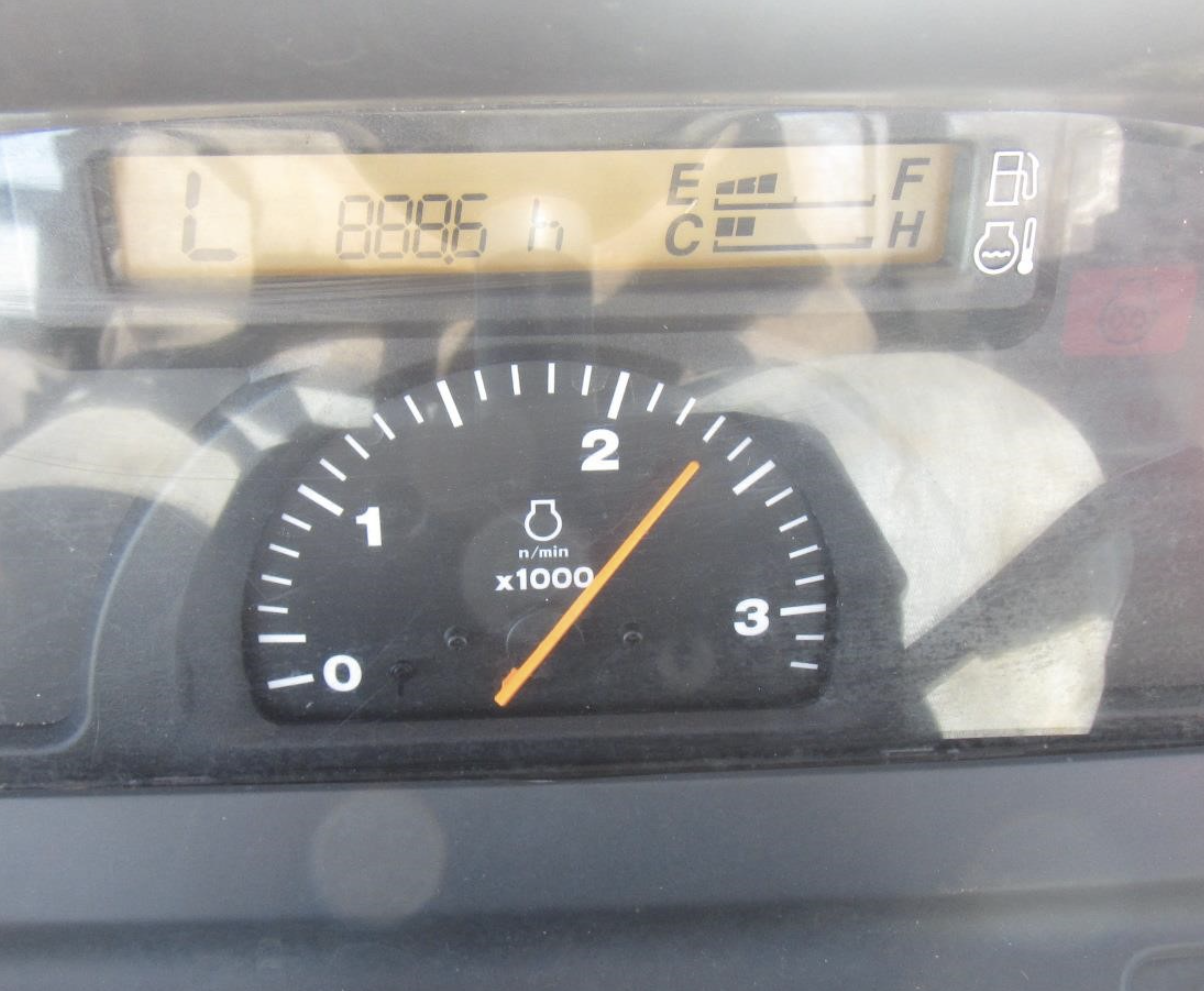

/ Looking at L4330 Model Tractors #16
Very nice machine congratulations!
Guessing this has 500-600 hours?
#17
