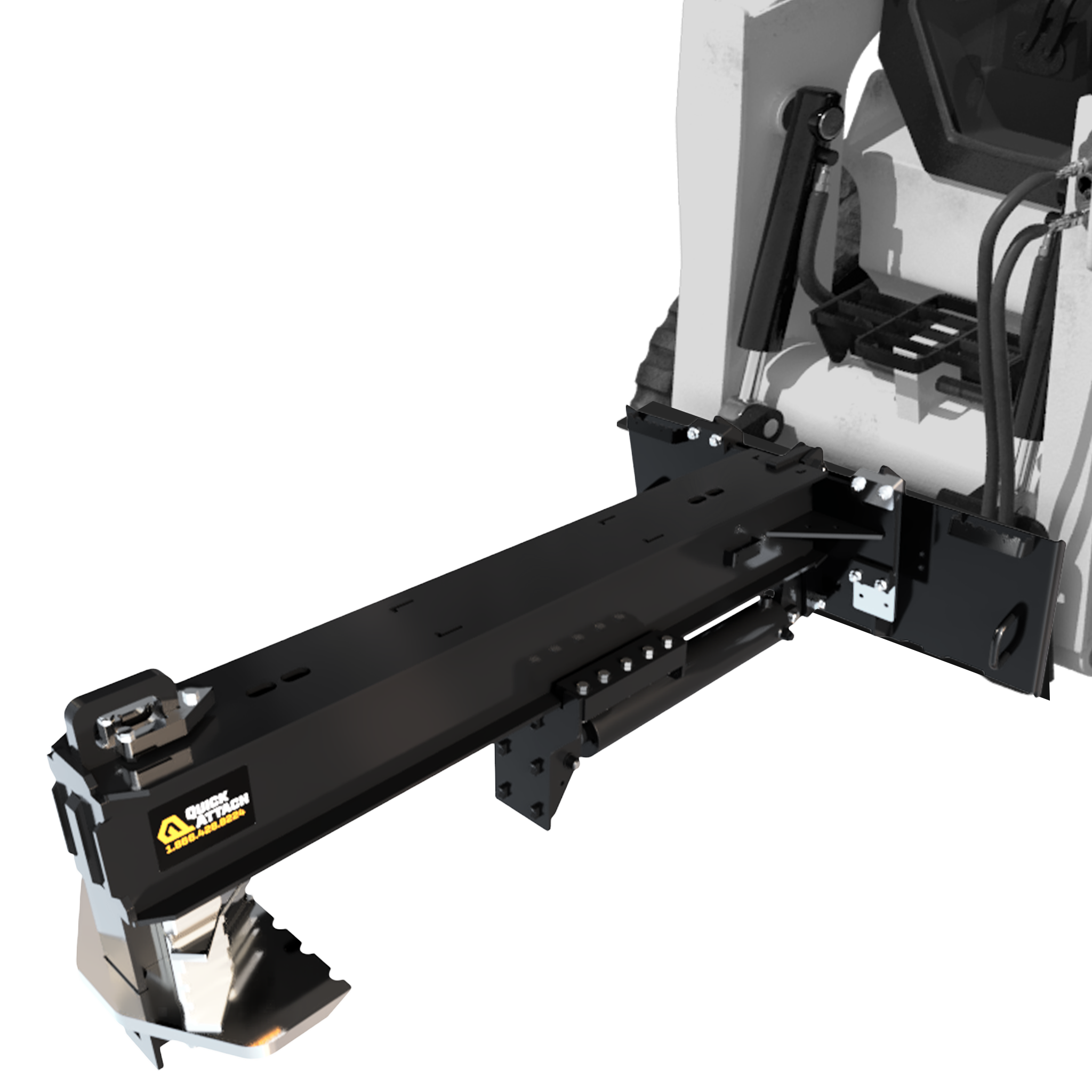

Good afternoon gentlemen, after years of lurking and finding good info I had to come in and ask for some help. I am building a prototype press kind of like a post splitter,
But it will be vertical. Shop roof clears it's good.
So H-beam a 4" bore cylinder at 3000psi, about 18.8 tons of pressure, or 20 for easy math, but I need 9' of travel on a 10" H-beam, but i don't see very many post splitters to borrow design ideas from, what sort of H beam should I use? How far would a 6" w25 go before bending, should I go to an 8"?
Thanks in advance

That's a very long span compared to common log splitters... Gonna need a massive beam/support to minimize deflection.
   / Long time lurker, here for log splitter help #3
You have a 4ā€ bore cylinder with 9’ of stroke ?? Never seen such a long skinny hydraulic cylinder . It would be about 20’ high, extended vertical, and need a rod almost the full 4ā€ diameter.
   / Long time lurker, here for log splitter help #4
I would box the beam as well to keep it from twisting. I bought a splitter for my Ditch Witch mini track loader that is boxed. Heavy indeed but built to last !

I did see one exactly what I wanted, there is longer. But to be fair 6ft is more realistic.
Yes, and to complicate things, I want the cylinder beside the beam, not on the far end, it will be more compact
   / Long time lurker, here for log splitter help #6
That one you attached is 25’ long, extended ( tall in your case).
It uses a hollow rod, which makes sense since the rod diameter is such a high percentage of the diameter.
640lb shipping weight 😁

You still will need a height appropriately a little more than 2x your cylinder stroke length

There's probably a good reason for that. It'd be cheaper and easier to build a basic bandsaw mill to do this and it'd be a proven design.
