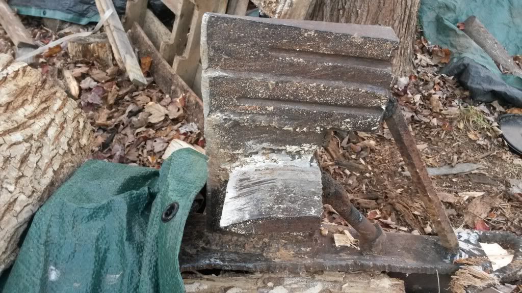

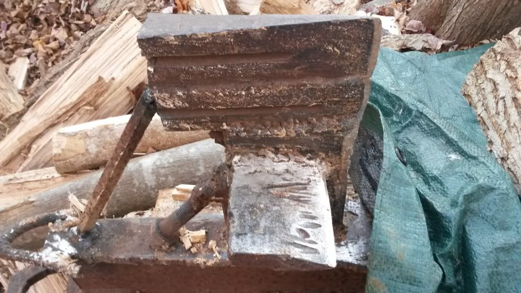

I havent seen it mentioned in here, but those wedges look like cast iron. Welding cast iron is not the same or as easy as steel.
Most of the wedges you see on manufactured welders are steel with a edge machined on them.
/ Log Splitter Wedge ripped off. #42
I agree with the wedge being odd angled.. Even if the back side was tilted more away from the beam so at least as each piece slid through it wasn't trying to destruct itself from "squeeze" pressure... It would push the upper piece more skyward but it my experience air pressure is quite a bit less then beam to wedge squeeze. If that made sense..:confused2:
/ Log Splitter Wedge ripped off. #43
The wedge looks like several manual splitting wedges welded together. Anyway, Weld it on with 7018, 8018, 312 SS, If it gets torn off, Weld it on again. And again.. You'll get it.

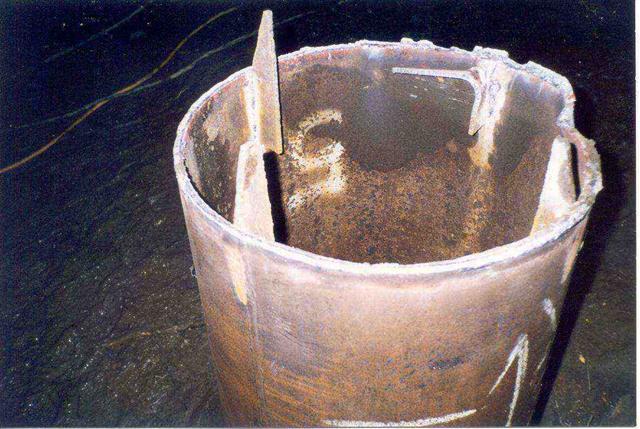

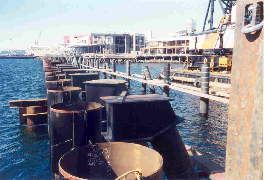

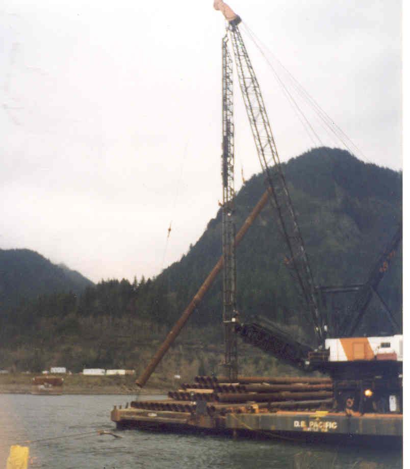

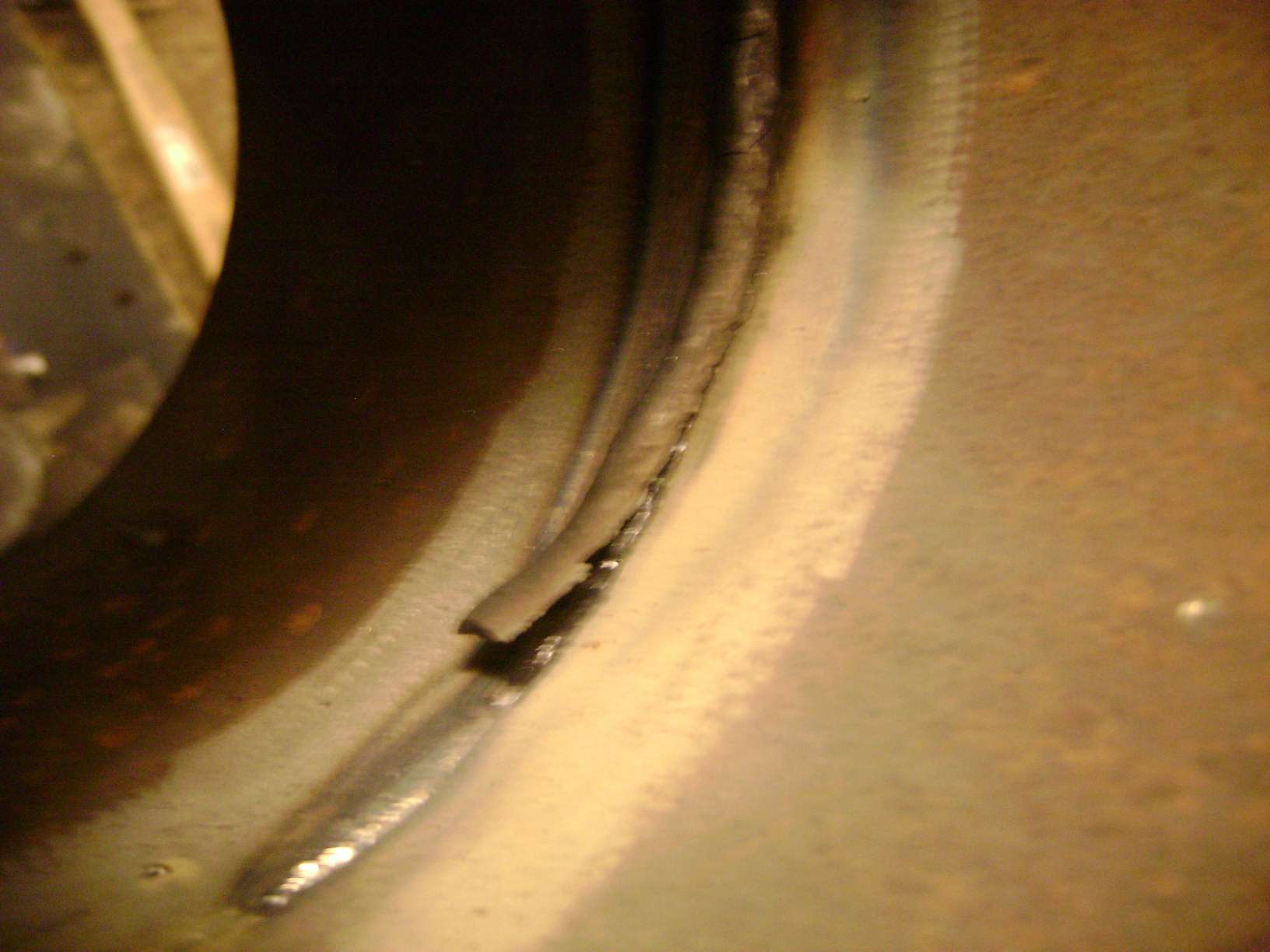

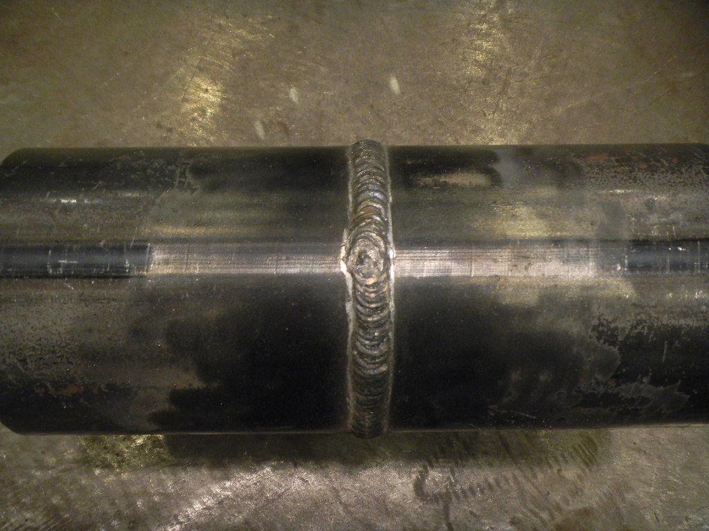

Speaking of bad welds! I was working down river of the Bonneville Dam on the Columbia River. We had to build a work trestle the size of a football field. I was out in the river over seeing the rig up of the derrick. Another crew was on the beach splicing and driving 24-inch pipe pile for the approach to the trestle. One of the certified weldors was having trouble with his wire feeder. The other superintendent over seeing this operation radioed me and ask if I would come to beach and help this kid. When I walked up to the pipe I could see the kid had no idea how to set his welder. I dialed it in for him. I walked up to the other superintendent and ask how hard the pile was driving. He said it was going out of sight. I told him the weld should be cut out and done over, but he didn't want to take the time to do it right:rolleyes:! I went back out to the derrick, when the land crane swung over to drive this very badly welded pipe I walked over to the side of the barge to watch. The hammer hit 2 or 3 times before the weld broke. **** hit the fan:eek:, guys ran every direction trying to get out of the way! I was shocked the boom of the crane didn't come down:shocked:! The pile driving hammer landed on the hood of my company pickup who someone had parked too close to the work:mad:. The hammer drove the engine of the pickup right into the mud!:laughing: The weldor got fired on the spot! Thank God no one got killed.

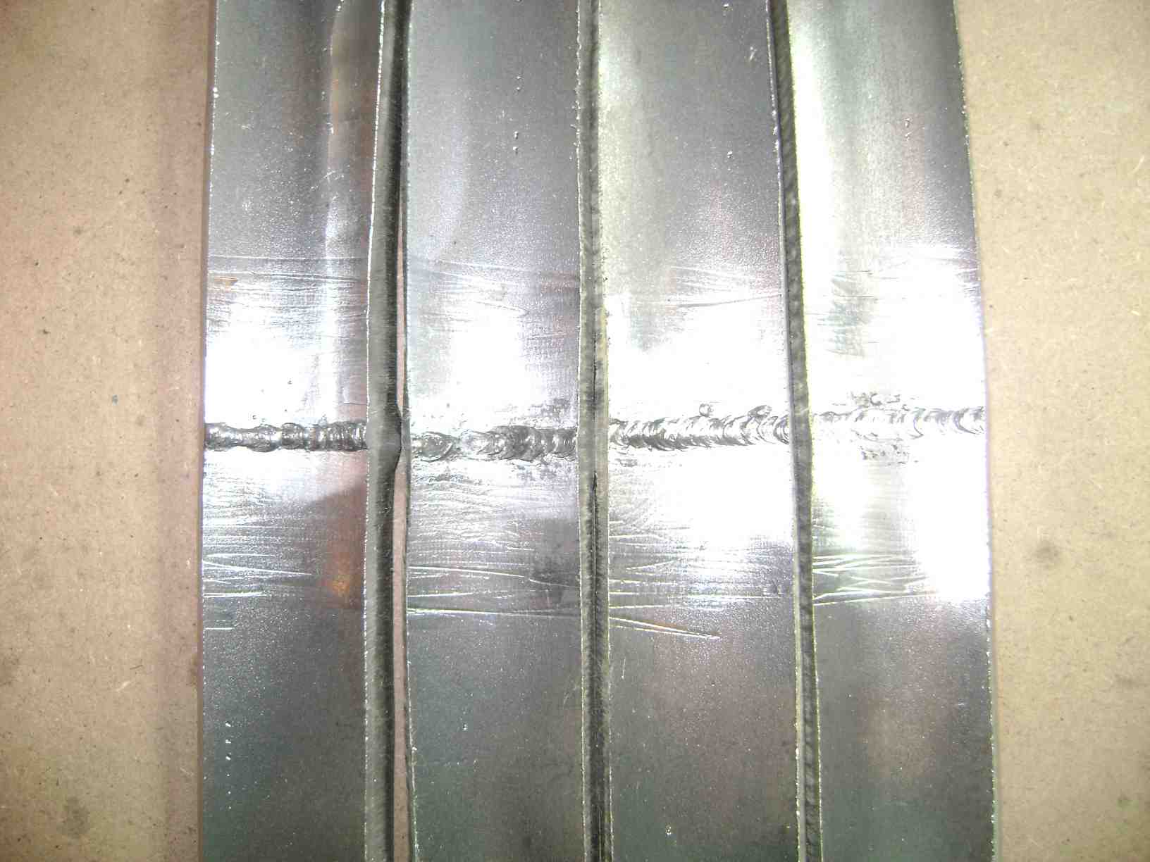

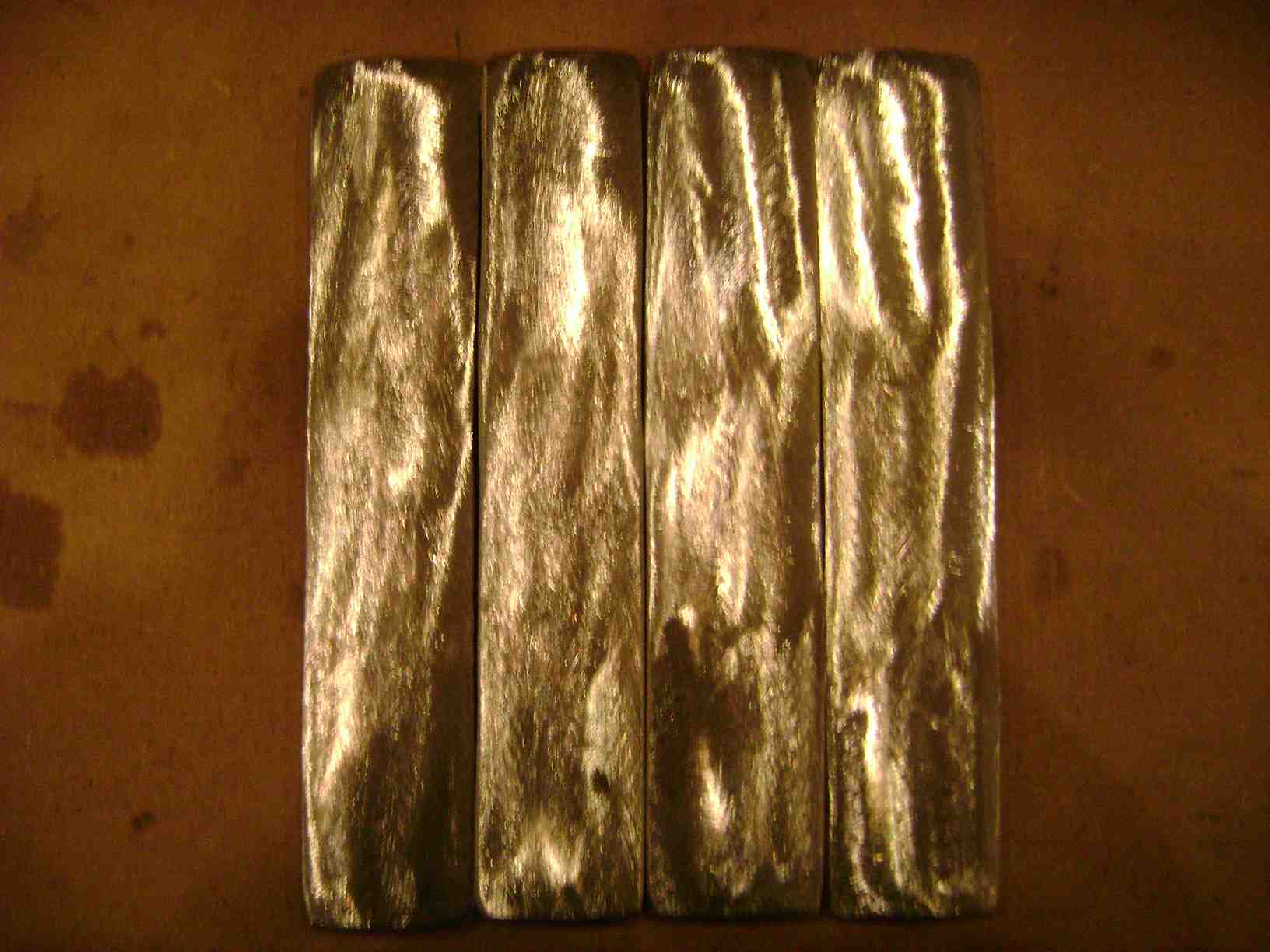

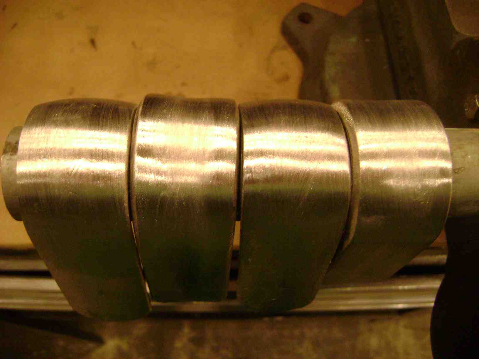

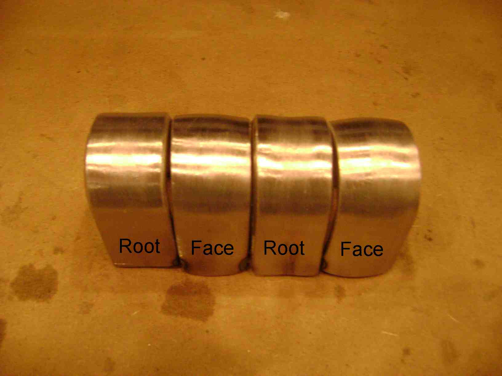

Chad there is nothing in the world wrong with Mig welding. As long as you have the right equipment! The problem with Mig, is guys run down and buy a 120-volt Mig welder, practice for a couple hours then want to build a trailer, or trailer hitch!:eek:

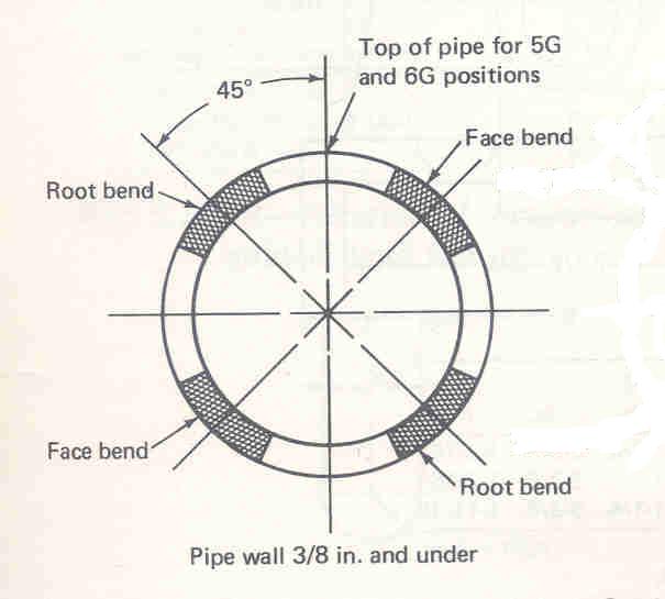

When you have some time here are some threads I started on break testing 6013, 6011, and Mig. I was floored at how well the Mig weld did. But! I failed two welding tests in my life. First one was a 1-inch V-butt vertical up with Mig. Reason I failed, I ran it too cold! I promised my self that would never happen again! Second test I failed was a 6-G pipe test.
http://www.tractorbynet.com/forums/welding/211678-6013-break-test.html
http://www.tractorbynet.com/forums/welding/211903-6011-break-test.html
http://www.tractorbynet.com/forums/welding/212146-mig-break-test.html

My thirty five year old homemade splitter has a two way wedge made of mild steel. I used 1/2" thick triangle 12" long 5" wide, torch cut at a 25 degree angle. As my I beam is topped with 1/2" plate, I laid it down small side down, and welded with a multi pass fillet using an ac machine and 6011 rod. Standing on edge each side of this a 1/4" plate 10" tall. One plate extended past the line of the desired cutting edge. Welding this inside and out with a heavy multi pass fillet, the weld along the cutting edge done inside and out. Each two inches of height is reinforced with a pie shaped 1/4" horizontal. It is capped top and back. After grinding it looks like a single piece of steel. It is very fast as 12" of ram travel opens a block of wood 6-1/2" on one end usually meaning the cutting edge only touches wood for the first inch of travel.
If I were to do it again I would tilt the wedge a little closer to the ram at the top, and set it 2" away from the ram at full stroke. This would allow a four way drop on. As a block of wood passes under the horizontal wedge it has a pronounced lifting effect on the wedge. Something will have to give>
