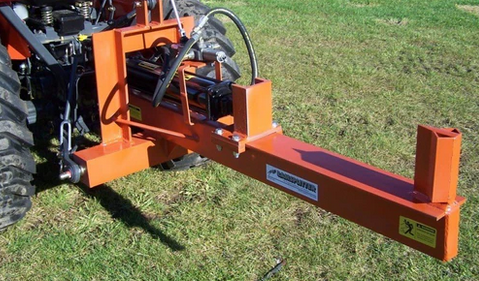

Same size tank but rated st 16 tons. Never believed the Champion rating at 27 tons.
/ Log splitters #82
It's pretty easy to verify rating, if you know cylinder bore size and system pressure. 27-28 tons would be standard force for a 4.5" cylinder on a 3500 psi system. There is no such thing as "force loss" in a static system, which a log splitter might as well be when the pump kicks down into low gear.
As to ISO weights, I'm surprised anyone is still even running old single-weight oil in any log splitter. Use ATF, and it will really make your cold starts much, much easier. It's been decades since I've seen any log splitter manual that doesn't list ATF as either an acceptable substitution, or even flat-out recommended, for cold weather applications.
Specs for the Champion Model #100424 27 ton splitter list a 3.9" cylinder. To get 27 tons, this would require running a system pressure of 4520 PSI. The MAX pressure for their system is listed at 4100 PSI. If run at this Max pressure, it should be doing right about 24.5 tons. I've asked the manufacturer for their RECOMMENDED system pressure setting, but have not heard back yet.
Champion also makes another splitter rated at 27 tons (their model #201312). It has a 4.8" cylinder and a slightly larger pump (14 GPM vs 11 GPM). I have an easier time believing that this one actually makes 27 Tons, since it would only need 3000 PSI to get there. The cycle time is slower: 16 sec vs 11 sec for the model 100424.
Agreed. Your math is sound.
Odd hearing of a 3.9 inch cylinder, but I'd guess this is probably a common metric size, 100mm?
But I'll re-iterate my point made earlier, that anything over 22 tons is wasted, for most firewood splitters. If you encounter a round that cannot be split with 22 tons, you should've left that thing in the woods!
