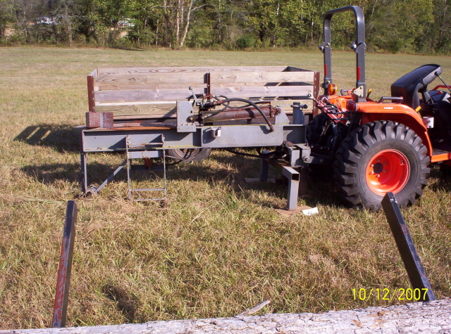

Had the same issue. I stayed with the smaller hold downs and reinforced the center of the beam. 3/8 x 8" in my case. Then out front I did gussets. Mine had room for 2 = 1/4" thick gussets on each side 1" apart. They can be made as tall as your beam but can reach back or angled on the top how ever far you can get clearance.. Its an easy fun and effective fix. Box in the front too. I've welded my wedge back on many times, Often requiring Torch and Plasma. That hasn't seemed to cause any brittle/ductile issues in my I beam so far. I guess you can alter the pressure on your valve to make it less powerful. Good Luck...

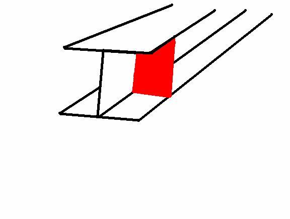

Another way to beef a beam up is to weld in stiffeners. Cut a plate that will slide in between the flanges. Weld the stiffeners to both flanges and the web. Really don't see how this would work on a log splitter though!:confused3:
Will not work, the pusher plate has plates that slide under the top to keep it on track and safety.

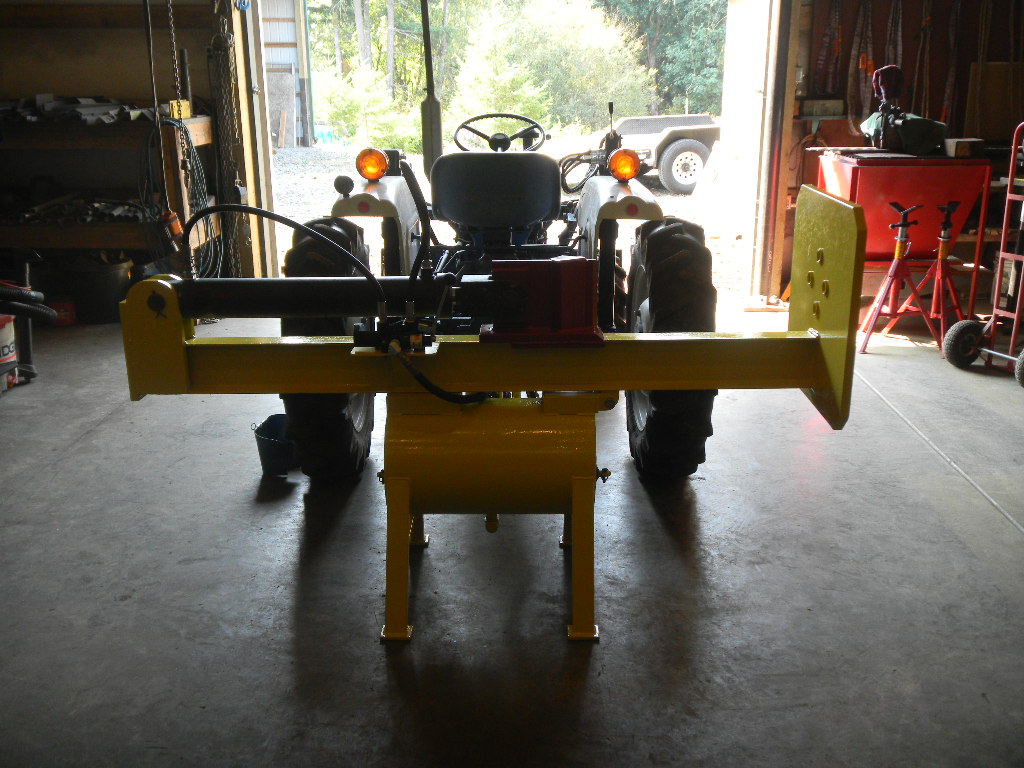

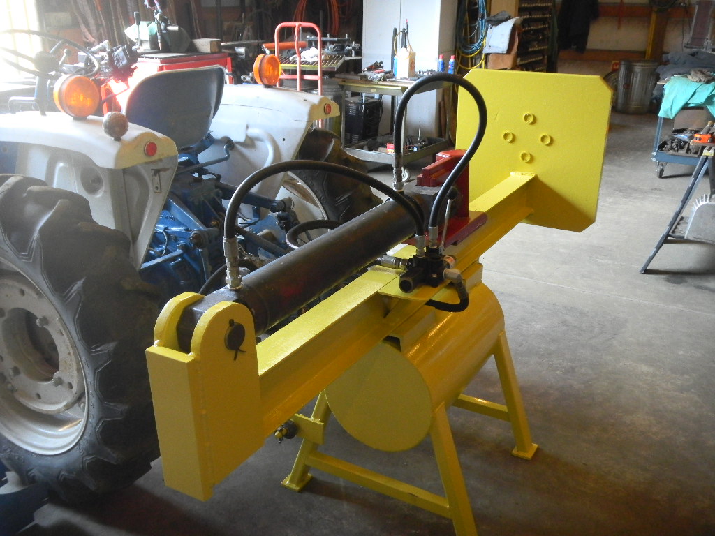

I thought I was going have to do that to a log splitter I built for my brother-n-law. But he has been splitting oak for a couple years now.
Built this out of my scrap pile, just had to buy a few hoses.

Look at how I had to mount the cyl. to the pusher plate, that stopped mine from digging into the I beam.

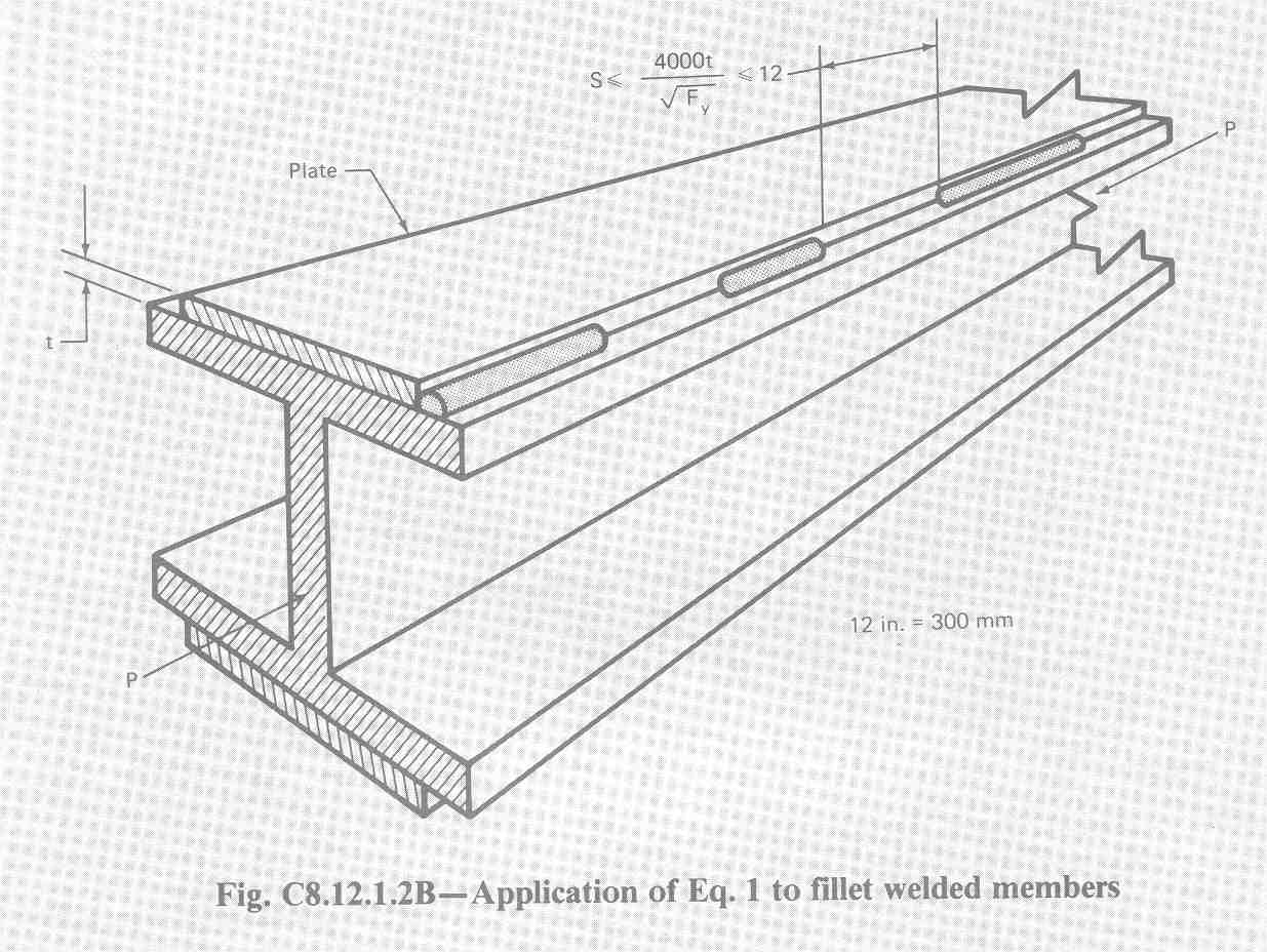

The subject of strengthen beams always interest me, I've worked with a few beams in my time.:D
I've seen this detail before for strengthen Bar Joists, but found this detail for strengthen a beam. I don't know how much strength it would add, but I wonder if you added doubler plates to both sides of the web, cut some holes in the center of the doubler plates so you can plug weld them to the web. Skip weld the doubler plates to both top, and bottom flange. Then add the round stock to the bottom of the top flange?:confused3:
