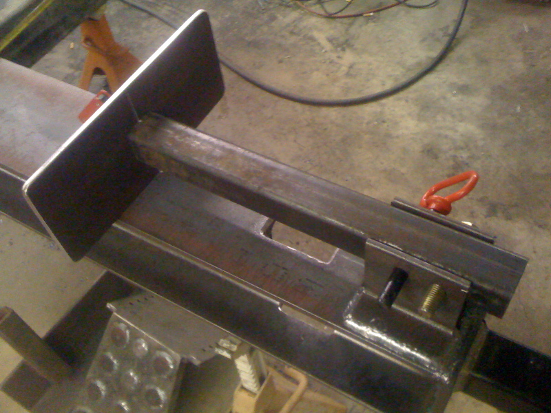

Taking LD1's concerns to heart, I did a little upgrade to the main gusset on the pusher block, welding in another section of 3/4" plate to make it taller:
Still have to weld on the two addition gussets that are intended to help keep the pusher block straight, side to side, on the H-Beam.
