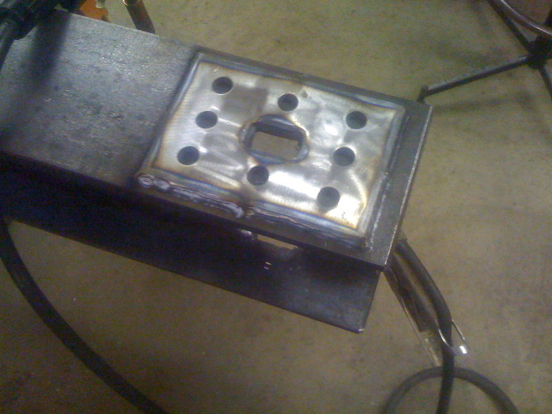

Here's a photo of some purty-fication work I did a while back to clean up the welds on the end of the cross member/reservoir tube ... so far so good (it hasn't started to leak yet ... :D)

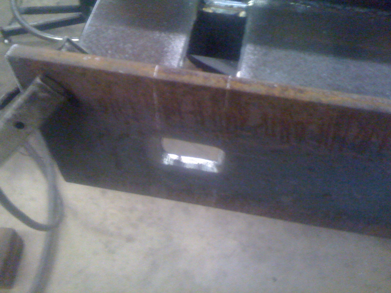

This is the one side of the wedge after gouging it with the o/a torch and then trying to clean it up a bit with just a regular type 27 grinding disc ... which was very slow going. That's the new snagging wheel on the grinder:
/ Logsplitter 2.0
#134
This is the other side of the wedge after my initial attempt at gouging it with the torch:
And after a little more work to remove some more material:
/ Logsplitter 2.0
#135
Same side after roughing it in with the snagging wheel ... might be a place or two that I have to fill in with weld if the final finishing operations don't remove all the gouges:
/ Logsplitter 2.0
#136
Definitely getting closer to being a splitting wedge ... the edge is down to around 1/4" wide ... so I still have a bit to go :D:

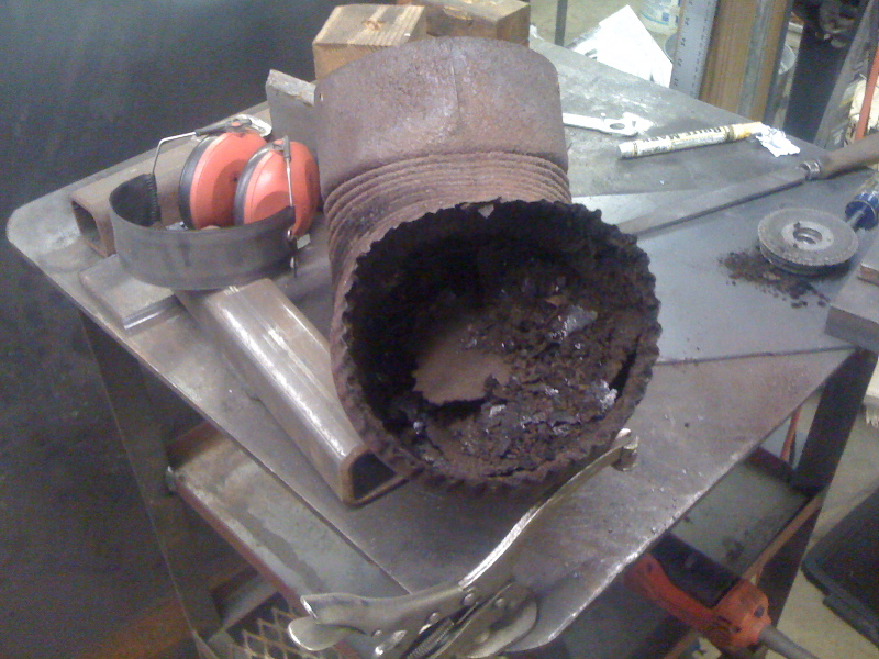

Compared to a 40 grit flap wheel, it would be like trying to load a tandem axle dump truck with one of these:
versus this:
That was a lot of grinding ...
It was pretty surprising how quickly it actually went ...
is there much left of the snagging wheel?
The snagging wheel essentially still looks brand new ... ;)
