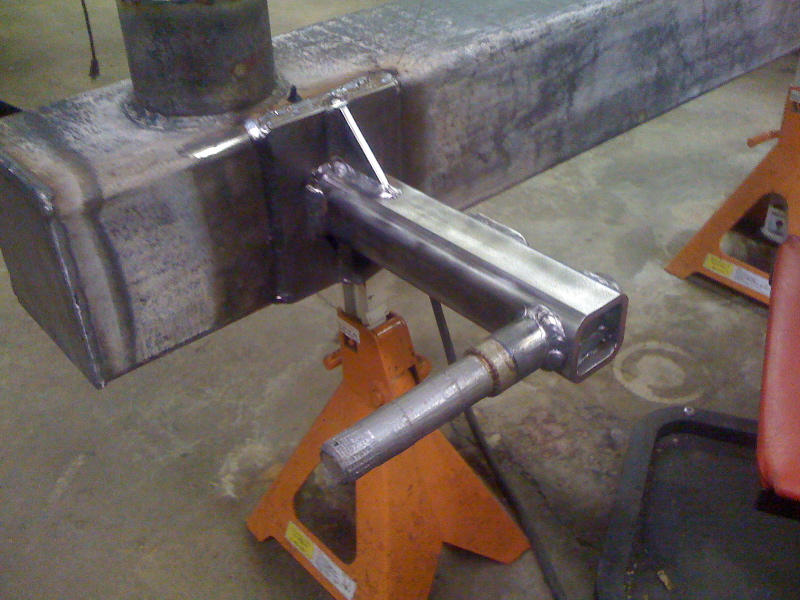

Didn't make any progress yesterday ... just too much screwin' around with keeping the home fire going and fixing the 'bota ... but I did manage to get these welded up night before last ... they are the lower arms that the table grate mounts to.
IIRC, they are 1 1/4" Schedule 40 pipe, about 30" or so long ... welded to some 1/2" x 1 1/2" flat stock:

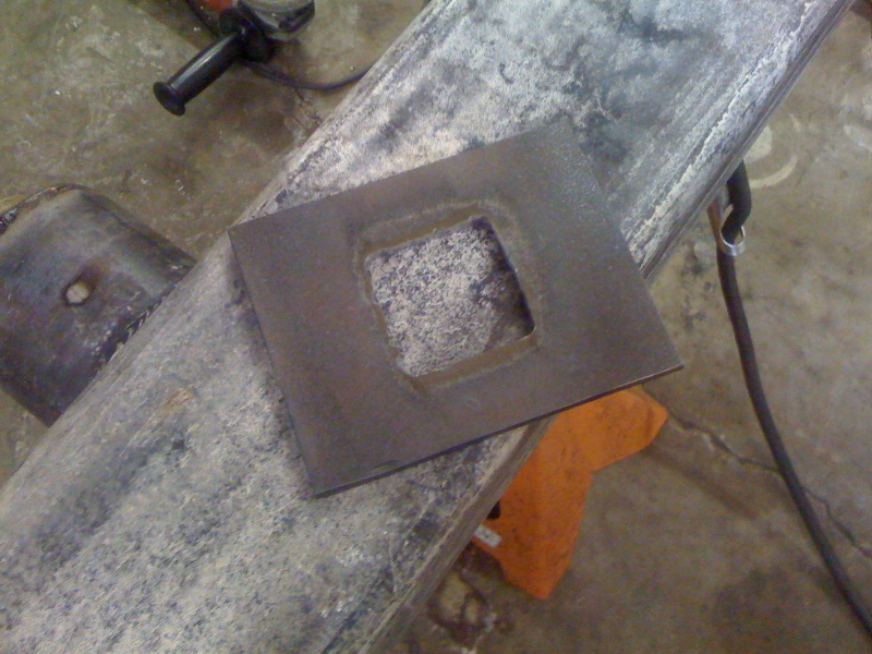

#185
They bolt to a pair of plates (one pictured) that will be welded to the H-Beam on either side of the splitting wedge. This will allow the table grate to fold up and out of the way for transport. A piece of 1" solid round cold roll welded in the plate provides a rest or stop for them to sit on when in the lowered position:

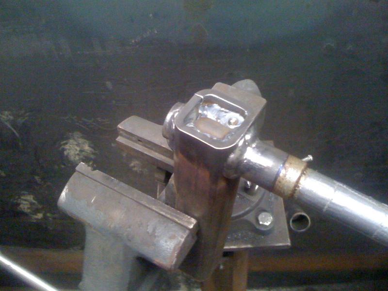

#186
Hinge pins for the log lift:
These were made using some 5/8" hot roll solid rod and a couple of slugs that came from drilling holes in 1/4" plate using a hole saw. Had my friend Mike chuck two of the rods in his lathe and turn down the rod so that it fit inside the center hole in the slug, after which I welded them together.
Then I cut two more 4" lengths of 5/8" rod and welded those on to act as handles. The pins still need drilled for the hitch pin retaining clips.

Frame for the log lift largely completed. Still have to do a little clean up grinding (probably won't happen until I take the splitter apart to paint it this summer), cut some sheet metal to cover the two open panels and weld those on, and weld on the attachment points for the hydraulic cylinder:
Pivot points for the log lift:
