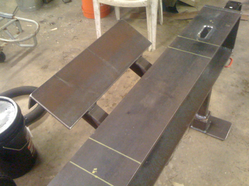

Looks good with the back side capped.
Thanks
How tall is the wedge?
It's only 10" tall - would have preferred something a little taller, but 10" was what I had on hand.
Just got done cutting the old slip-on 4-way wedge apart ... gonna rebuild that tonight to fit.

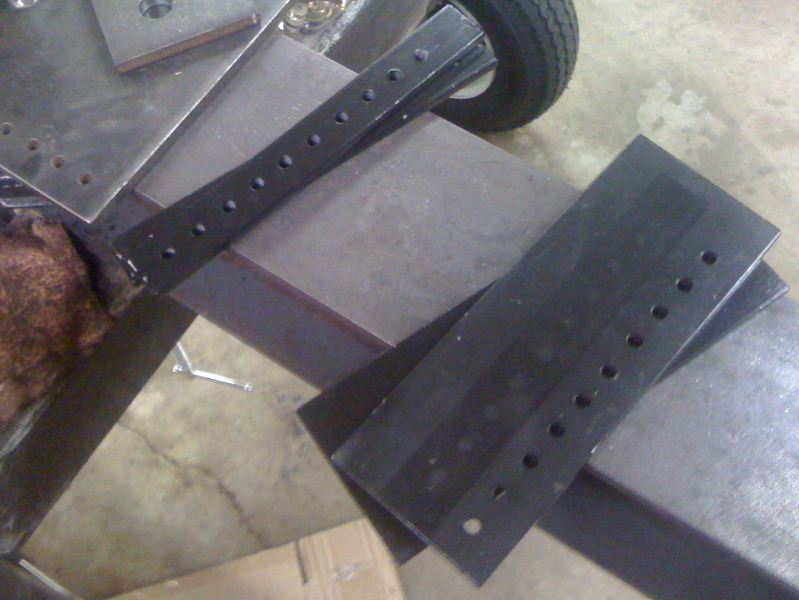

Old four-way wedge cut apart:
This took around an hour to do (at least), using 7" zip discs in my angle grinder. Used the air outlets of the welder to cool the grinder periodically ... :D

Originally I was just going to cut the plate that the wedge wings were attached to and flip them so that they followed the (overhead) profile of the fixed wedge ... but the plate was only 1/4" ... and I decided it would probably be better to use something a little heavier.
The only thing I really had available was the last remaining scraps of the H-Beam flange (3/8" thick):

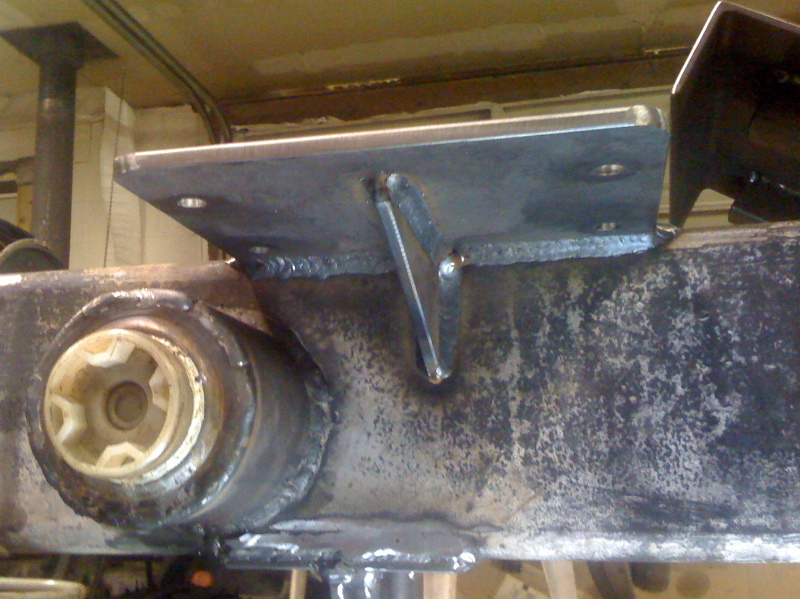

As the above photo in the previous post shows, two of the pieces were a little short of material ... so I added some and filled in the gap:

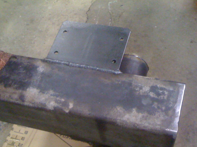

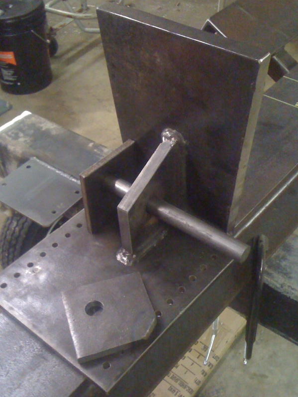

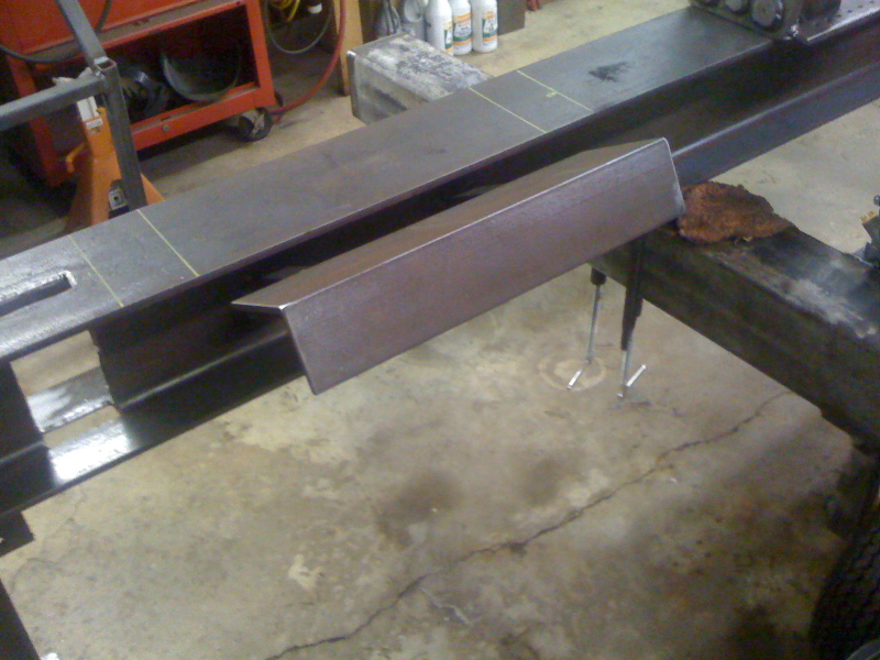

While taking a break from working on the side plates for the new 4-way wedge, I decided to fab up a little addition for the fixed wedge.
Took a piece of 1/2" (thick) scrap that was 2" or so tall and 1 1/2" long (when standing) and used the snagging wheel in the angle grinder to give it a rough edge ... and then used the Delta Sharpening Center to put a fine edge on it making a "foot" for the wedge:
This reduces the log length capacity (at the top of the beam) to 24 1/2".

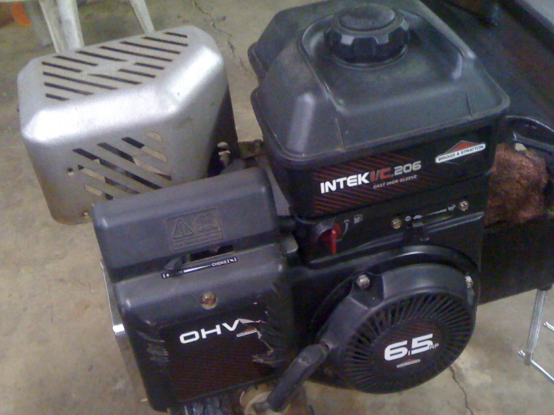

Cycle times in low pressure/high flow were: 5 and change extend, 4 and change in retract.
Two hydraulic leaks - one on 90 elbow on the outlet of the Prince LS 3040 valve that controls the big cylinder and another on a swivel fitting on the inlet. Threw some Permatex No.2 on the outlet fitting ... seems to be holding. Tried tightening the inlet fitting ... haven't tried it yet tho' ...

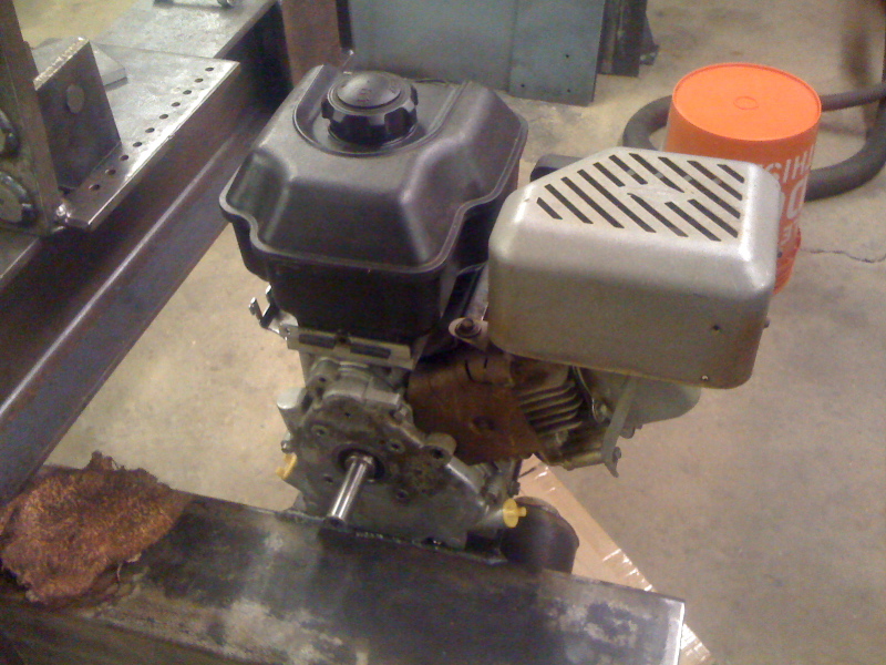

Also have an oil leak on the valve cover of the Briggs ... will try to score a gasket for that today.
Misplaced one of the hex set screws for the Lovejoy coupling ... I made one out of a 5/16 bolt by cutting the head off and then slotting it ... just so I could test it last night ... so I'll need to pick up one of those as well.
Have some relief valve and/or 2 stage unloader issues as well, that I need to sort out ... stalled the engine a few times.
... but I'm liking it already ... :D

On the engine stalling issue, it happens under two scenarios - and both have the system pressure shooting up to around 1500 psi:
1. Using the RD 5200 valve for the log lift, unless one is careful feathering it, it will kill the engine. I'm running 1/4 hoses to the log lift cylinder ... in order to keep the cylinder extension speed to something reasonable ... and trying to shove 13 gpm thru 1/4 hoses don't seem to be working too well. Probably help if I would get the log lift itself actually installed, so that the cylinder is actually pushing something.
2. Deadheading the main cylinder for the push block with the LS 3040 valve.
I'm thinking it's likely a combo deal with both of the pressure reliefs on the control valves (the reliefs are supposed to be set at 2250 and 2000 psi respectively) and the unloader valve on the pump that controls where the pump switches over to high pressure/low volume mode.
The engine itself now seems to be running better (full rpm) after a little run time (it sat for 10+ years)

Definitely sounds like a pump issue. If you are only getting to 1500 psi, the reliefs wouldn't be opening anyway. And obviously 1500 psi on the high flow mode on the pump is too much for 6.5 hp.
Right - good point.
Yup - about double too much.
I pulled the top bolt/cap next to the outlet on the pump last night - there was a spring sitting on top of ball there. Didn't really do anything with it ... just had a look.
There's a cap on the bottom side of the pump next to the inlet ... I think that's where the adjustment screw for the unloader is. I'll pull that tonight and see if I can tweak it down (out) to lower the point where it shifts in low volume/high pressure.
Got the gasket pulled on the valve cover and cleaned up both sides and replaced it with some black NAPA RTV Ultra. Also discovered that the pipe the muffler screws into was actually loose in the head ... so I'll need to handle that as well.
