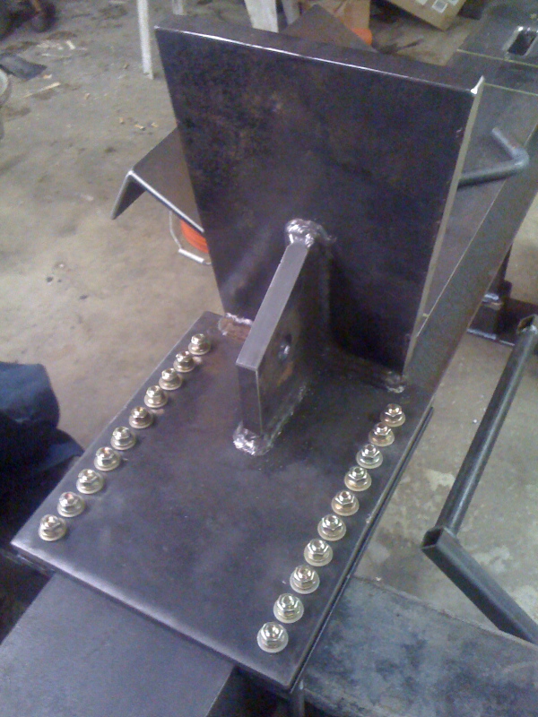

Bracket for the cylinder attachment point on the log lift (made from 1" c.r. solid square), and the attachment point itself (made from a piece of 3/4" h.r. plate):

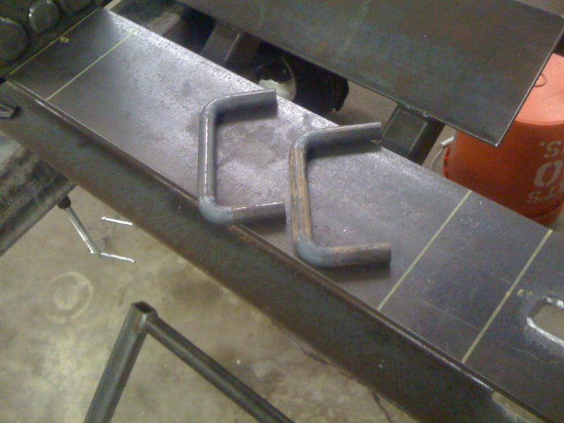

Log lift cylinder and hose routing:

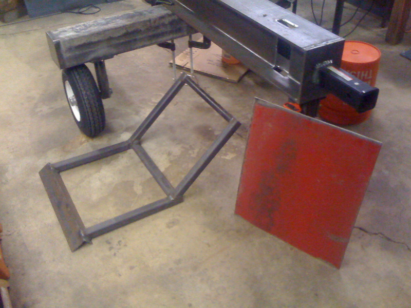

The remaining panels welded on the lift, and lift attached to the splitter:
/ Logsplitter 2.0
#227
And operational:
It may need a restriction orifice fitting placed in line to slow it down a little :D

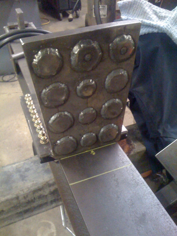

Still had an oil leak on the valve cover even after the RTV ... so I did what I should have done in the first place: got out some old rubber/cork gasket material and made a new gasket:
Fixed another hydraulic leak that showed up between the two control valves, and handled the Lovejoy coupling on the pump side ... which wanted to slide back on the shaft towards pump.
Also tweaked the unloader to drop the pump into low volume/high pressure mode at a lower pressure ... so no more stalling. Probably need to play with that a little more.
Engine seems to be running good at WOT ... but I still need to handle whatever is keeping it from running at lower speeds.
Probably will pick up a restriction fitting at TSC tomorrow, to slow the log lift down some ...

Here's a couple of items that, in hindsight, I would do a little differently:
1. Log lift hinge.
I used 5/8" hot roll solid round for the pins ... seems a little undersized to me now. Probably would have been better to use 3/4" or 1" pins and used some bosses on the brackets (which are 3/8" thick) or on the log lift frame tubes. The hinge and pins aren't really greasable at this point ... and I suspect they will probably wear pretty quick.
Another thing is the actual location of the log lift itself when it's raised - it's high and close enough to the beam that the push block will hit it if the push block cylinder is extended while the log lift is up. In fact, I've already managed to do that ... fortunately I was at least paying enough attention to stop it ... otherwise I would ripped the brackets completely off the beam. I could handle this pretty easily by trimming about an inch or so off the top of the log lift frame.
2. Fold-up table grate. By choosing to locate the bolts, which the table grate pivots on, at the very end of the table (nearest the splitter beam), the table grate cannot be folded up all the way when the log lift is in it's raised position. This could have been avoided by relocating the bolts which provide the pivot, a few inches further out towards the end of the beam.

/ Logsplitter 2.0 #234
I think you will end up wanting to re do the log lift hinges. Either before or after someone accidentally tears them off;)
On my last splitter I used pillow blocks.... This time I used pipe over round stock. There is to much play in them to make it worthwhile to even grease them. In practice the lift gets relatively little use so I think they shouldn't wear too fast. Hopefully I have a lathe to make replacements by the time they wear out

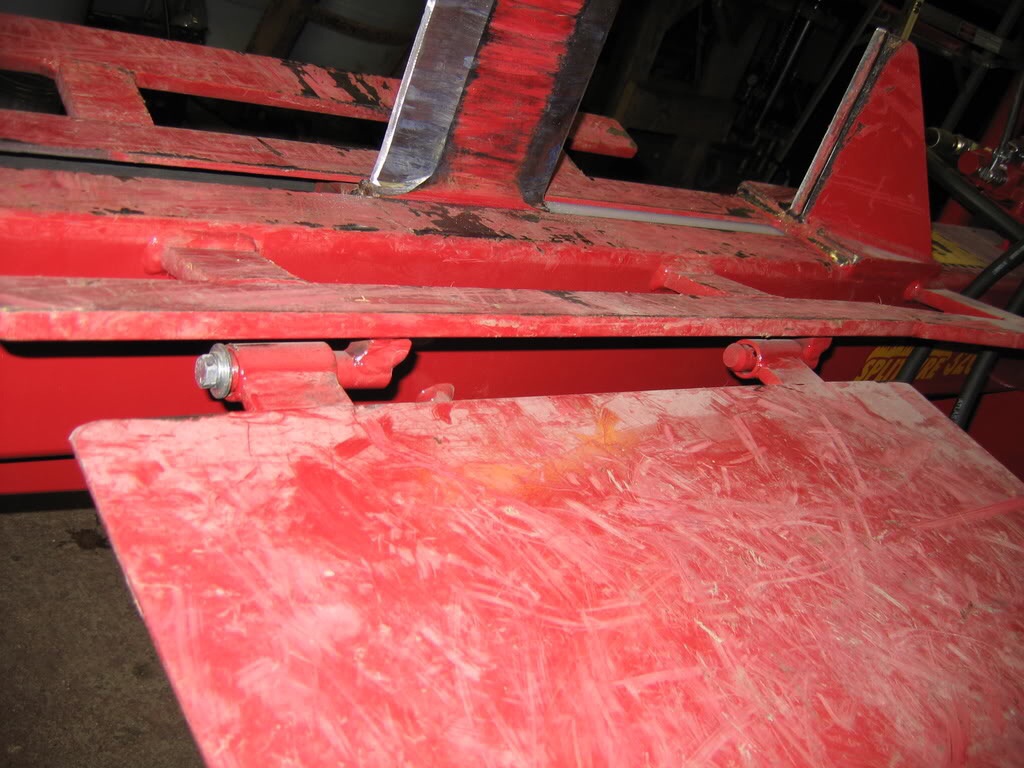

Here's the split fire design that I borrowed. I don't think they have fittings... The hinge looks to have a lot of play. image.jpg
Like it - nice and simple ... plus it allows for having a cradle/support on both sides and not just one (something I can already see the benefit of)
