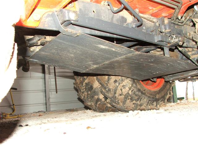

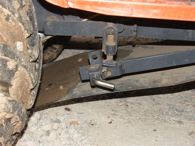

Here's on I made from some pieces of metal I had laying around, this goes on when the MMM is off and don't have an air flow problem.

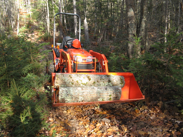

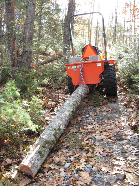

10 cords is quite a lot of wood so you may want the winch, especially if you can't get into where you have cut the log because of ground clearance issues with the BX. I cut 3 to 4 cords and haul it out with my B2620. Sometimes I haul 4 foot or 16 inch pieces with my forks or bucket if i can't get to the tree and maybe drag one log behind me with my three point hitch. Here's my simple setup. no winch.
You may only be able to pull smaller logs with the winch because of the light weight of your tractor. I would ask the dealer about that if you don't get a response on here. A guy at my dealer told me the winches don't work that well with the smaller tractors, something to check out.
In the pictures that's a pretty steep hill I am coming up and that small wet log weighs quite a bit so the small tractors are pretty tough. It can pull a lot more weight than that even with the loader full.
