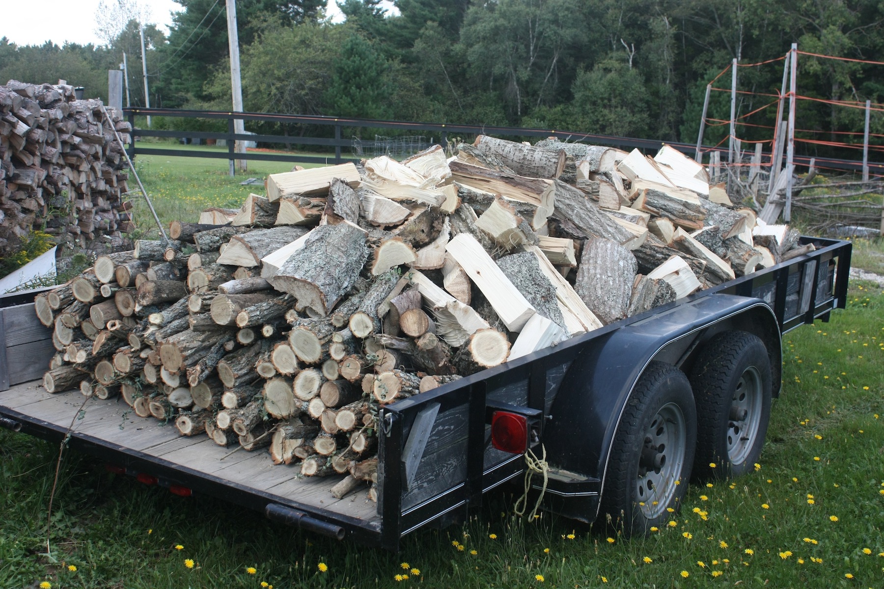

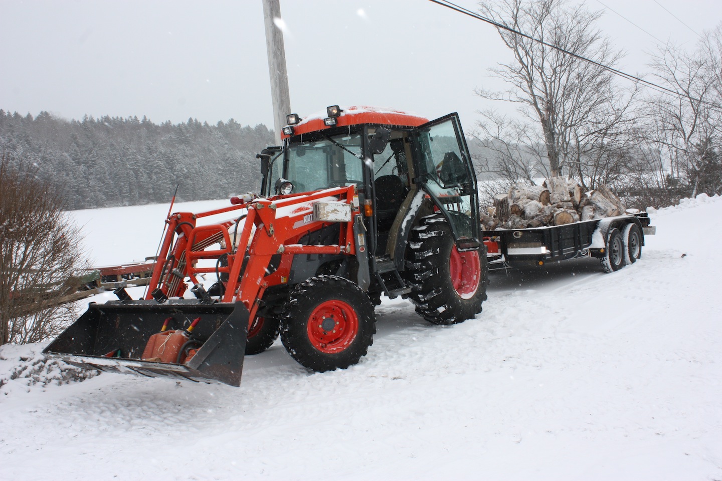

I often take my 14' landscape trailer with me when collecting fire wood. The problem has been that the winch just clears the trailer tongue when 3pt in at it's highest point - not sure if this is good for the 3 pt. Also depending on terrain the trailer tongue has caught the bottom of the winch... The tractor came with a solid tang that I put a 2" ball on - this inserts into the tractor frame - works great without the winch. My question is could/should I install a receiver on the winch to take a ball? Will this put too much strain on the 3pt? Or, should I built a ball hitch that connects to the tractor frame and extends beyond the winch for hook up to the trailer? The ball hitch extension will have to drop to accommodate clearance of the winch bottom - it may drop the trailer tongue too low to the ground. I'm off to do some woods work but will check later today for info... thanks.

I don't think anyone's missing anything. I think the original post should have read 8000 lbs, not 8 tons. There's no two cords of wood that weighs 16000 lbs. Back to the question at hand, though. I think adding a ball hitch to the winch is a good idea. I see it all the time. Some I have seen pin into the bracket for the lower block on the winch. I guess you have to switch them out when you need one or the other, but it would be an easy way to get one on there. I don't think the weight will be an issue, except that since it's further back from you axle, it will put more force on the back and might make your front end light. Probably not an issue, but something to pay attention to. if you load your 8000 lbs of wood on your trailer with 10% of the weight on the tongue, that is looking like 800-1000 lbs on the hitch, which should not be a problem at all. If you're going to weld a hitch receiver on the winch, weld on on the top of the bucket at the same time. If you want more info on the topic check out forestryforum.com, lots of info on this topic over there.

Most of the hardwood I get is red oak, with some birch and poplar thrown in. I clean up fallen trees and or remove trees for selected neighbours. They get a clean site plus trees removed... I get fire wood. I looked at the winch this morning and I think I will bolt on the receiver. I have one from another project - 2" receiver pipe welded to large angle iron bracket with four bolt holes.
The attached pic shows a typical load more or less. This was a load of locus and poplar but I have placed more on the trailer just depends on the distance I have to travel. I have two sites I am working on this week. One site will be mostly hard wood / cherry and oak with a large pine thrown in. The other site will be very large poplars. Probably about three good size trailer loads. I know poplar doesn't give alot of heat or burn long but my attitude is everything burns... just depends on how many trips you want to make to the stove.
To counter the light front end I could always bring home a load in the bucket as well. I do have three 2' receivers on the top of my bucket as well. Always handy.

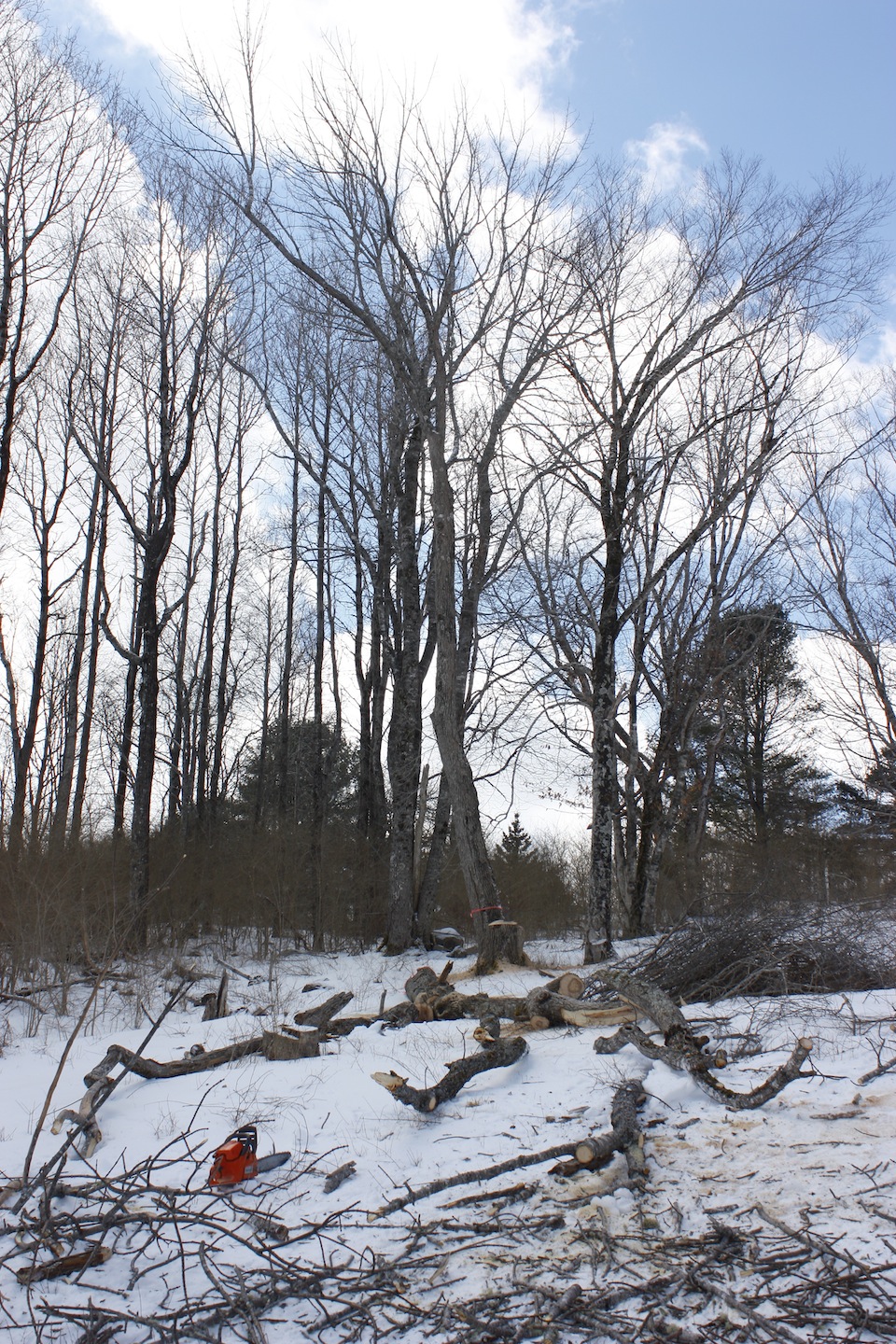

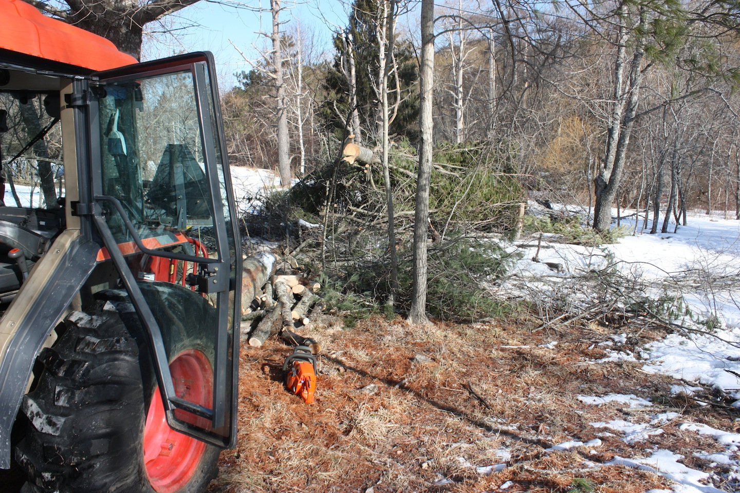

The pics show the clean up in progress. The large pine came down across a power line. The utility fixed the line but made a mess... I will be hauling out a good trailer load tomorrow plus a bit more once the snow goes and the frozen limbs are free.

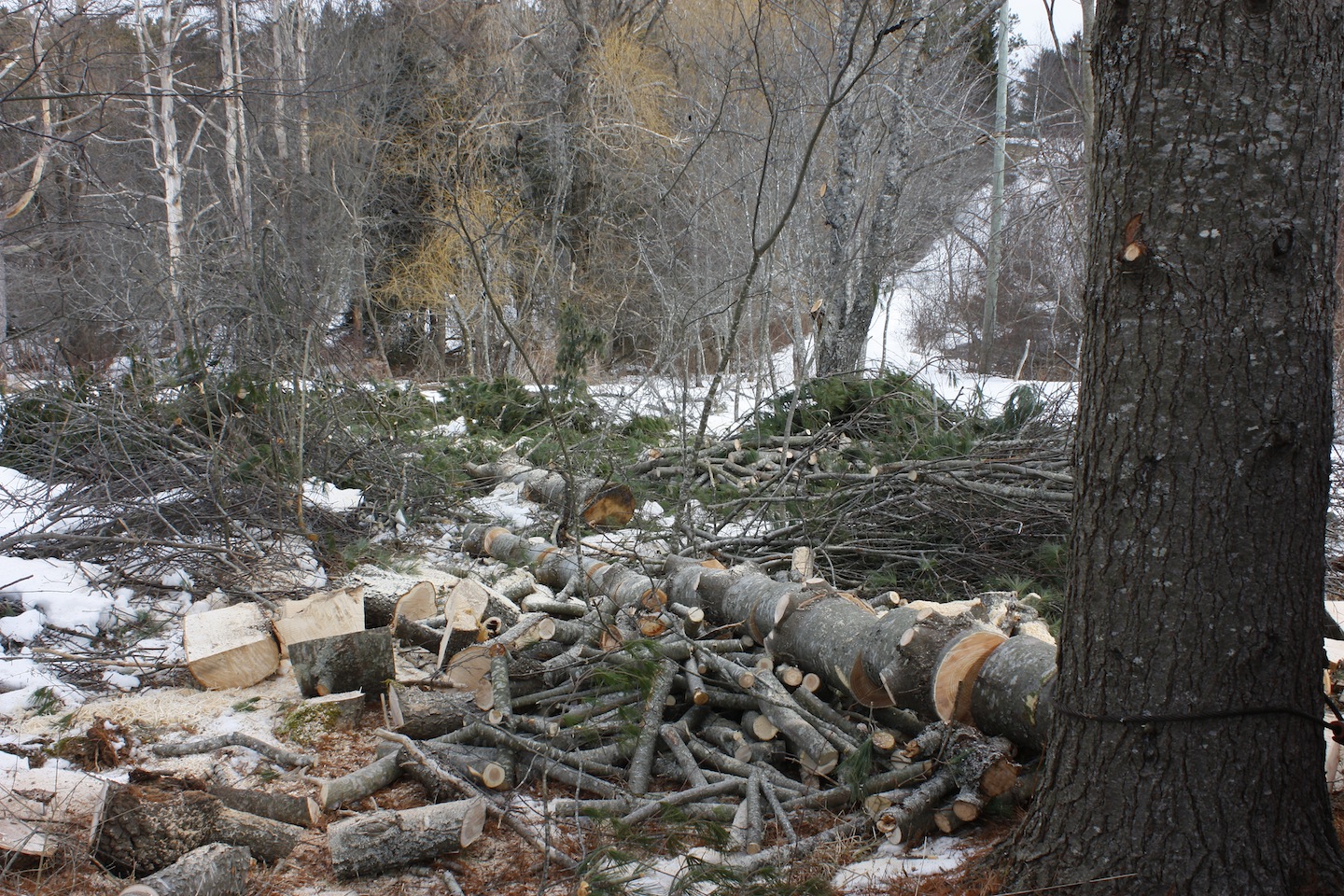

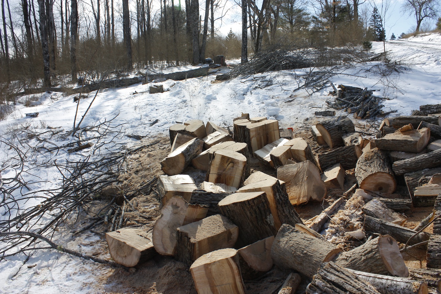

Dropped more trees yesterday. Have another six to do over the next few days. To give you a sense of scale, the stump you see in pic 2&3(see survey tape) is mid-chest on me. I saw the large chunks and split with a wedge... this gets them small enough to lift onto the trailer - still big chunks though.

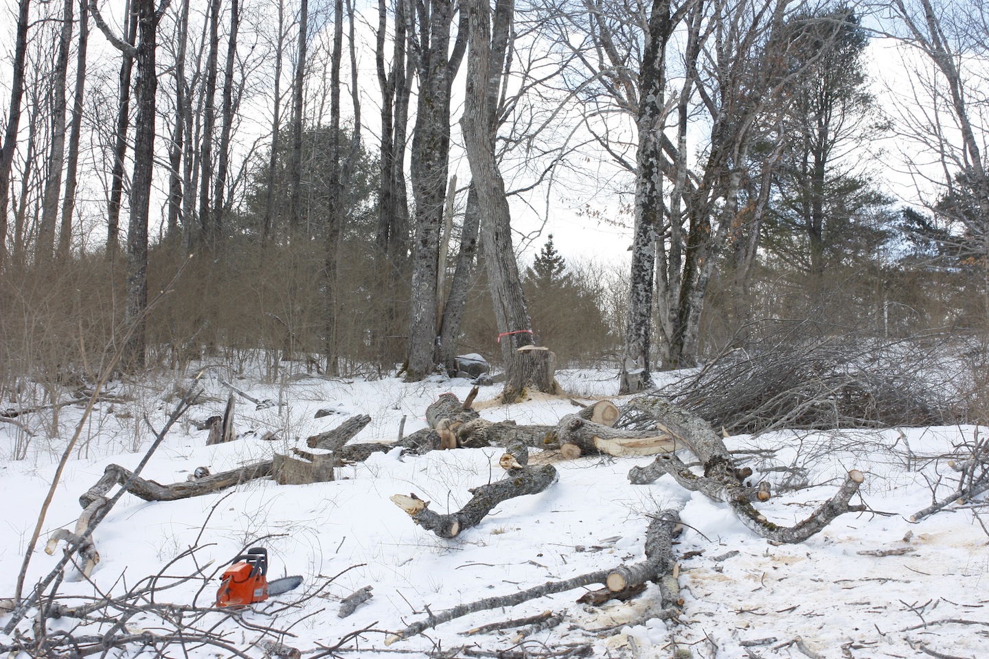

3rd load... hopefully another 3-5 more will be available. Been bloody cold up here so I haven't had a chance to bolt on receiver. Averaging just shy over a cord of wood per load.
I left the trailer at the base of driveway - no place to park trailer and the driveway is very steep. I shuttled wood via loader down the hill and dumped on trailer. I have been cutting, hauling and trailering home in the AM and splitting and stacking in the PM... kids and wife have been helping to put the wood in the shed. This will last us for the next two years. - hopefully. We have been burning more this winter - extreme cold and more snow than previous years.

Good day rbq... ya there is not a lot of wiggle room for the trailer. It sits pretty low to the ground. I may work on it this weekend. I can fine tune and adjust the winch height to help with the trailer balance a bit. Even when I tow with my truck there are certain grades/driveways I avoid with the trailer. I usually park the trailer on the road and bring the wood to the trailer.

You've got the same issue I have, Lloyd. I'd like to take the trailer with me but the winch is in the way. Funny, we have the same winch, too..
I thought about adding a receiver tube, but haven't made up my mind yet. I don't like the possibility of the trailer pushing the winch up, although it's unlikely with any tongue load at all.
