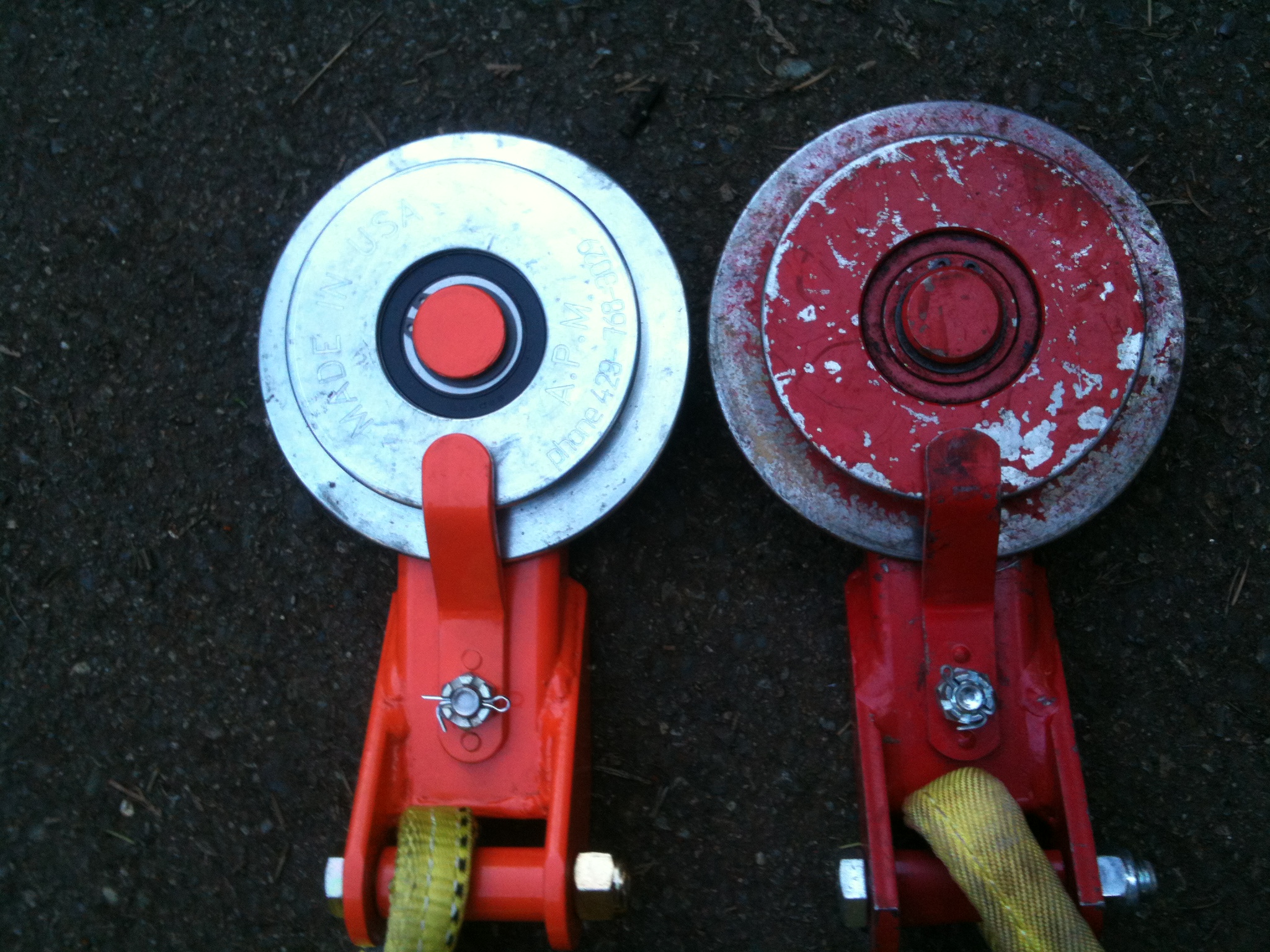

When I need to pull in some slack - either because I pulled out too much, or because my self-releasing snatch block just released and I have a bit of slack until the cable pulls taught again, I just step on the cable as I am pulling it in, using the friction under my boot to put some tension on it. I step off and get back clear as it snugs up.
