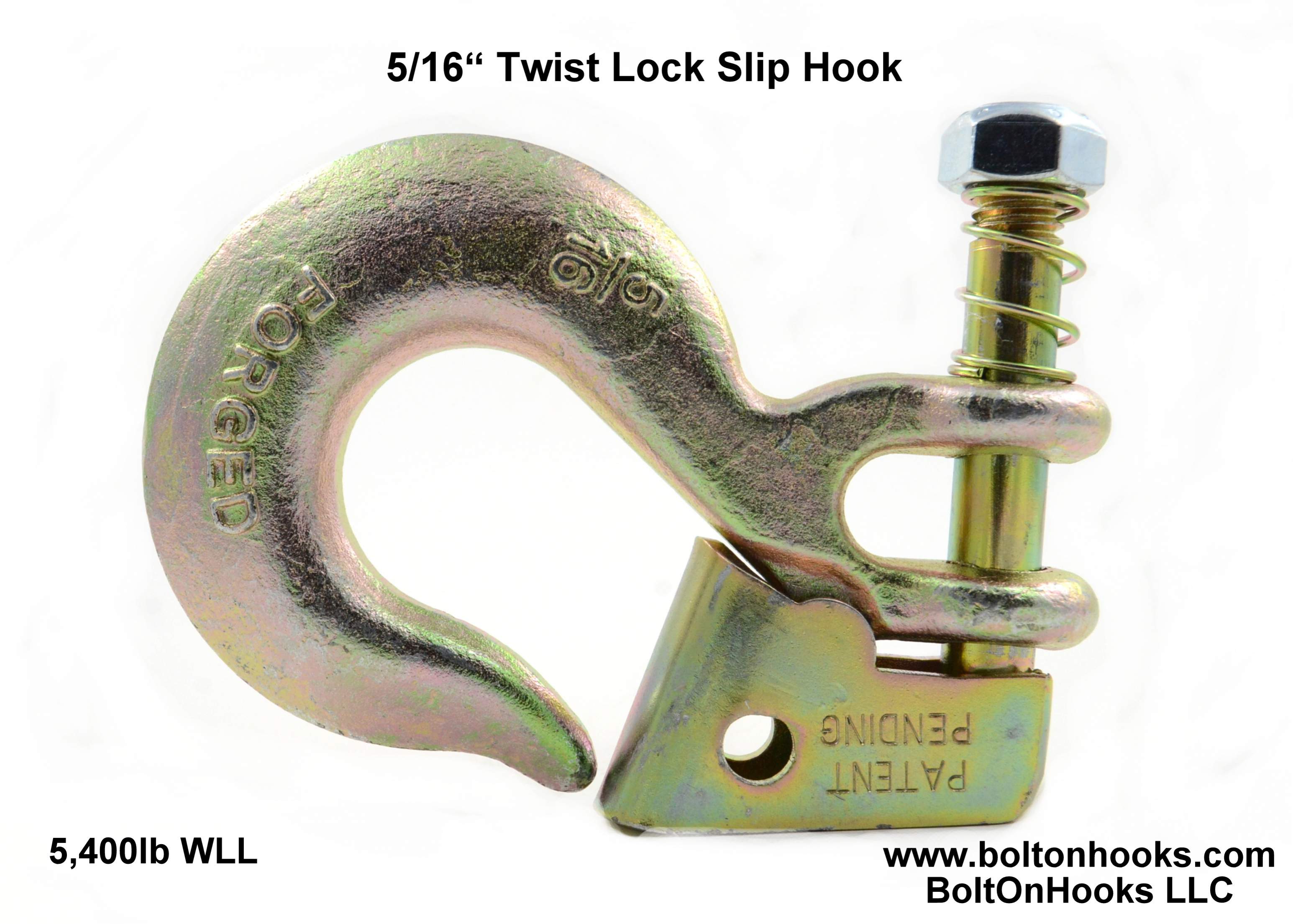

Check some of the "Twist Lock" hooks we are selling now, guaranteed not to fall off of the chain as soon as you get back on the tractor :laughing:
I agree with most the 5/16" G70 chain is perfect for this type of use.
Ken's Bolt on Grab Hooks <<Accessories>>
I have the twist lock grab hooks and would not be without them when lifting critical loads. I need to get some of the slip hooks too.
