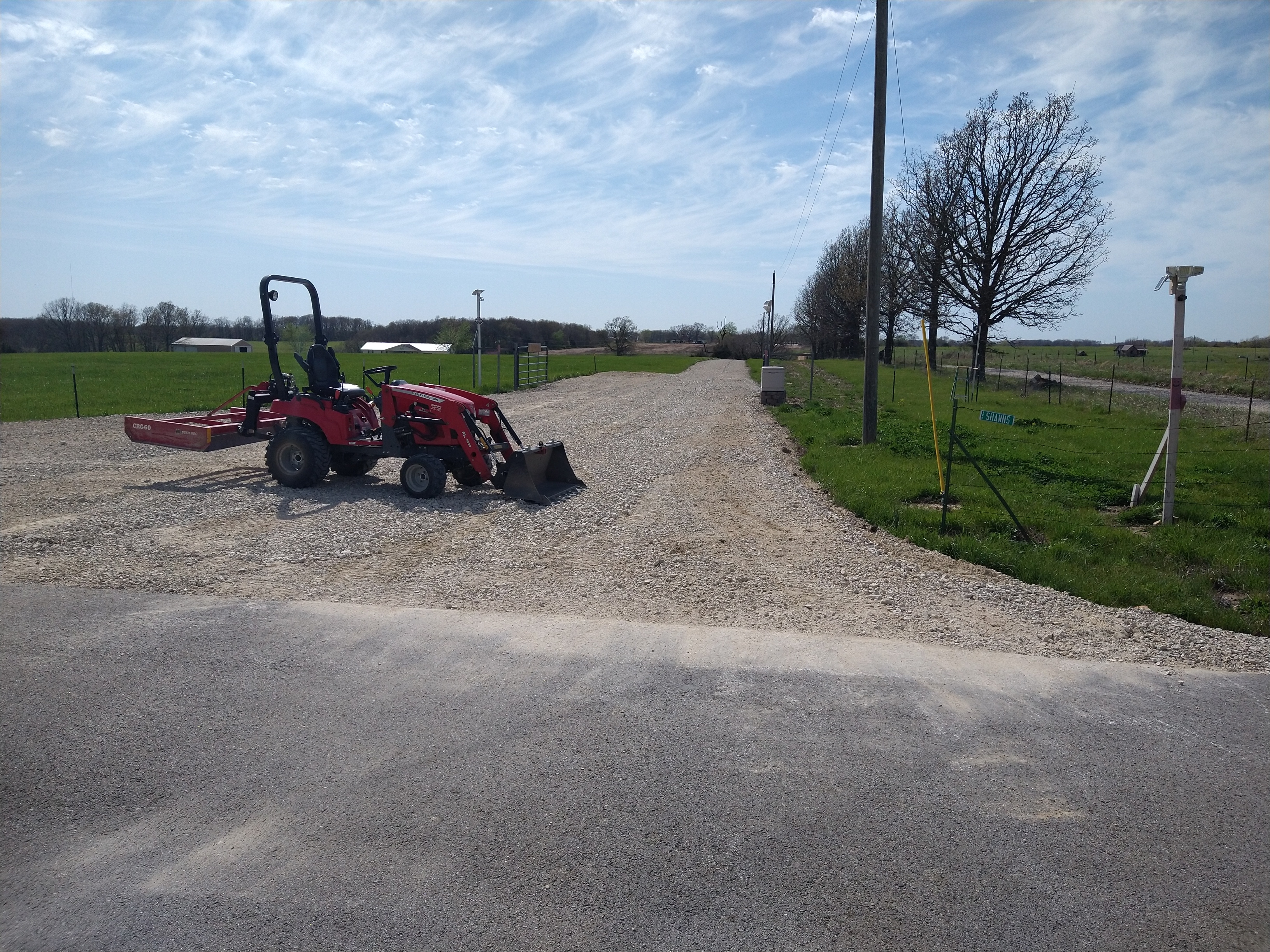

A rear blade is much different than a "grading scraper" ... Lots of times called a "land plane", Bush Hog calls mine a "road grader", the blades are fixed ... Looks like this, and is only 60" ... Which my 25 HP SCUT with tiny 26" rear tires pulls in high range without any problems ...
For a rear blade ... I'd also recommend a much wider than tire track blade ... Here is a 72" behind my 50" wide SCUT ... Not much extra sticking out!
